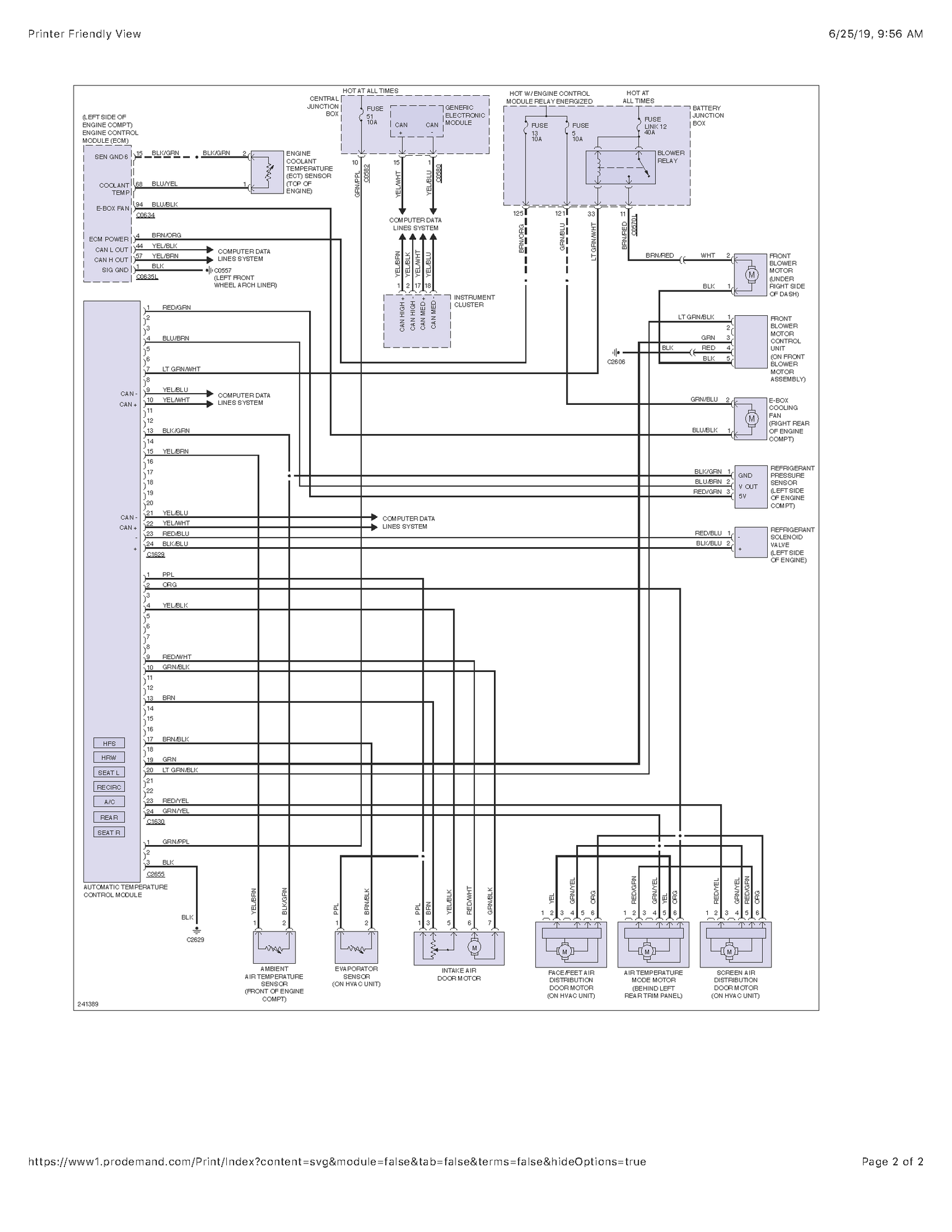

Are you sure that you are testing/diagnosing this properly? Hope that doesn’t sound off
just, do you know for a fact that there is no voltage to the climate control panel?
and if you have tested/ confirmed that with an electrical diagram, have you double checked all related fuses?

I haven’t directly checked the wires with a multimeter yet but the climat control panel doesn’t respond or light up at all. The panel itself could be bad but im not sure how to check that. Do you know where I could find a wiring diagram to refer to?

I think you missed a bad fuse.
ill try to remember to post a diagram tomorrow.
but, I’m pretty sure it’s a fuse.
Old Jun 25, 2019 | 12:02 PM

Thank you! This is a big help! From what I can tell from the diagrams, I should check fuses 12/13 (hard to read) 51, 59, and 22?

YOU WERE RIGHT! It was one of the fuses that I overlooked that was labeled for the AC. Replaced the fuse and everything works now. Thanks Abran for the help!
