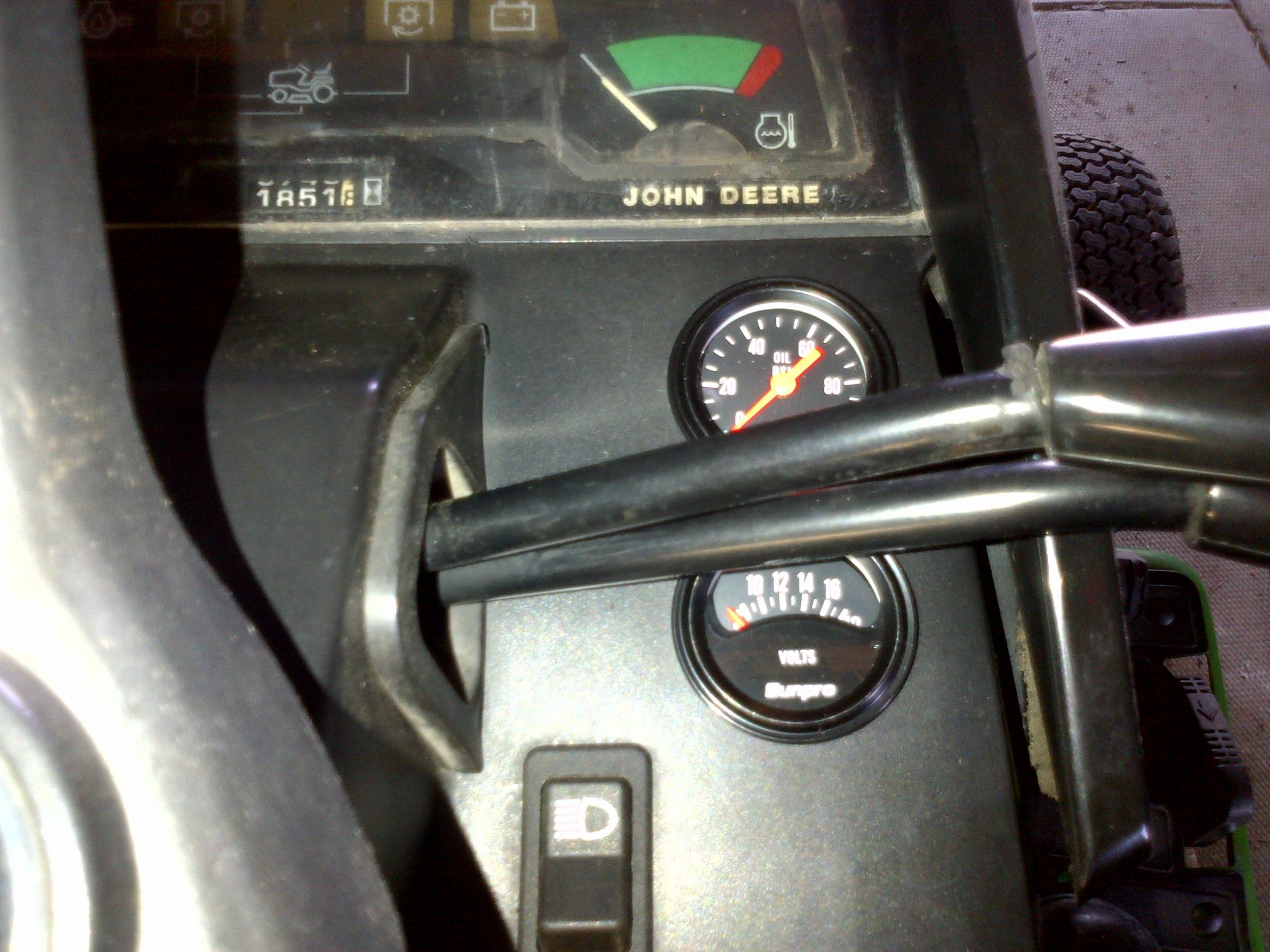

I have LED bulbs, front and back in my John Deere garden tractor and they are great. In fact the headlights even wig wag.
My tractor is only two wheel drive however and does not have a terrain control **** - but I do have a voltmeter and oil pressure gauge.
I figure the MR2 does not have the terrain **** but might have a voltmeter and an oil pressure gauge. The 3's systems were not designed to interact with LED bulbs, the 4 is - sort of.
My 1996 John Deere has no computers, so nothing is bothered by the LEDs - in fact they are welcomed, as the alternator only makes 20 amps.
The tractor also has a 5 VDC USB power socket for charging cell phones and the like, plus a 12VDC power plug.

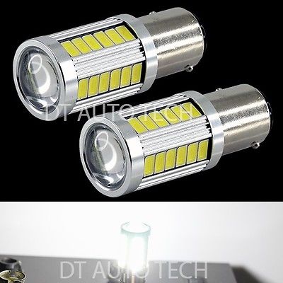

Yes, the LEDs that I installed are brighter than the stock 1156 single filament tungsten bulbs that John Deere uses for bulbs in my tractors "headlights".
As to if one can see more, that is difficult to say. What is certain is that the tractor is easier to see, at least from head on and that has some merit around the airstrip where I have the tractor based. I also put the headlights on a Wig Wag circuit for use as recognition lights.
Plowing snow in the dark is not my idea of fun so the headlights will not get much use in the winter and in the month of summer, well the sun does not really set for very long up here.
The headlights on my 425 have a silvered plastic reflective lens surface within that is supposed to focus the light from the tungsten filament. As to if the surface and shape focus the light from the LED, that is hard to say. The fact that they look bright when you look into them suggests some sort of focus action is going on however. Then there is the question of aiming. Yes, JD does have a sort of lamp aiming ability as well but that is not common on most garden tractors.
The bulbs that are shown in the first jpg below are off eBay and have a greater K colour number than I would prefer, hence there is also the question of definition - that is the ability of the eye to recognize what is illuminated.
I prefer a 4300K colour similar to our xenon HID projector headlights over the nearer 6000K colour that tends to be common in cheap LEDs such as I purchased.
