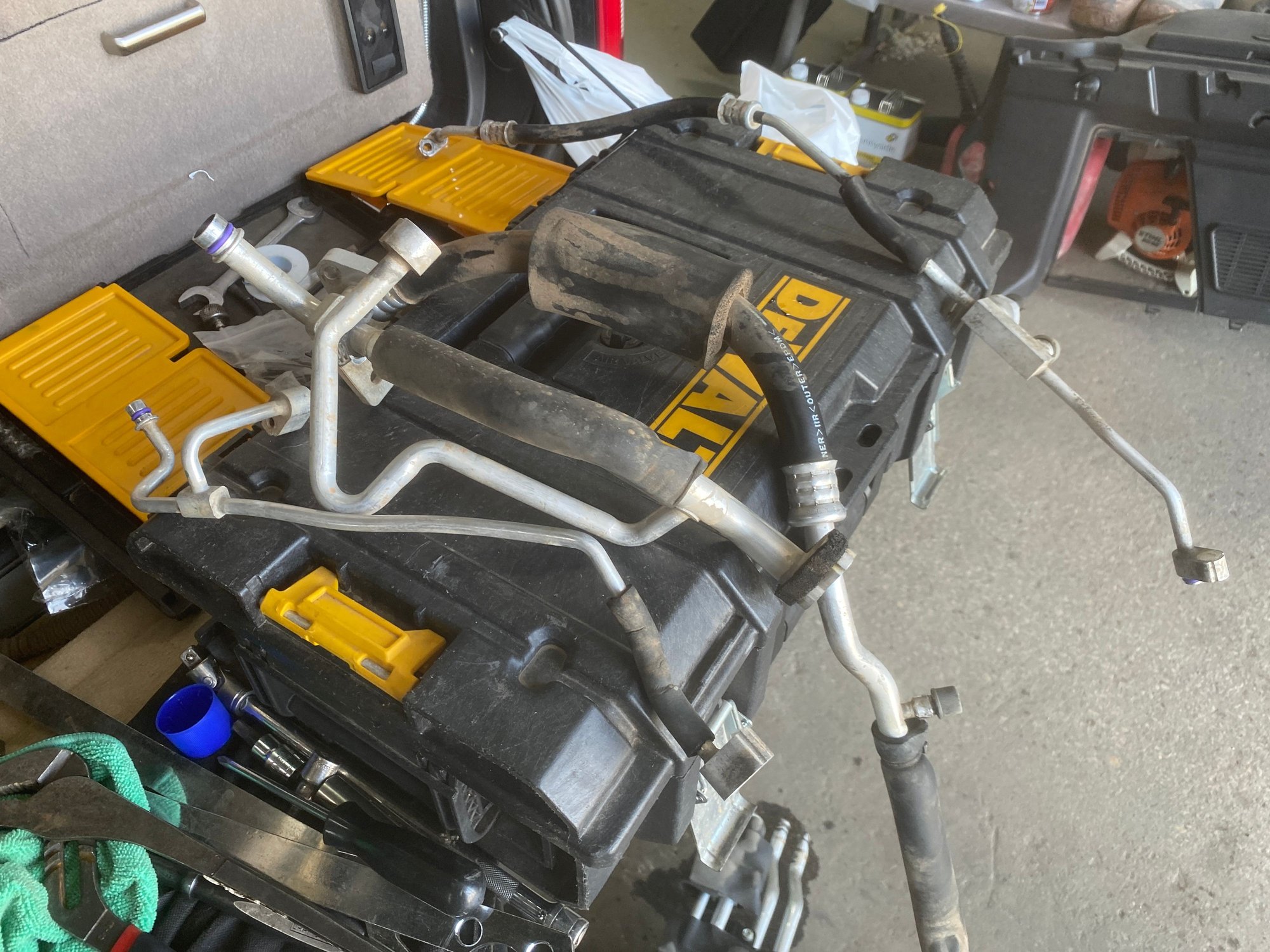

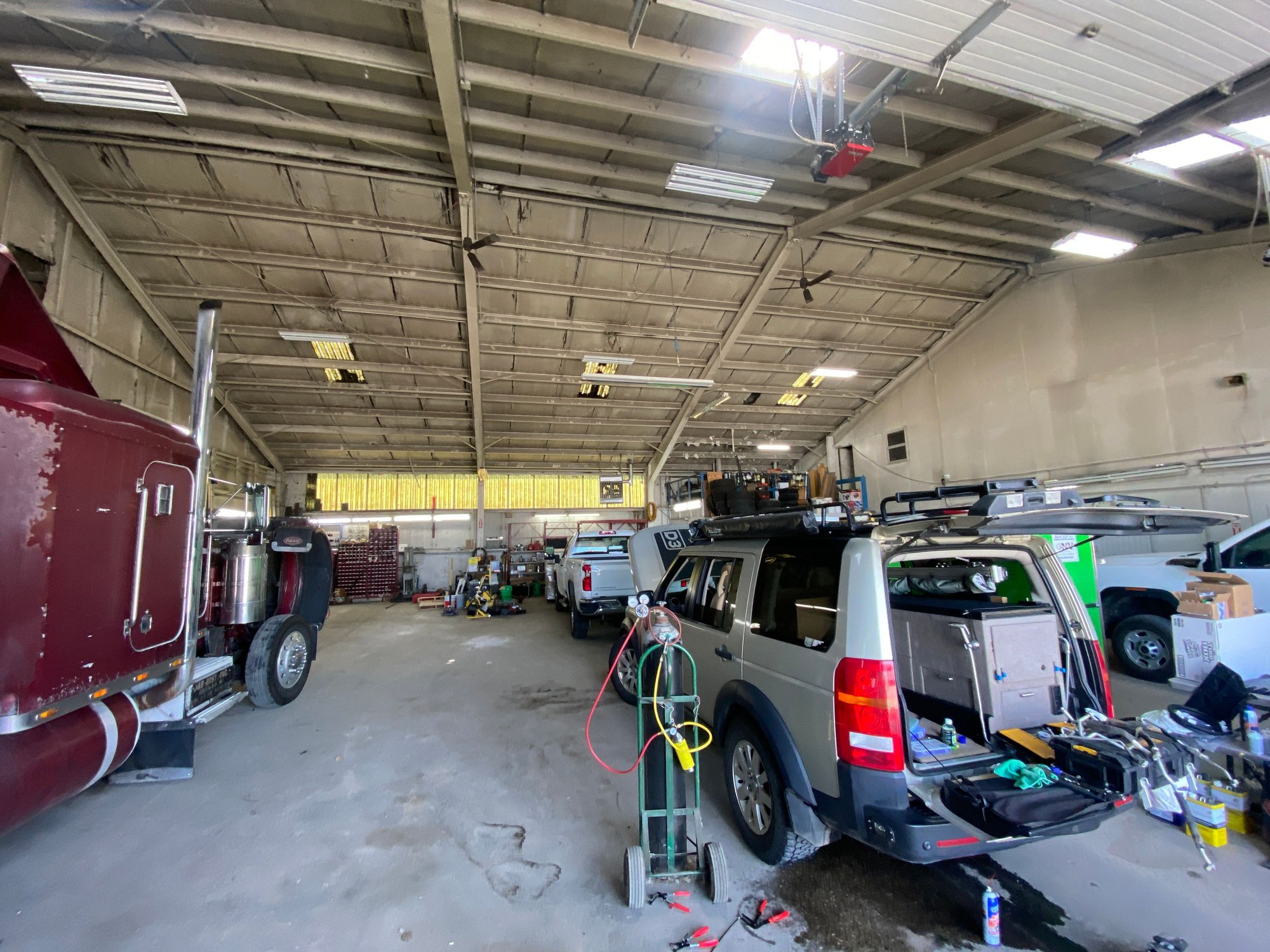

Overhauled my AC system after installing a new compressor and condenser. Also put in a new rear HVAC module with heater core and evap. The unit came form an LR4 wreck with just 16k miles which I verified. A lot of work taking out all the lines and blowing them clean out. Had nitrogen on hand and a large shop to do the final work. The shop is actually the very place where Schneider National was founded. Does not see much use anymore tho. This is a project I never, ever want to do again.

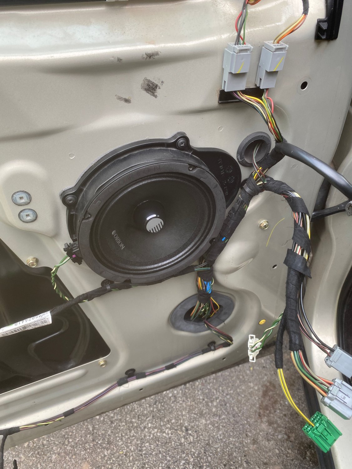

Put in some SUPER cheap Orion speakers in my front doors. The factory ones started to fart really bad. I tried to repair them but that resulted in them putting out pretty much no sound at all. The only issue with finding speakers was the fact that apparently factory are 2 ohm. Combine that with limited depth and the options for a 6.5" speaker really drop to just a few. I did have to modify the factory mounts a little but in the end I am happy. Sound is back. I need to look over the speaker specs for the 14 speaker system. I think the rear doors used the same so I may swap those too. Not sure about the D pillars tho. Really in the end I would like to replace all the speakers but retain the factory system. Oh... also swapped in a new door check, funny how a tiny fix like that makes the truck "feel" better. Mine was not super bad, but bad enough to make the door open not so smooth and a little clicky sounding at times.

Dakota,
once you found a speaker driver that fit, was it plug and play or did you have to solder any connections?

I soldered them to the connector once placed in the slightly modified factory plastic mount. The speakers are just a hair larger than factory. But overall it was an easy job.
