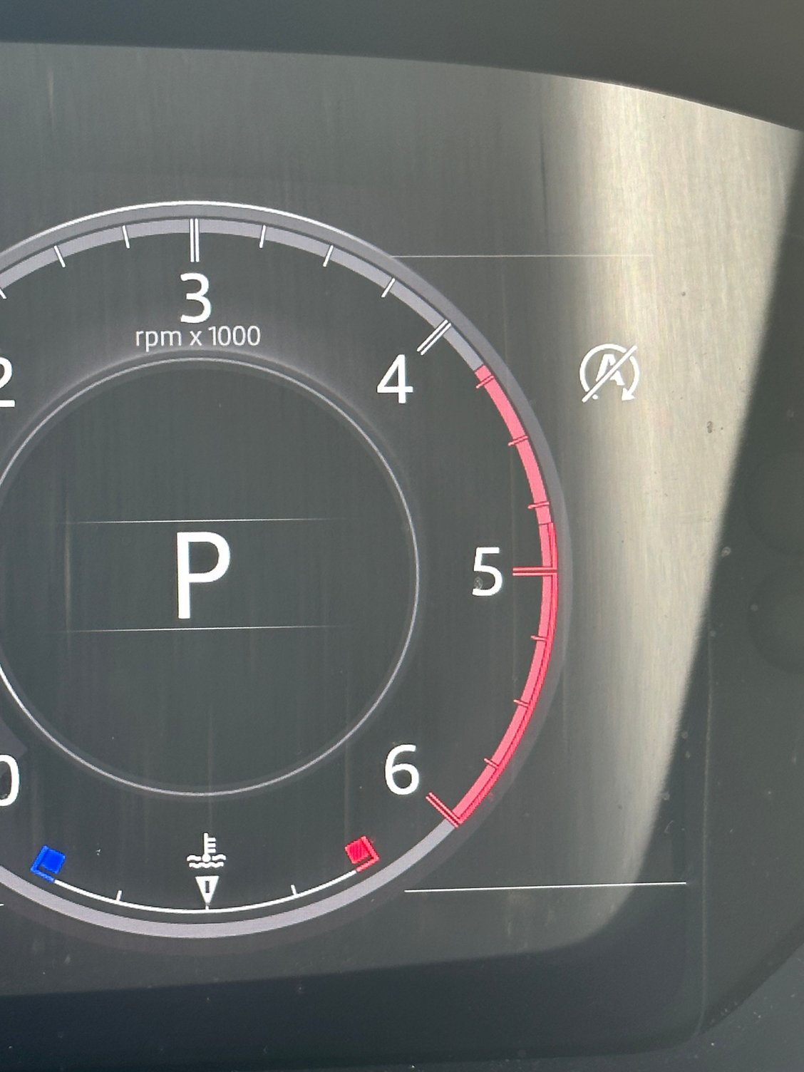

Old May 8, 2025 | 08:31 PM
  #110
5Xdriver's Avatar
Joined: Jan 2019
Posts: 18
Default Works
Did it today on my 2018 TD6 and works as advertised. When I am stopped, the auto start disabled icon shows up in the dash with the gostbuster symbol over it and truck keeps idiling!
