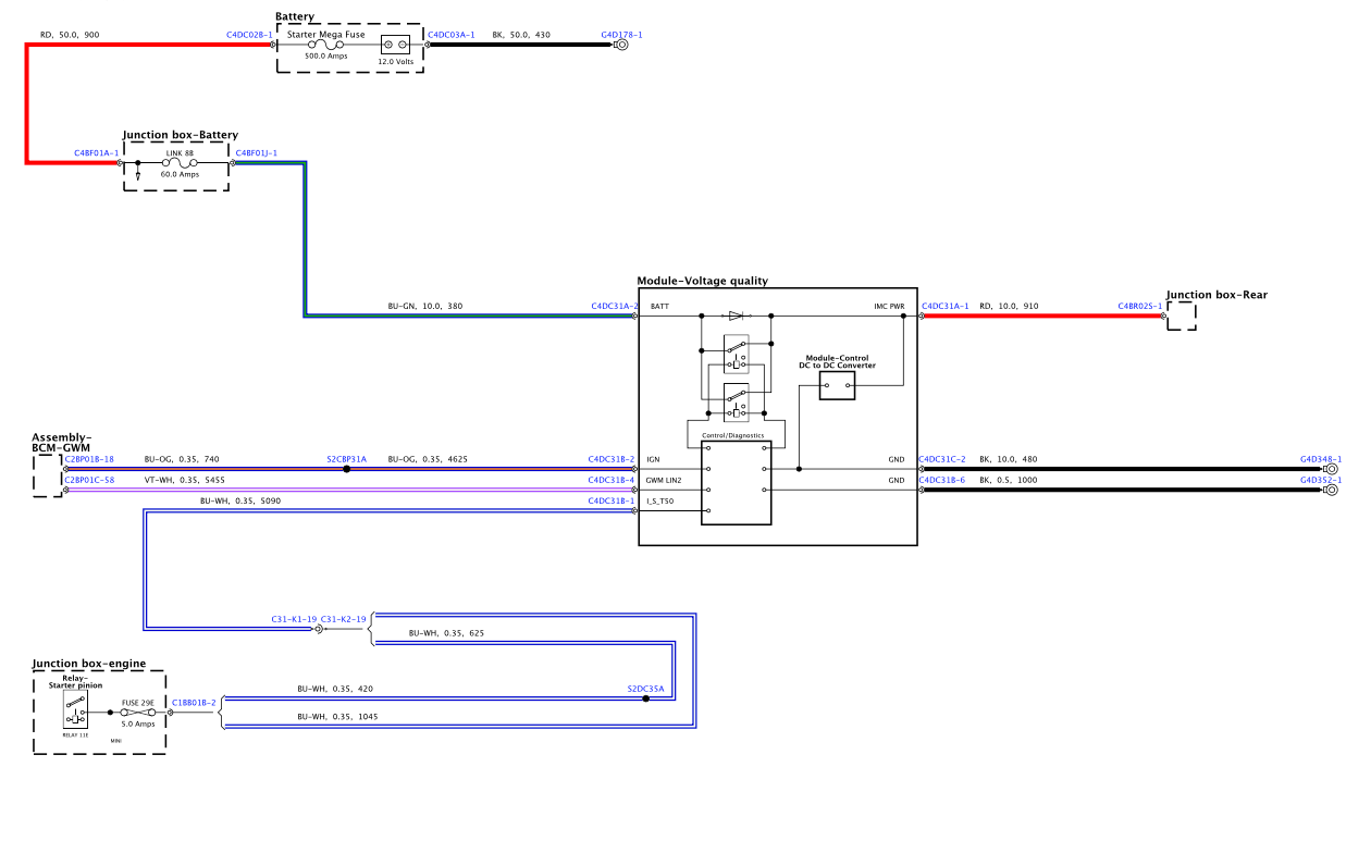

I looked up the wiring diagram of the VQM. It is easy to see that if you unplug the control wires the relay simply stays in the closed position for the battery positive side to feed to the junction. If the VQM is enabled it opens the relay and connects to the DC-DC converter (Boost mode).
