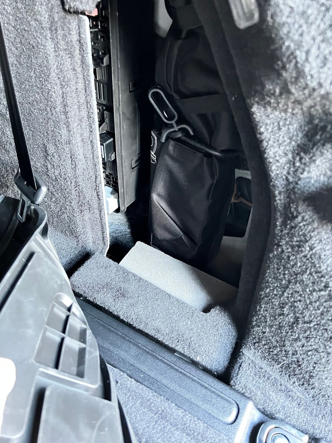

when I pull back that foam insert, there is mostly an empty space with a couple of grounding wires screwed down. But I don't see the model or anything that looks like his pics.
Maybe I'm in the wrong space or not looking at the correct angle?

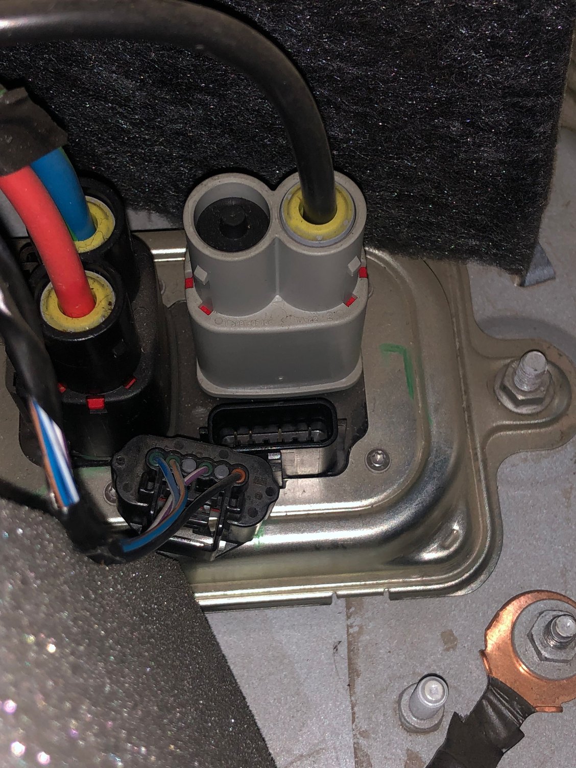

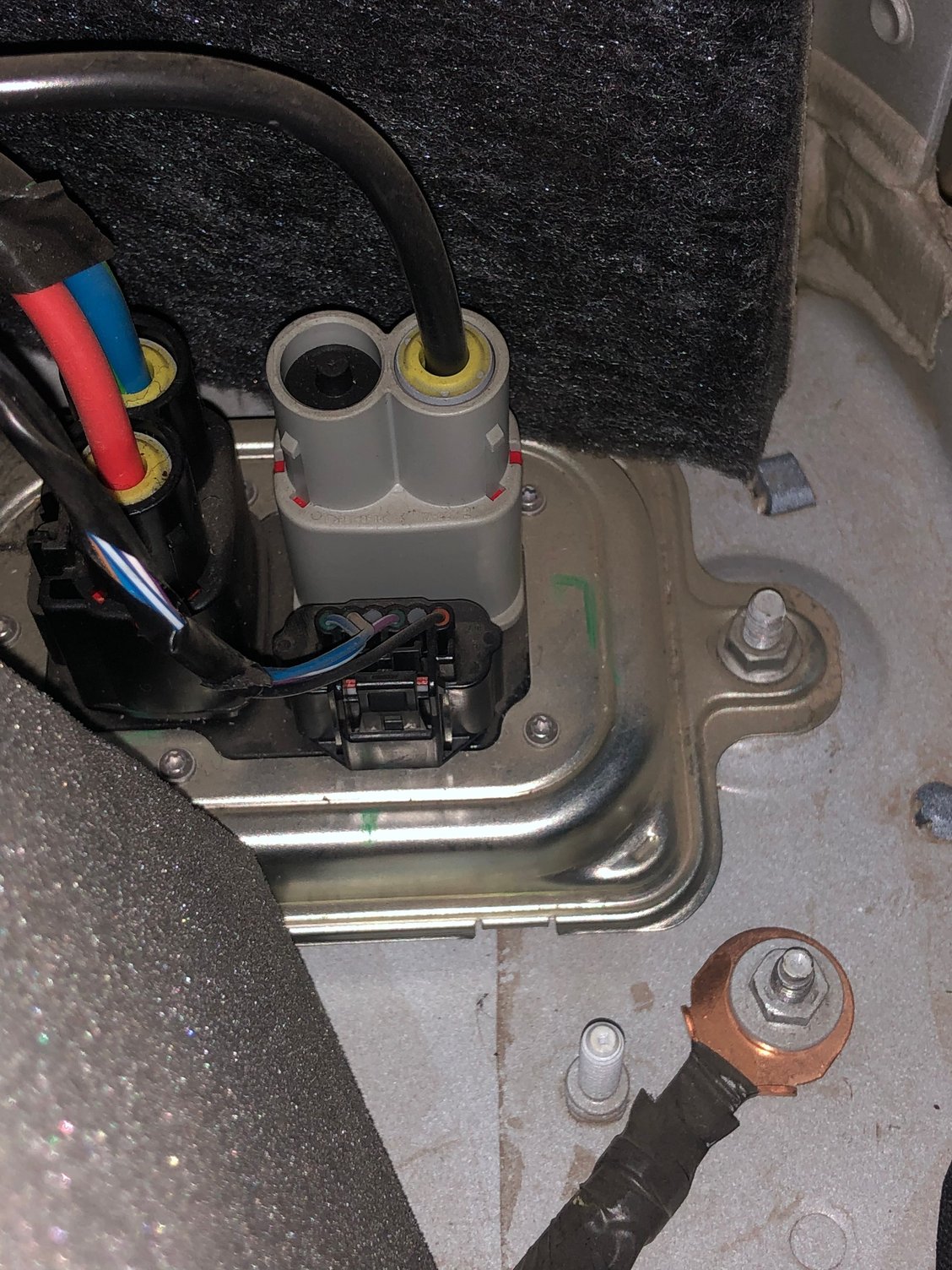

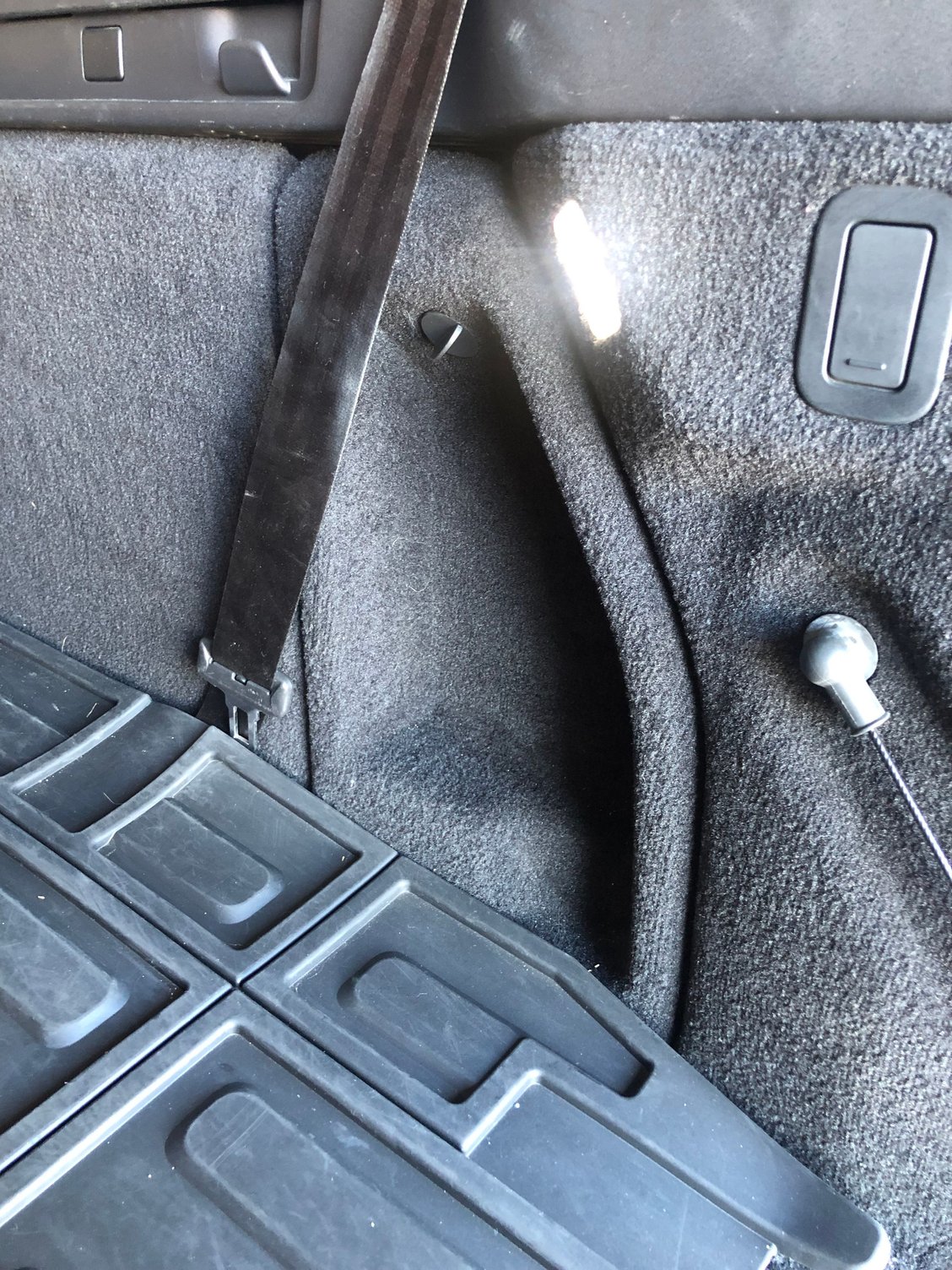

Pictures below show the cover on passenger side ar rear that must be removed.
Next shows the connector in place.
Last shows the connector removed.

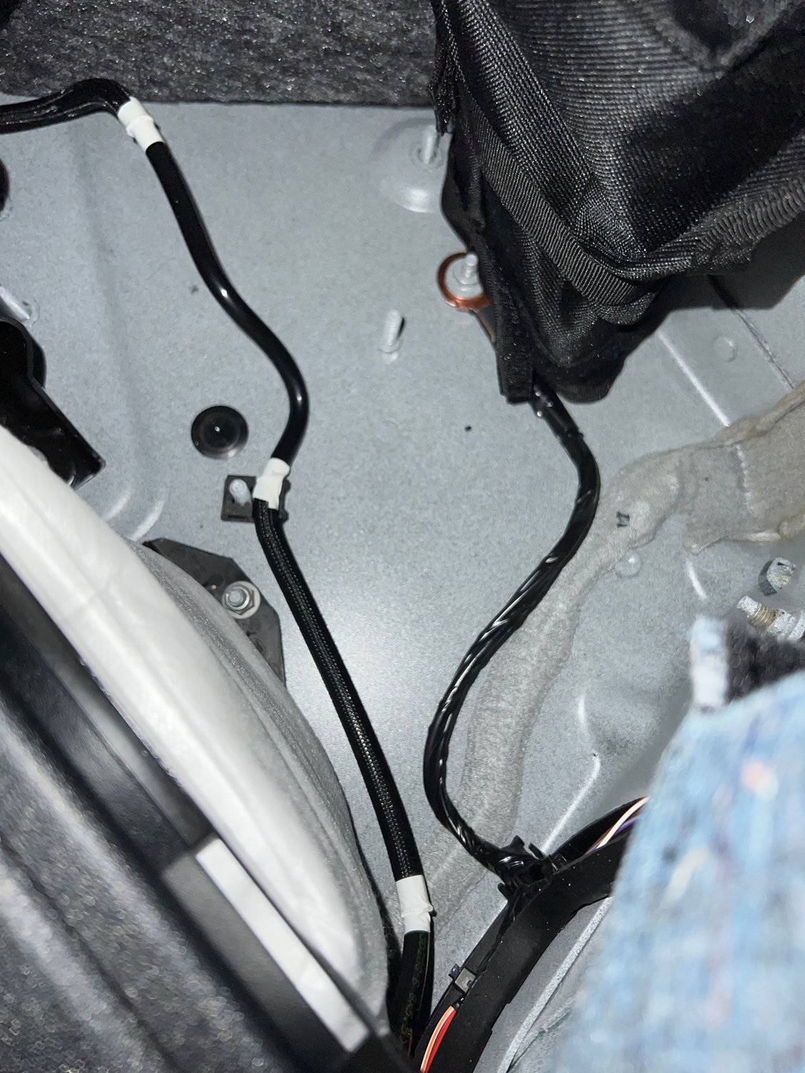

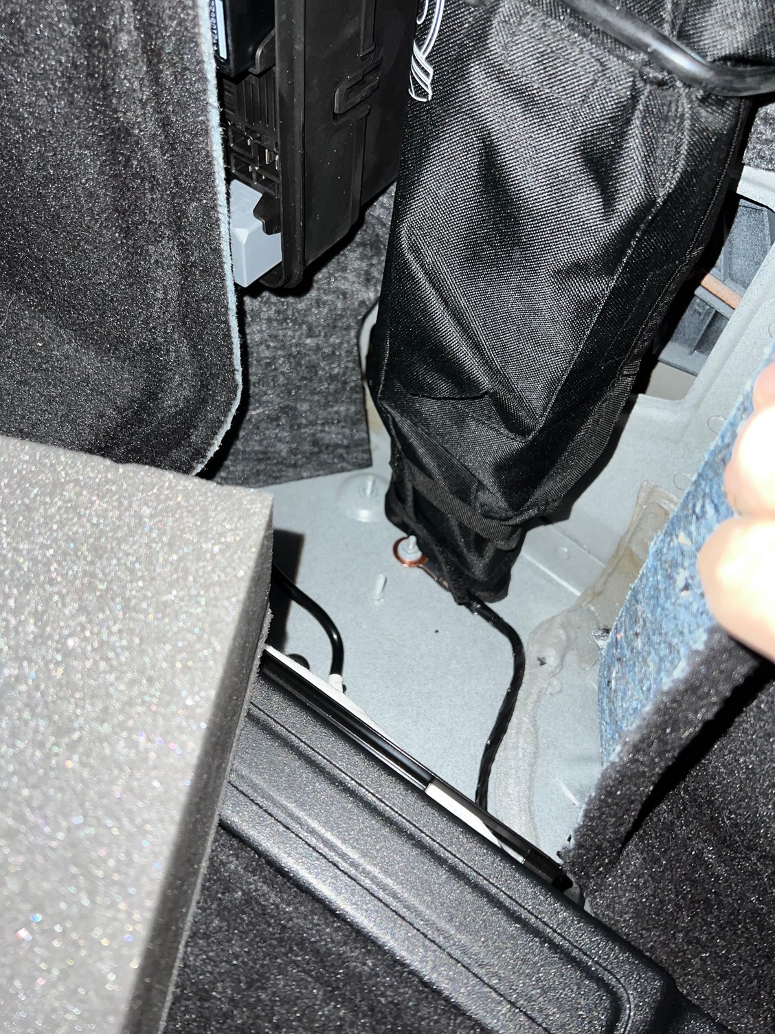

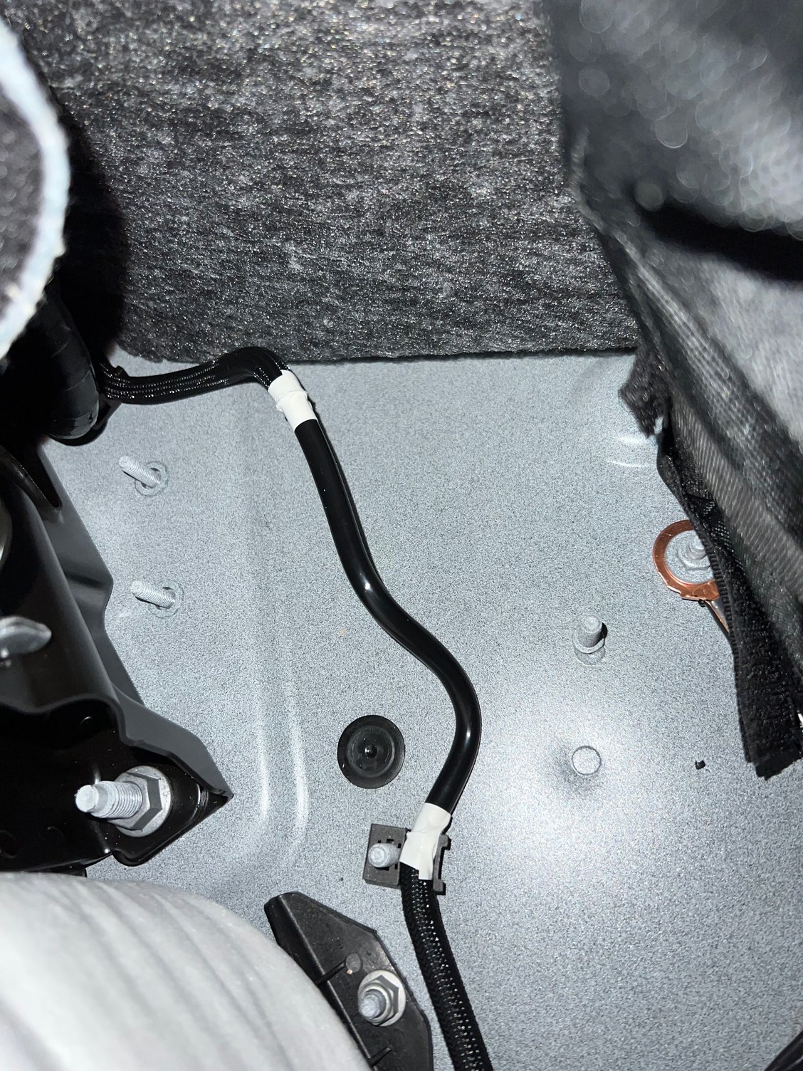

Either I'm looking in totally the incorrect space or this module has moved for '22. I'll post a pic here shortly, but where you show the module just above the ground wire, I have white floor space.

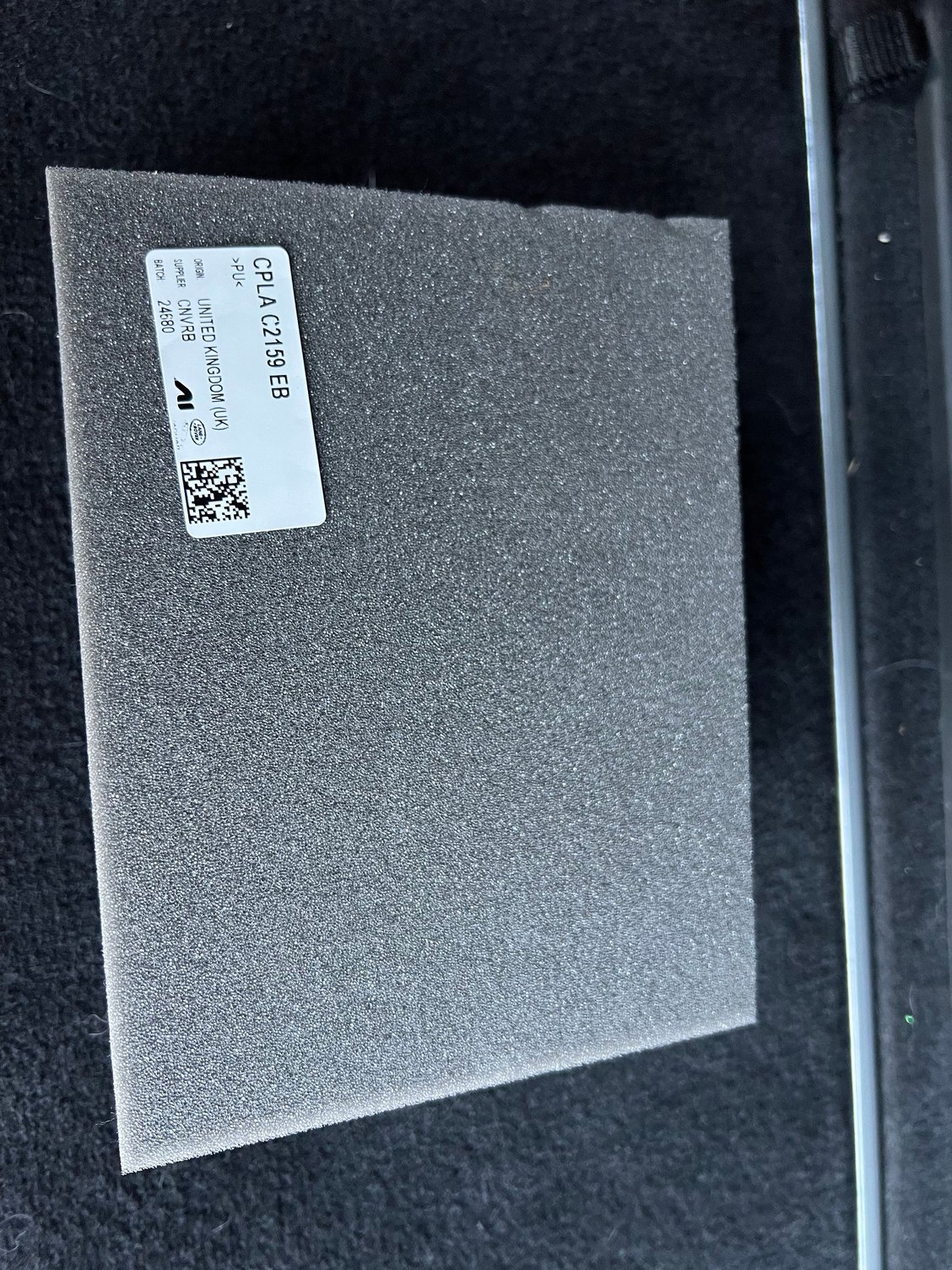

(side note, totally entertained by the simple rectangle of FOAM, that is important enough to require a parts sticker on it.)

The name of the module I have disconnected is: VQM (voltage quality module). If you can find out where they moved it to on your 2022 then maybe you can unplug it. Or maybe you don’t have this module.
Unrelated: auto stop start supposedly saves fuel and increases mpg numbers. I’d rather use a little more fuel than pay for a really expensive starter down the road. Plus I just don’t like it shutting off.

Weird. As you can see, unless I'm just totally blind, they've relocated it. Wonder where?
Also the aforementioned foam cube.

I agree, you don't have one in the same place. You are not blind.
I wonder how much that piece of foam costs.
