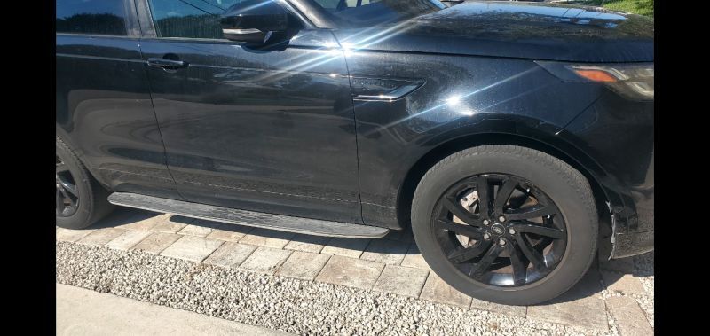

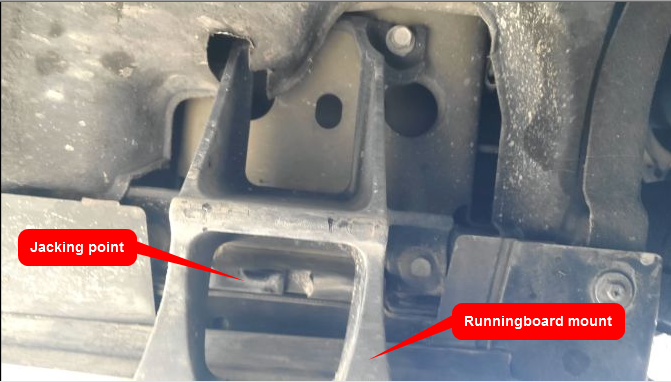

I have a 2020 Disco Landrmark, my car has running boards. I took my car to Costco for tire replacement, was told they could not lift my car since they could not reach the jacking point (see attached image) and did not want to cause damage to the running board mount.
Has anyone experienced such a thing? would lifting the car where the jack hits the running board mount, have caused any damage? Did Costco need to have a special tool or puck, that the dealership might have?
Please see images below and advise if I should go to the stealership for tire replacement or I have other options?
Running Board
Running Board
Running Board mount and Jacking point
Running Board Mount
Running Board Mount

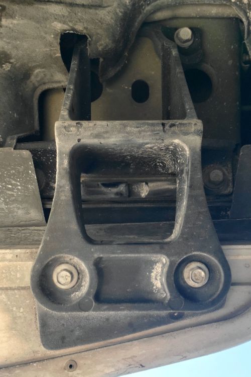

The running board mounting brackets are the exact place to lift your Disco. Somewhere in the owner’s manual it states this. You could show that manual to the shop and authorize them to lift it that way. Although I have only had my 2017 with factory running boards lifted by the dealer, and an independent LR shop and Discount Tire there has never been an issue. I do have to instruct the Discount Tire guys where I want it lifted. I have jacked it there myself dozens of times. Those brackets are so hefty you could probably lift the entire vehicle with just one of them.
