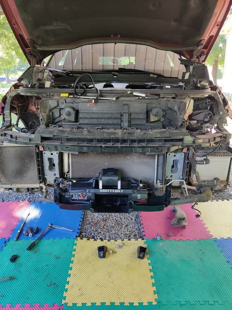

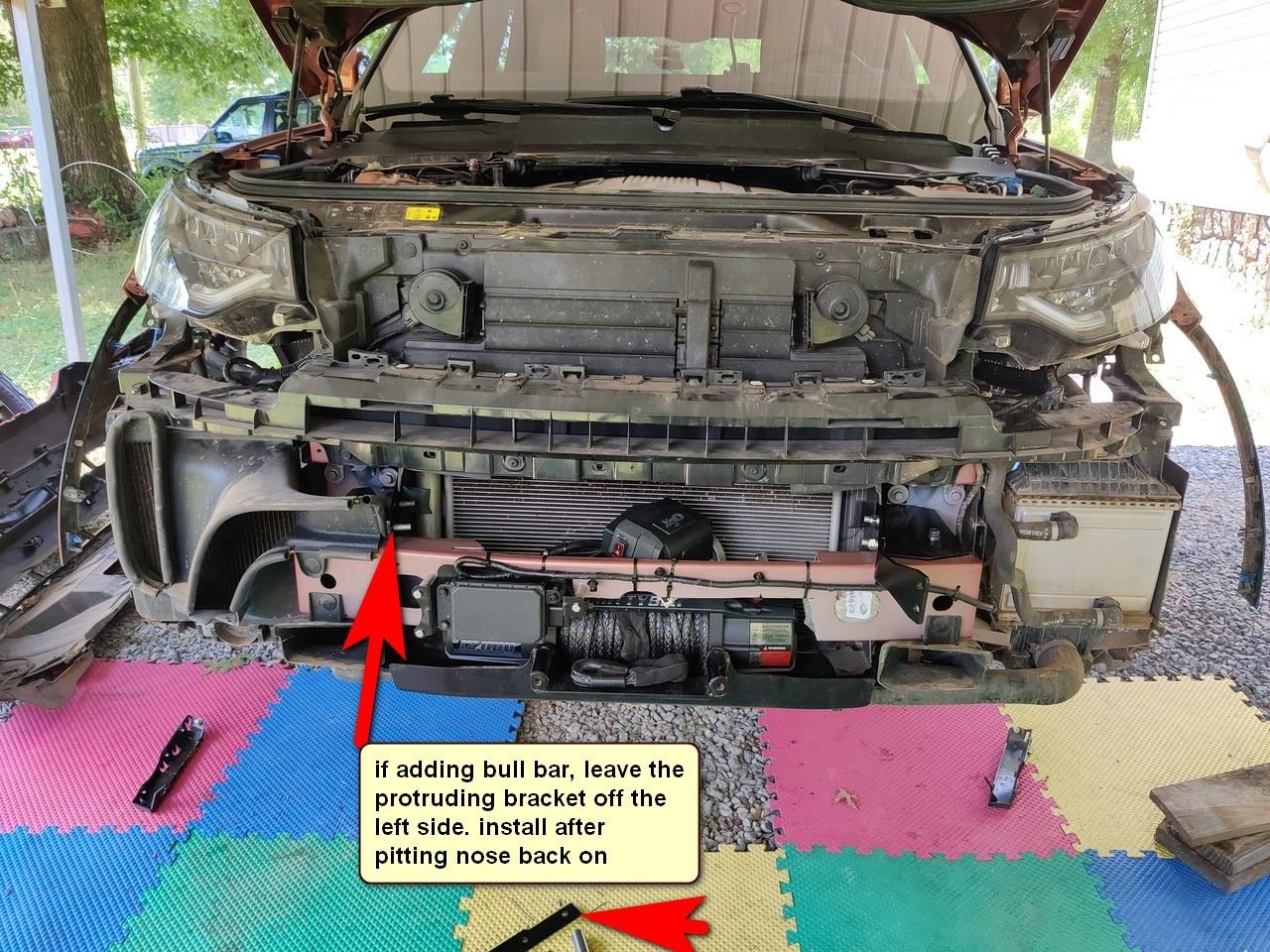

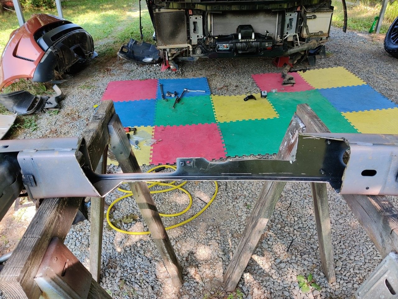

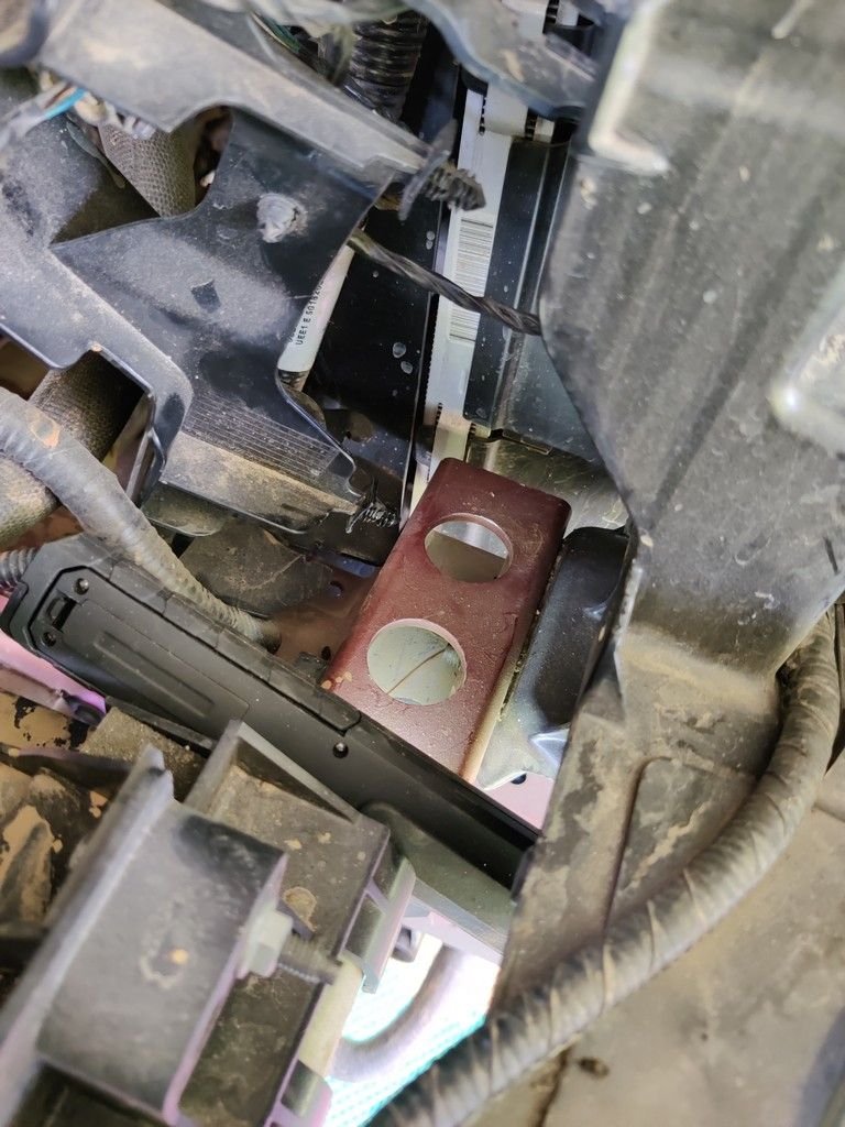

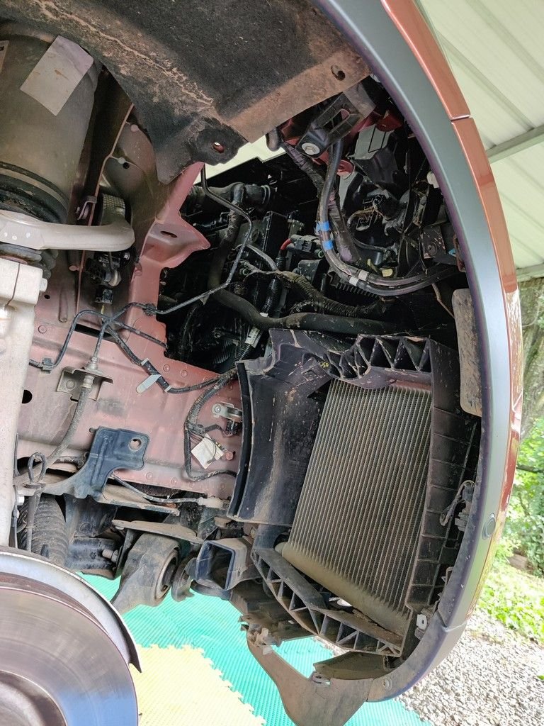

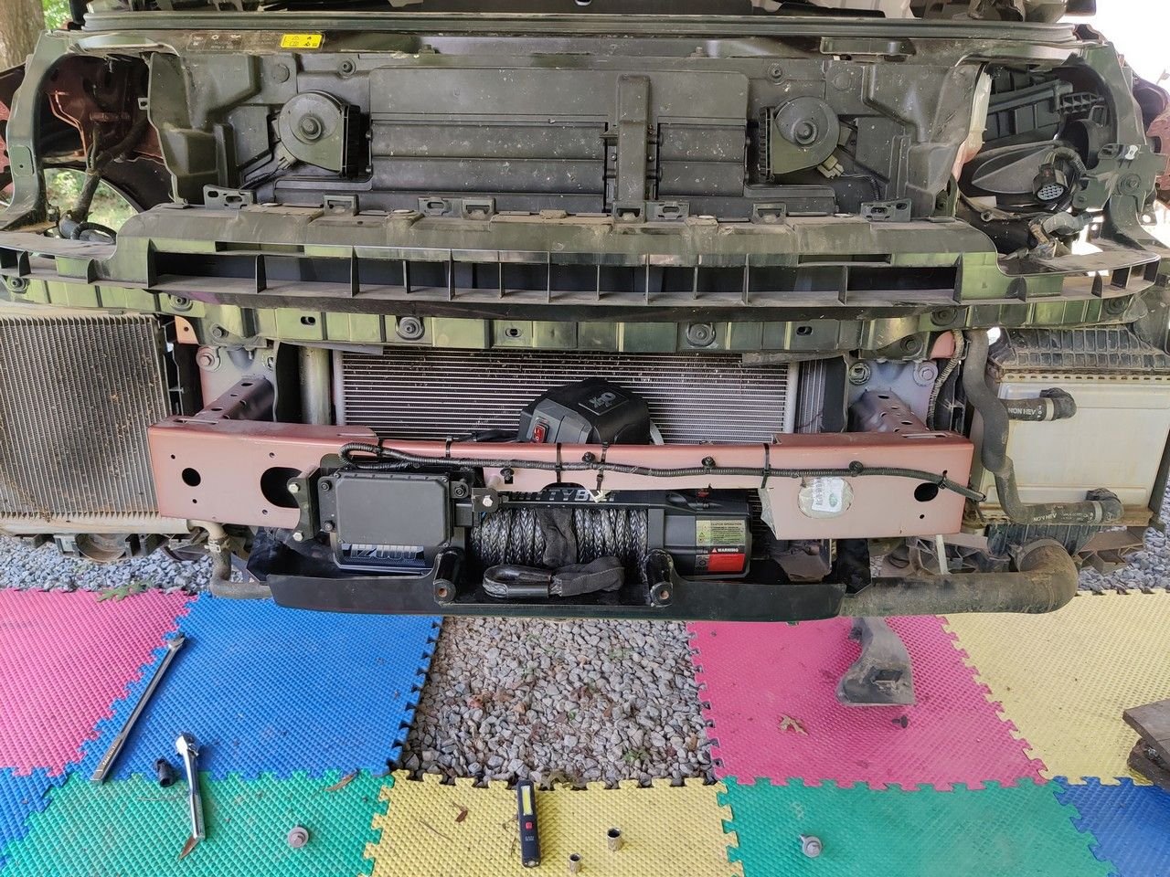

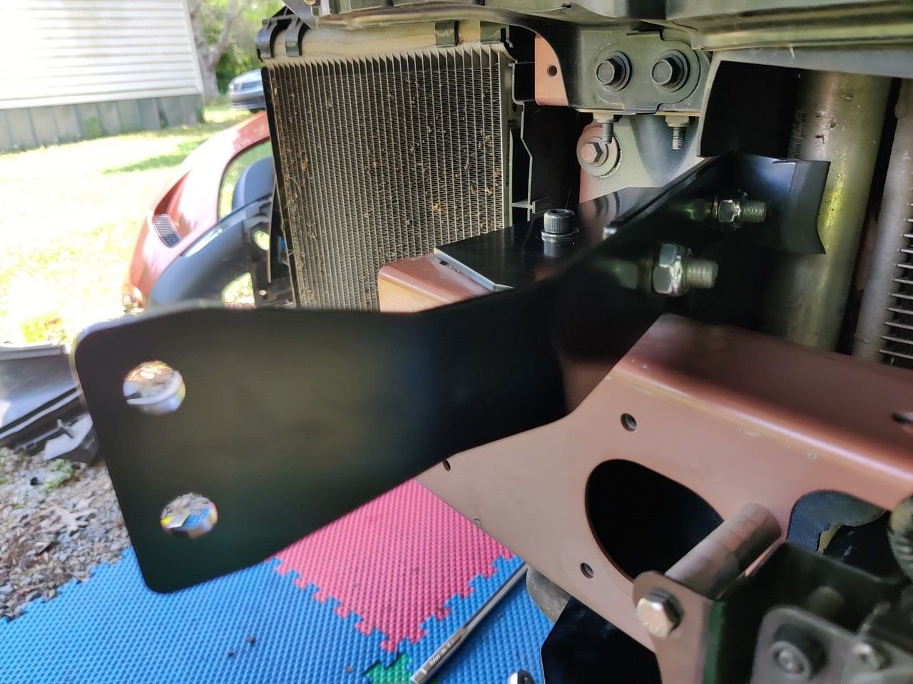

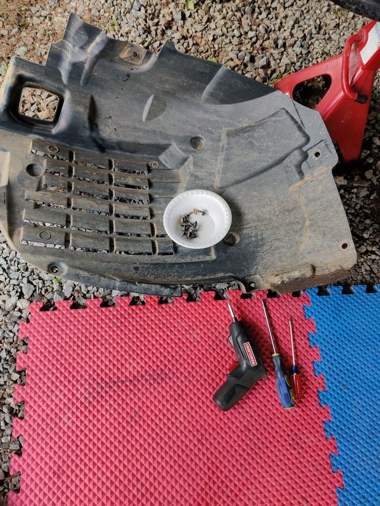

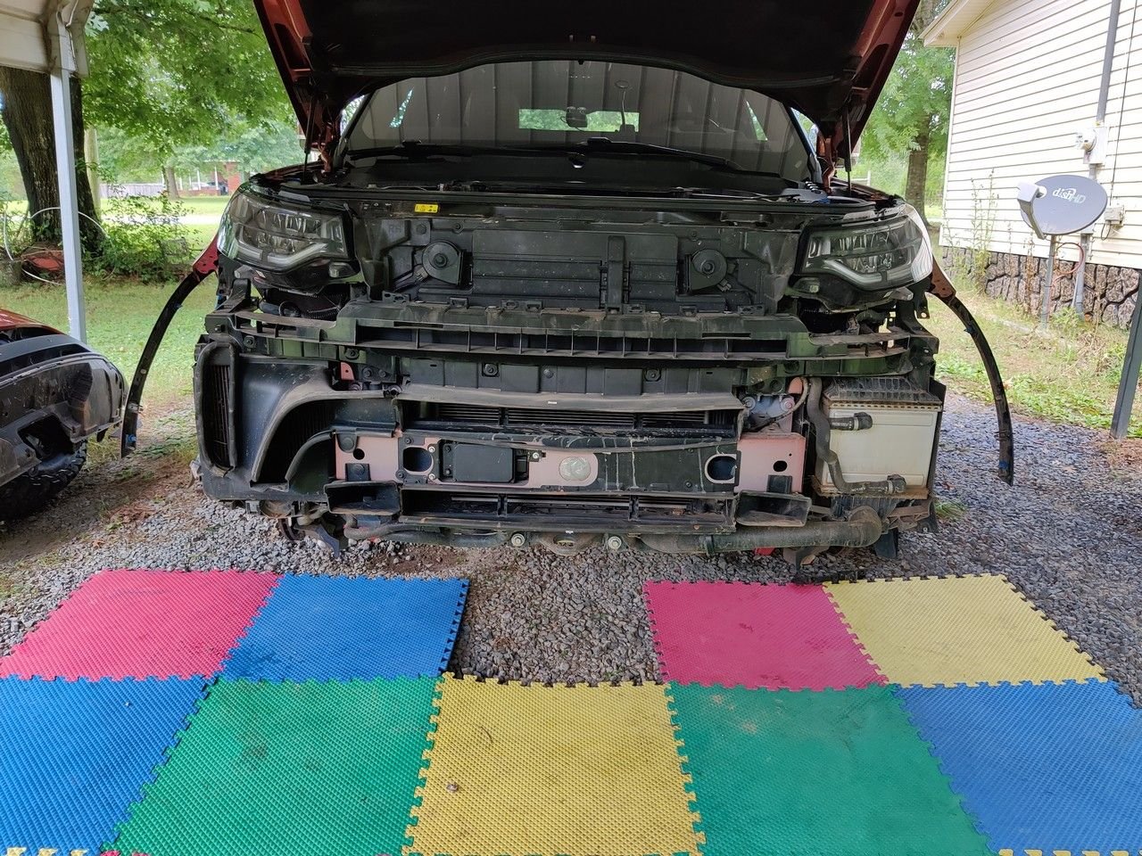

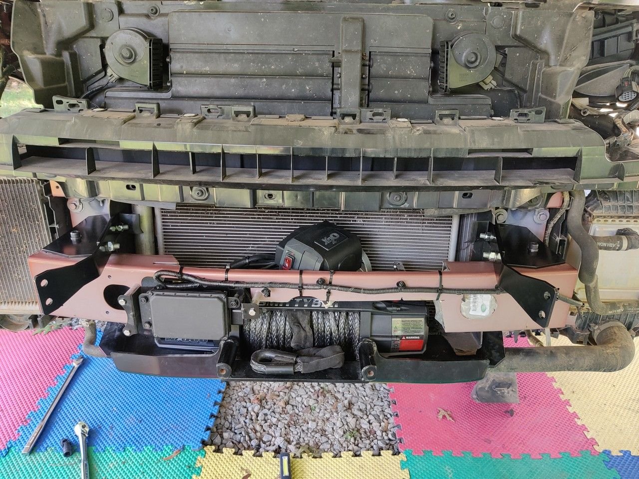

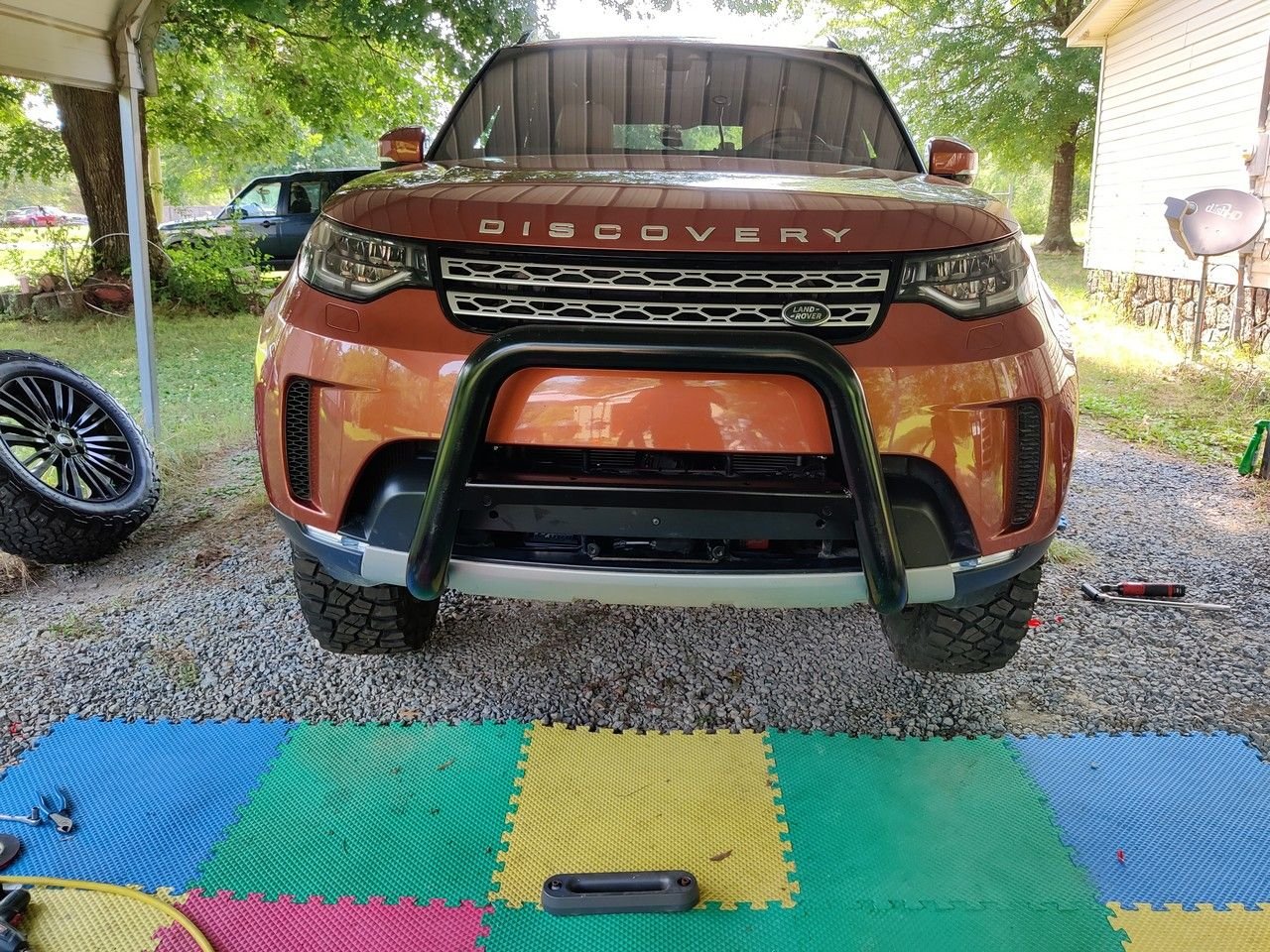

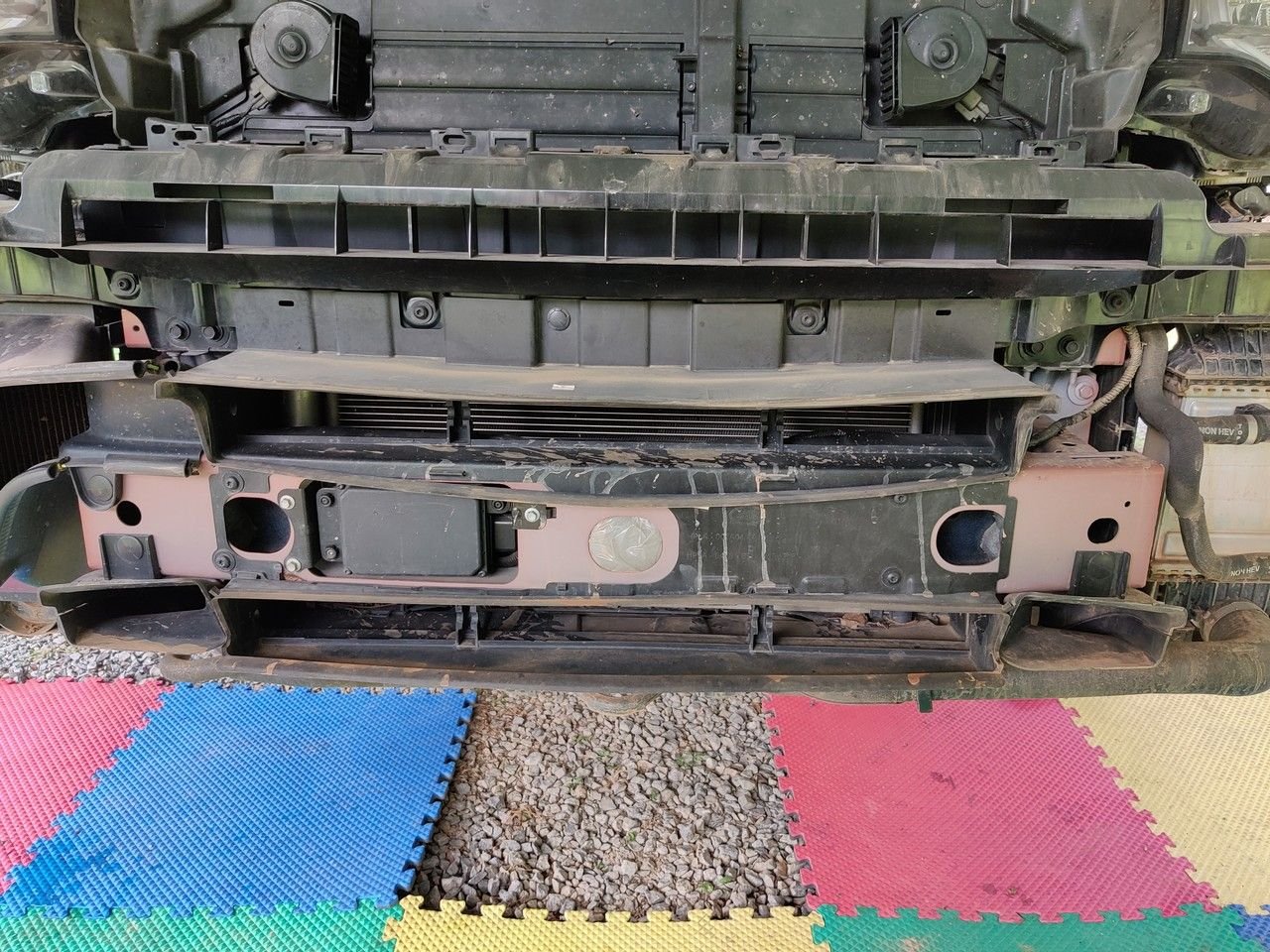

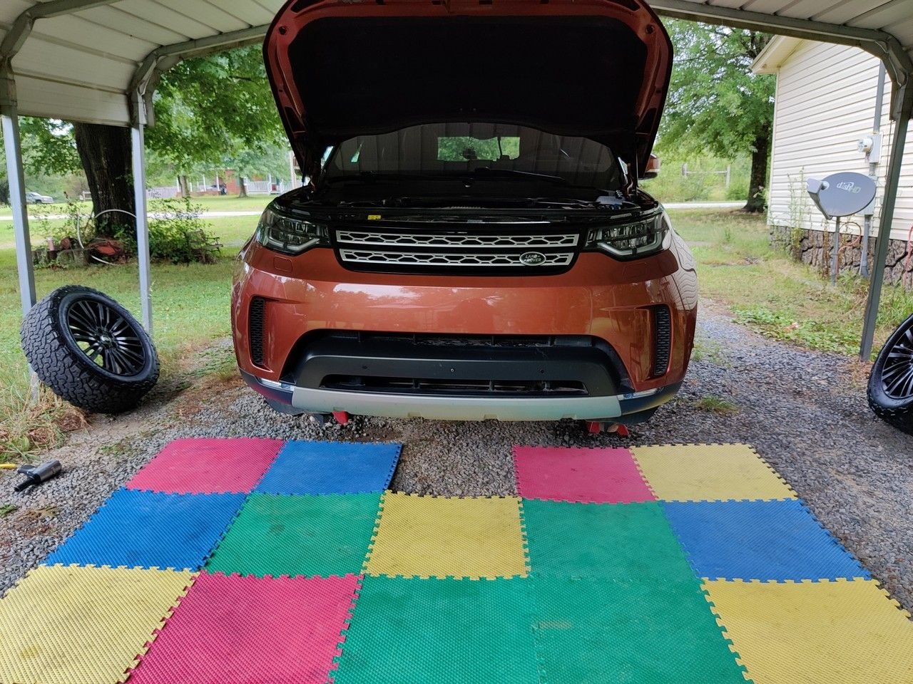

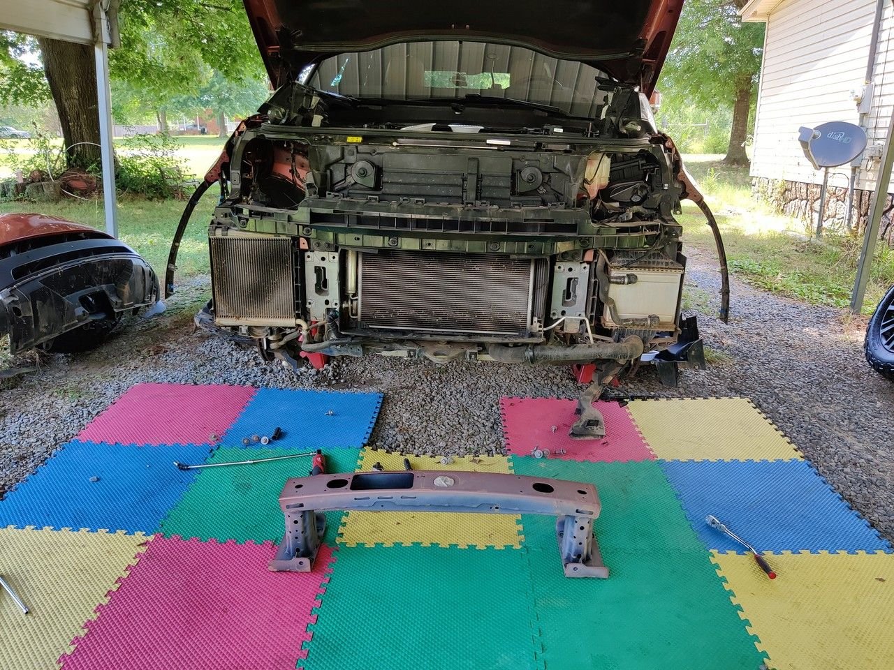

Beginning
right inner fender
right inner fender

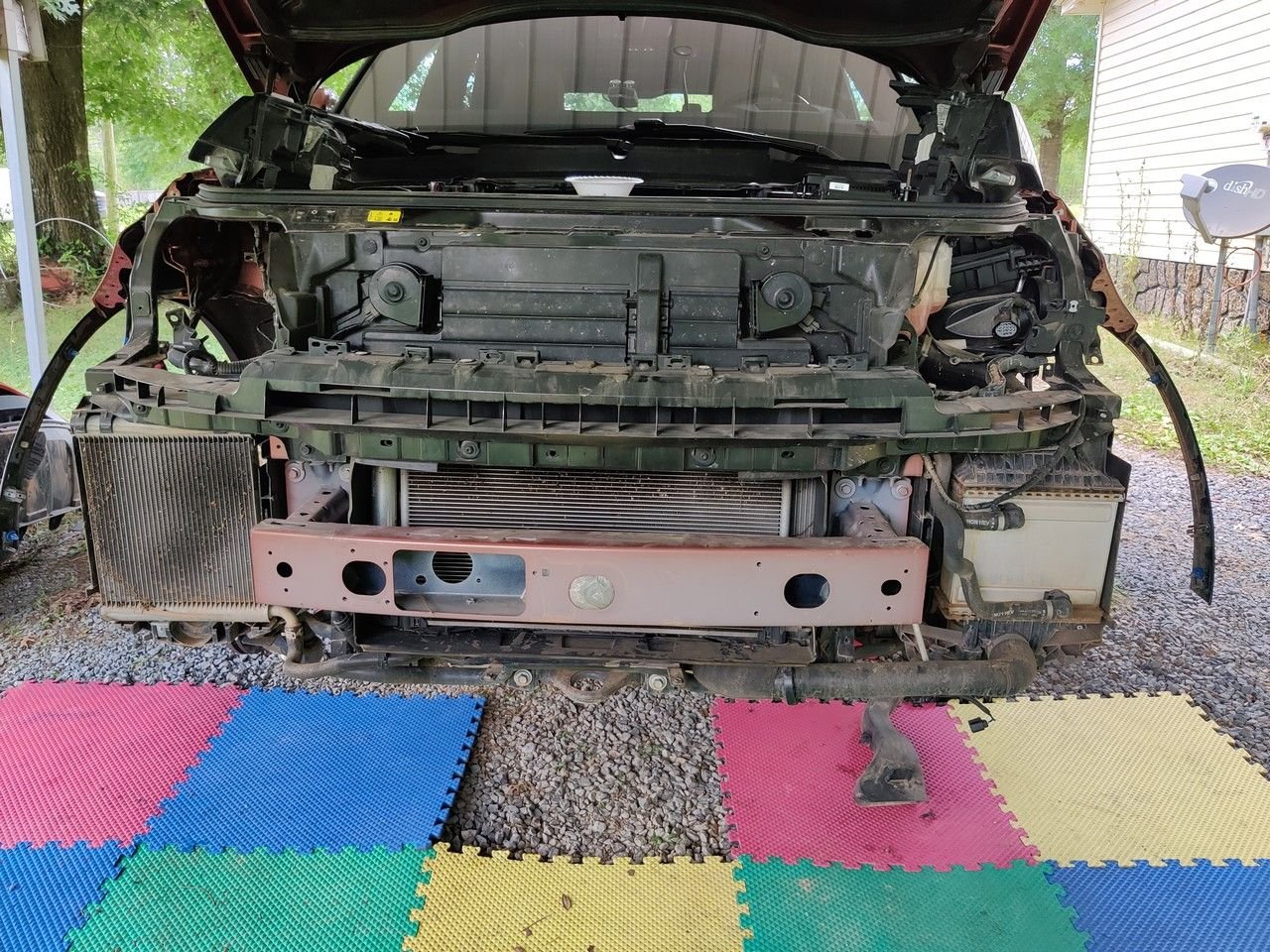

Nose removed
All the bits removed

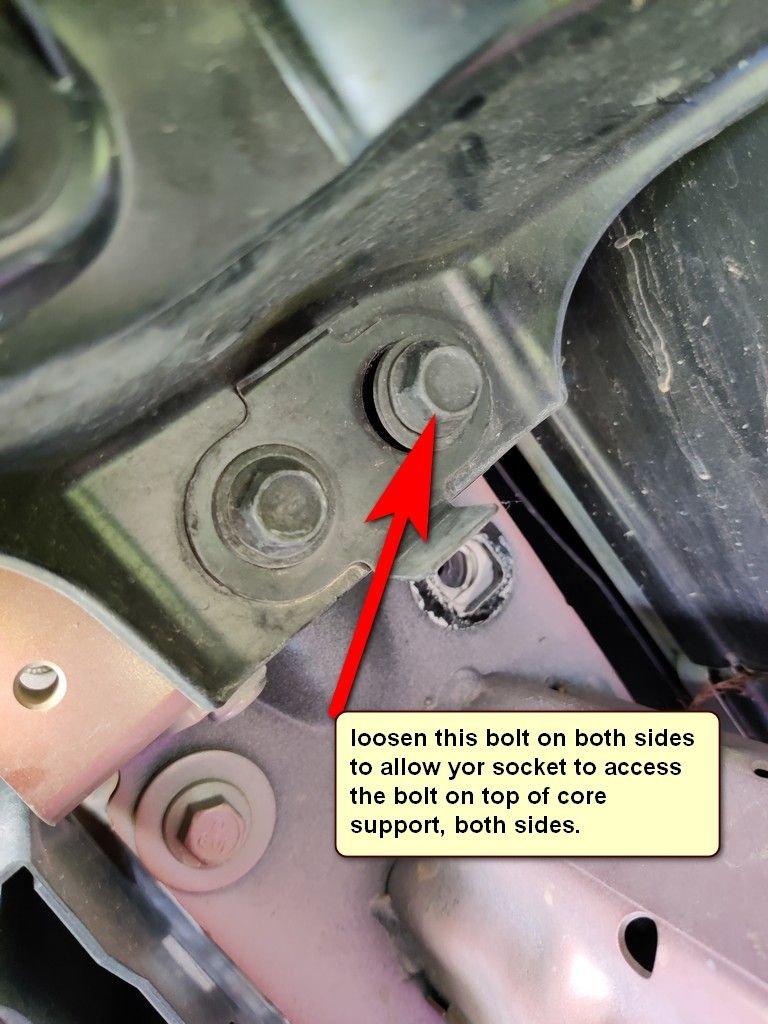

must remove headlights to access bolts both sides
must unscrew 3/4 out
core support off

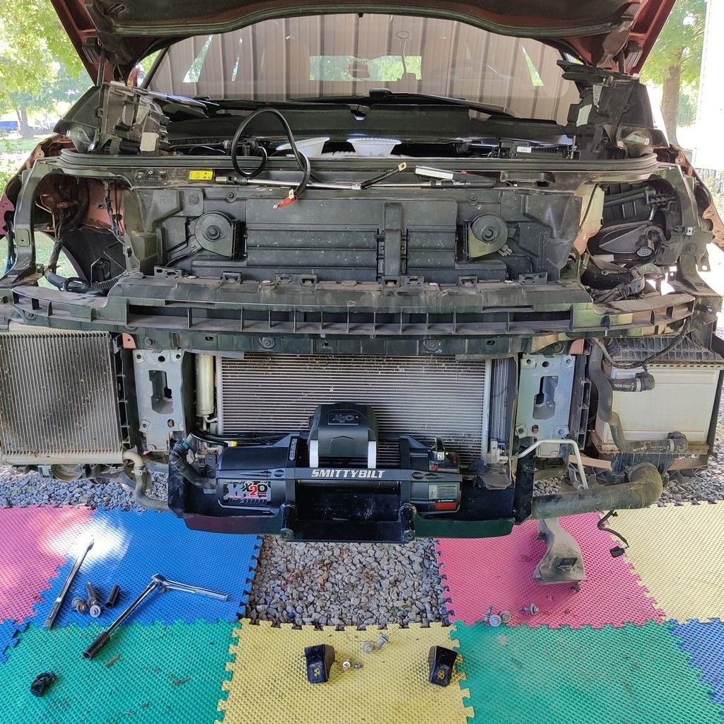

test fit mount and winch

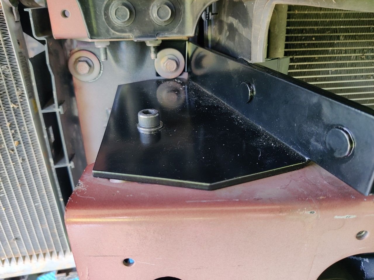

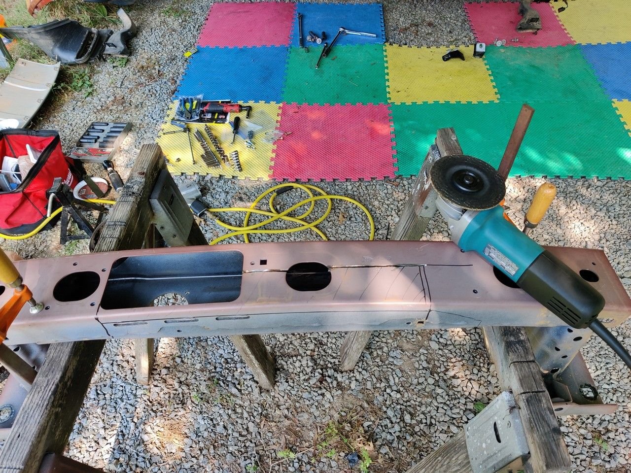

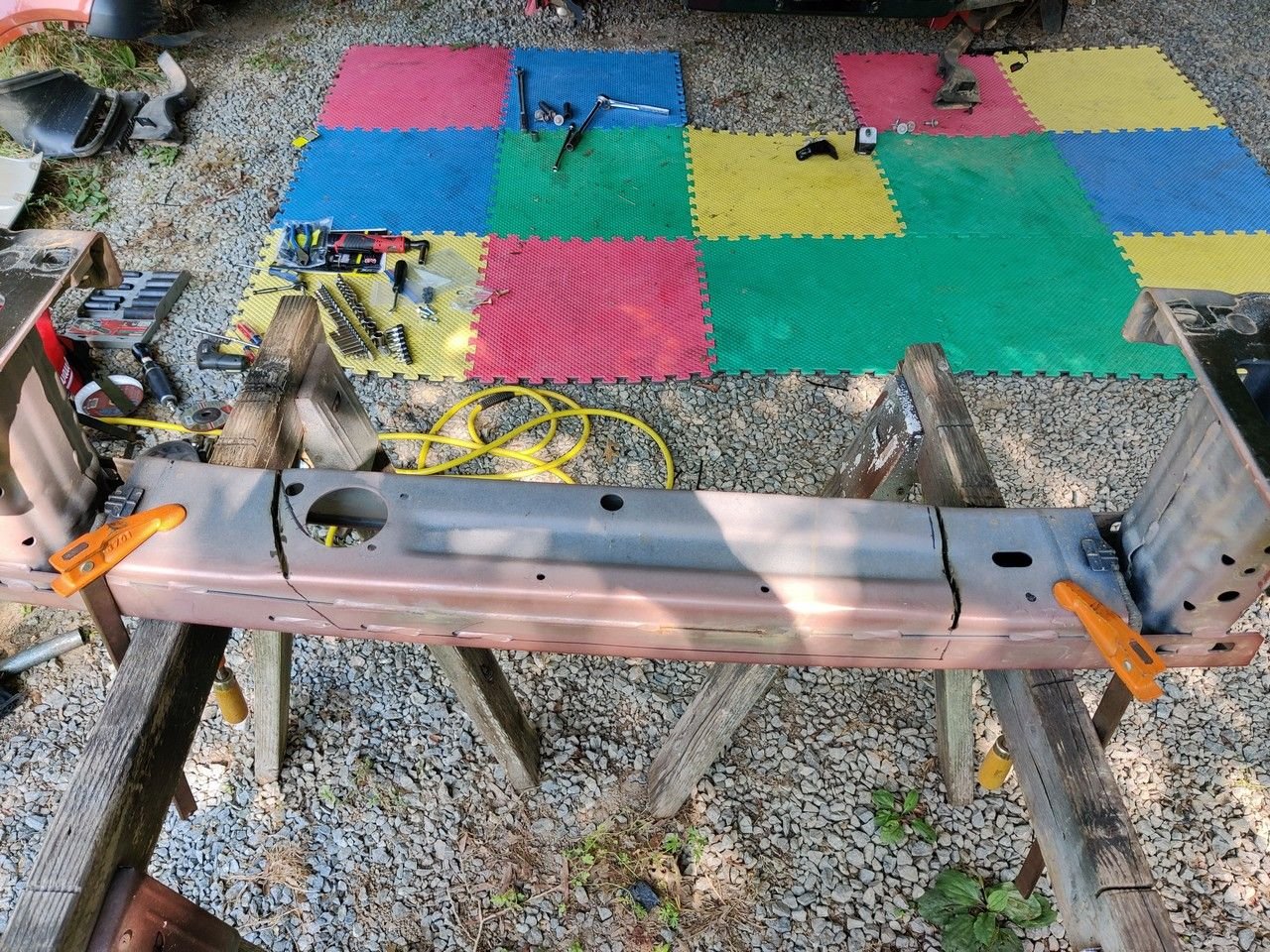

laying out cuts to core support

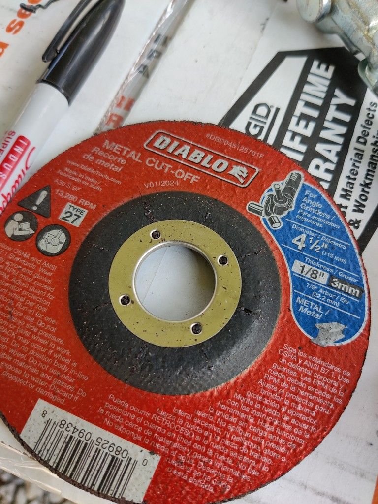

1/8 thick works best
Oh yeah, Safety first. shield $14 Home Depot
cable on, radar on, cables tied
bull bar mount
continued..........

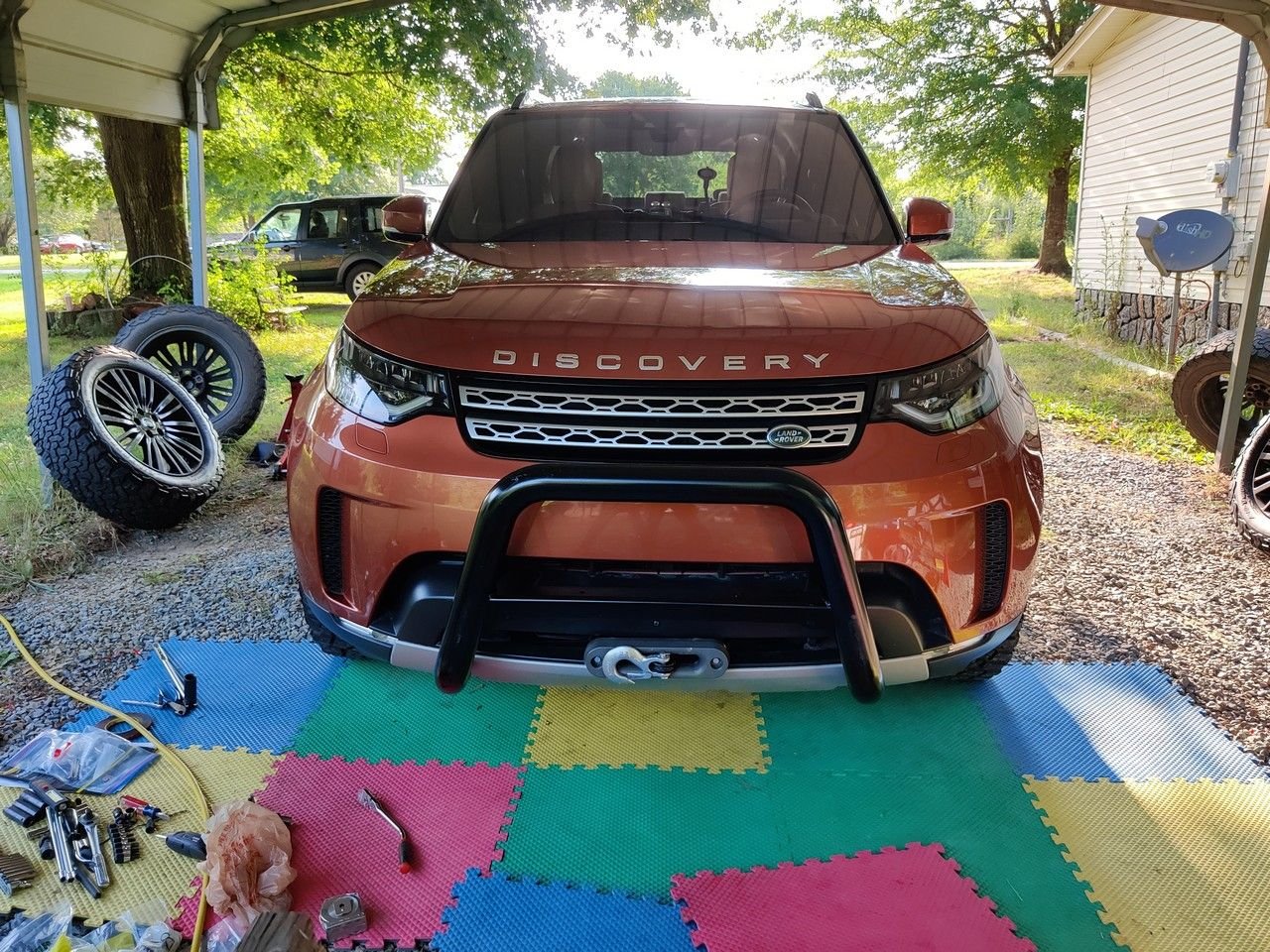

continued

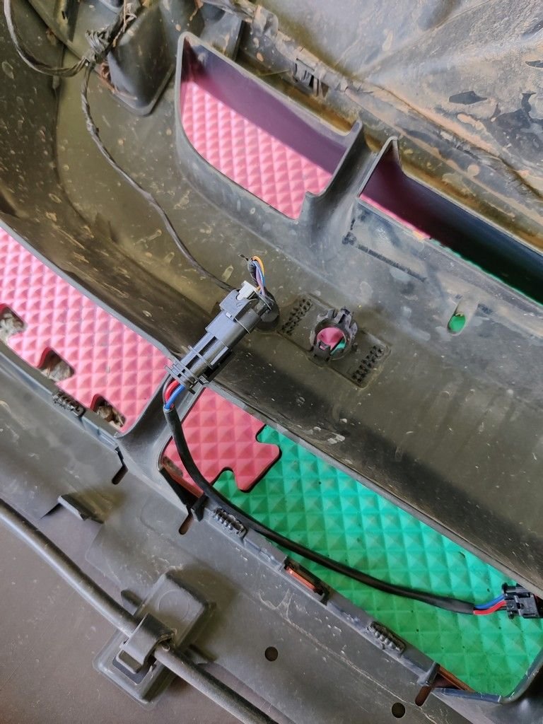

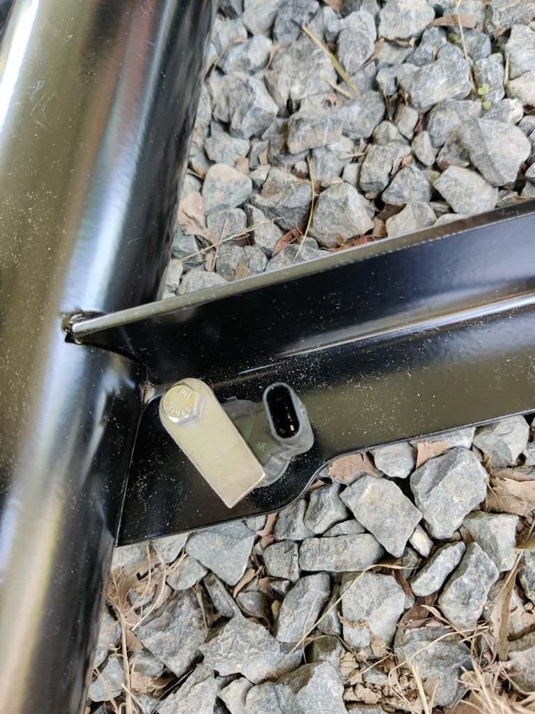

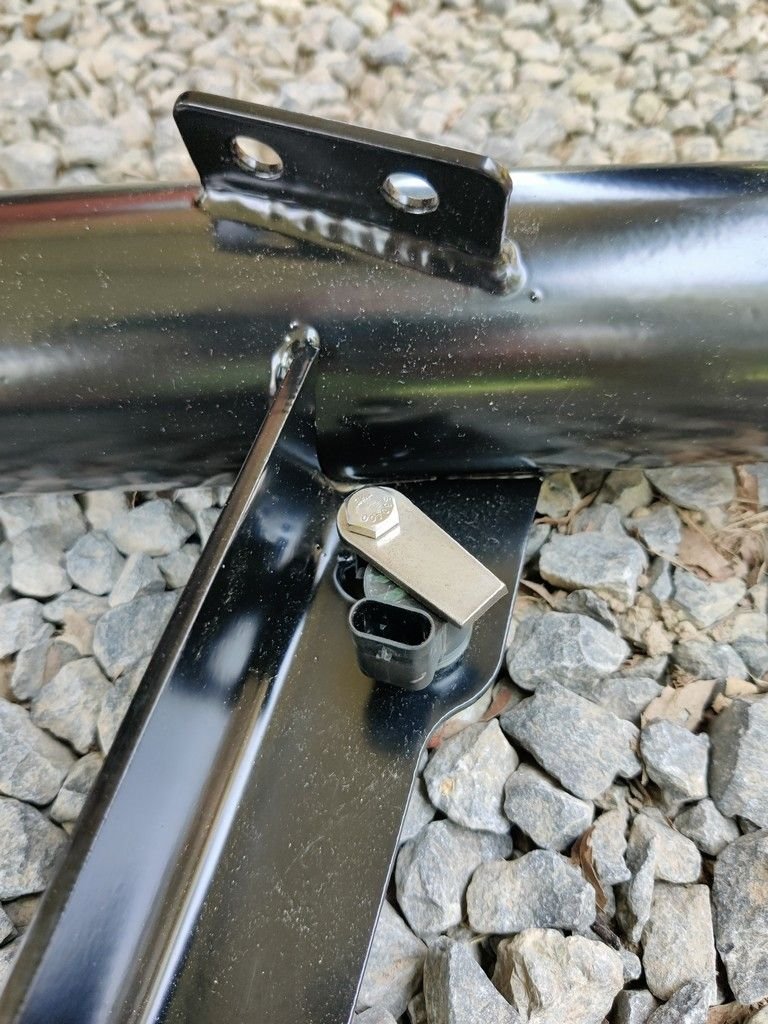

relocated parking sensors
parking sensor extensions provided inkit
read
done
done

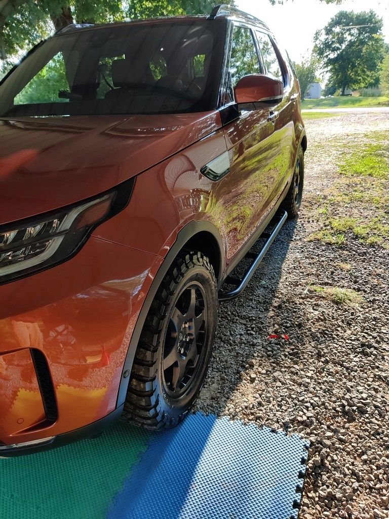

Went back to 18" Compomotive Wheels, and KM3's
Message me with any questions. I'll be glad to help anyone with there install, within a reasonable distance.

I'm going to try and list the major tools you will need for the job:
6 ton jack stands (not harbor freak)
Good SUV or floor jack
A good Air compressor and impact wrench( not completely necessary, but a big big plus)
Assorted metric sockets 1/2", 3/8" and 1/4" drive, yes you will use some of all (wigglers or universal joints for each drive too)
Long extensions for all drive too. (12" or more a plus)
molding tool.
Philips screw driver
hose clamping pliers ( for windshield washer hoses)
4" electric grinder 1/8 Diablo cutting disk, I used 2
Face shield ( a must)
A retrieval magnet
good led light helps
A roll of 3M molding two sided tape to re attach the fender molding
a set of saw horses make it easy to make your cuts on the core support
Cable ties
If you have the diesel :
1. Refer to my first build and notch winch plate, to clear hose.
2. purchase 3 small pipe 2" long pipe nipples ( used to remount radar on outside of core support)
3. purchase 3 6X1.0mm bolts ( used to remount radar on outside of core support)
I hope this helps.
I did it alone, but having a helper would be a plus.
Good luck!
