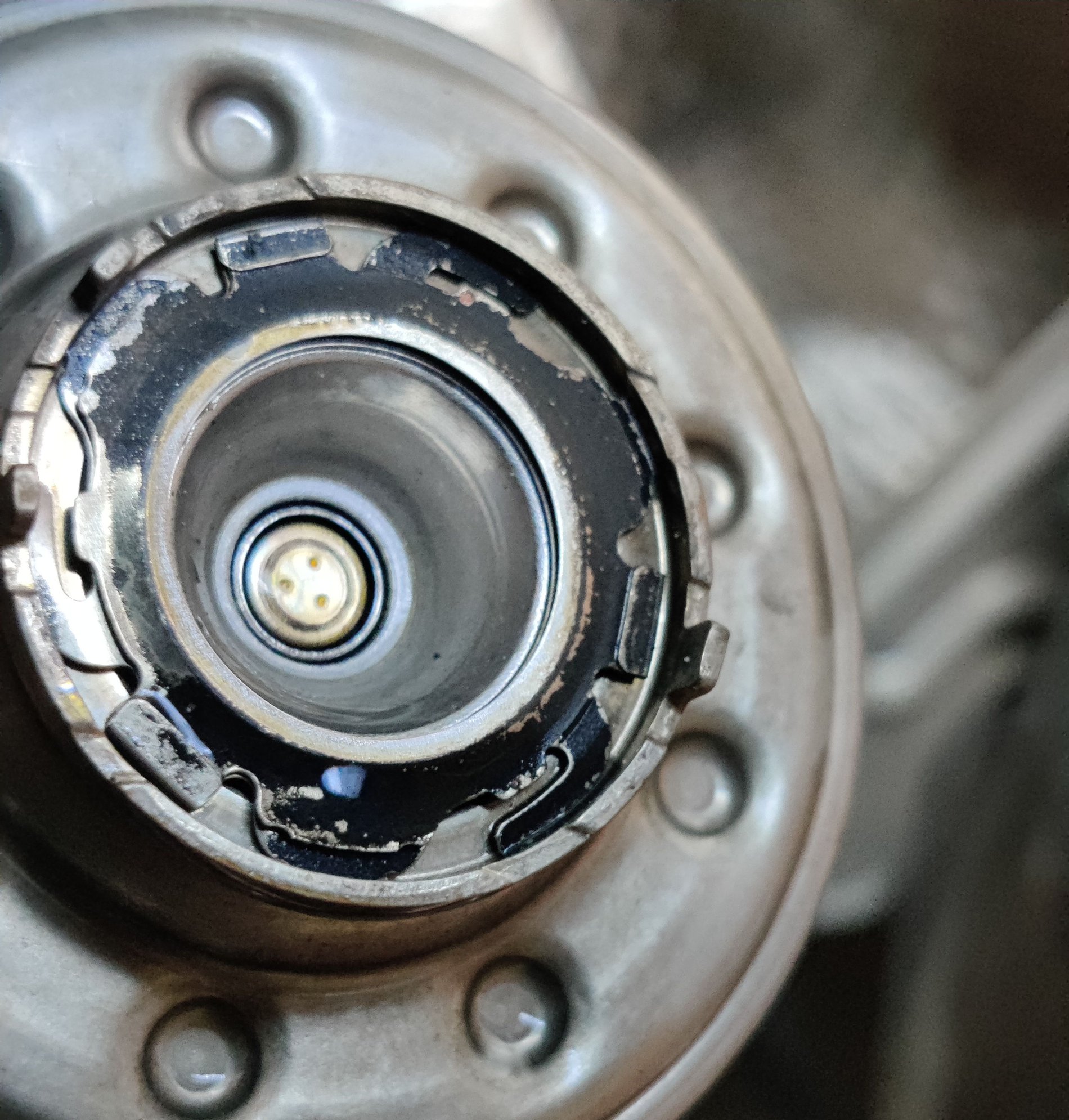

DEF Injector cleaning. 2017 D5 TD6
Located Driver Side, just past 2cd factory skid plate.
Most of build up stuck to the other side.
The build up just dropped off.
I cleaned with a hand held steamer. Water/steam only.
Some notes:
My rig has 60K.
The screw that holds the clamp is rotated to the top.
I re installed rotated down in a easier position to re tighten.
TIP: During reassembly, position injector( it only go one way) squeeze clamp together, push the locking tab down, then reinstall the screw.
Feel free to shoot any questions my way.
