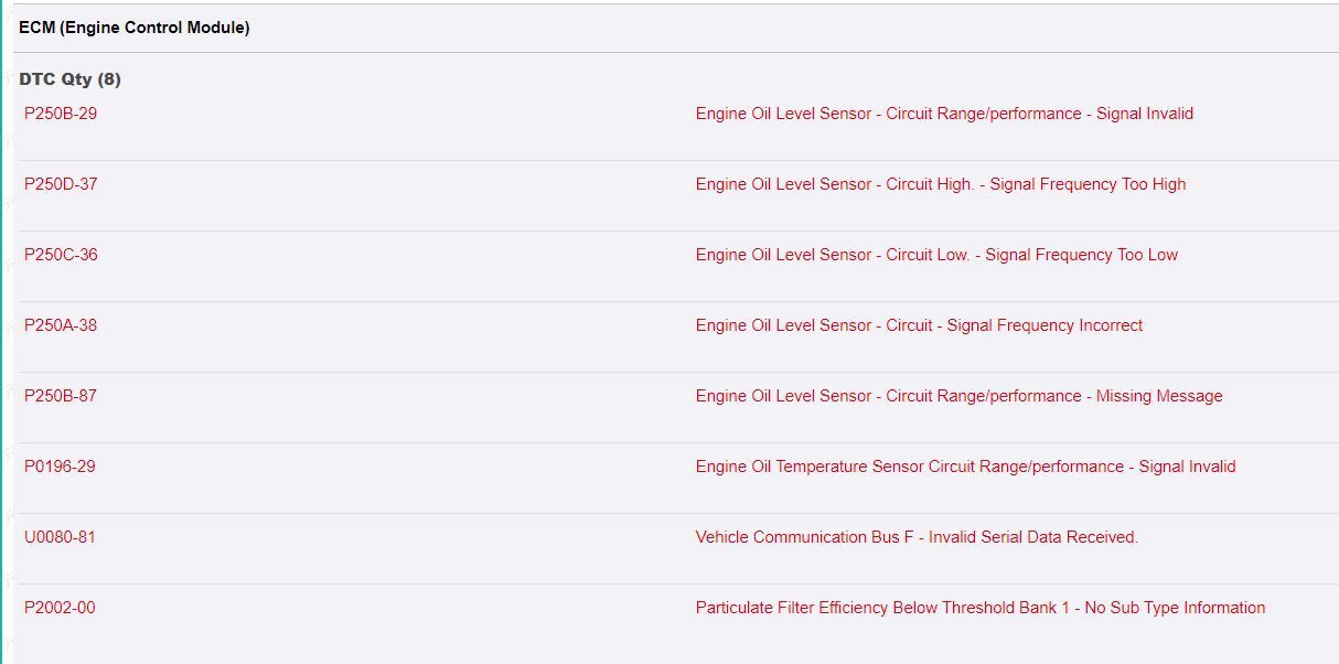

Bad news for my oil level sensor. She gone. I won't be fixing that anytime soon. Got to pull motor, Its in the oil pan.
Oh well, on to Uwharrie Safari this weekend in NC!
don't look at the P2002, LOL
Oil level indication failure was the first (and only) chronic problem in my new D5 after I took delivery in 2017. Took it in for service several times (all under warranty) but whatever they did to restore it didn't last until they ordered a new sensor and, after installing it, made sure all connections were secure. Haven't had any problems with it since then. I've now owned the D5 long enough to know that it doesn't use any oil so if the oil level sensor fails again, I'm going to ignore it. I find it incomprehensible that the engine does not have an engine oil dipstick and I'm wondering if the identical engine used in Ford vehicles here has a dipstick.
I agree, let it ride.... I am going to throw a hail Mary at it for the last extended warranty claim. I can take it in on 5-17-24, and see what they say.
