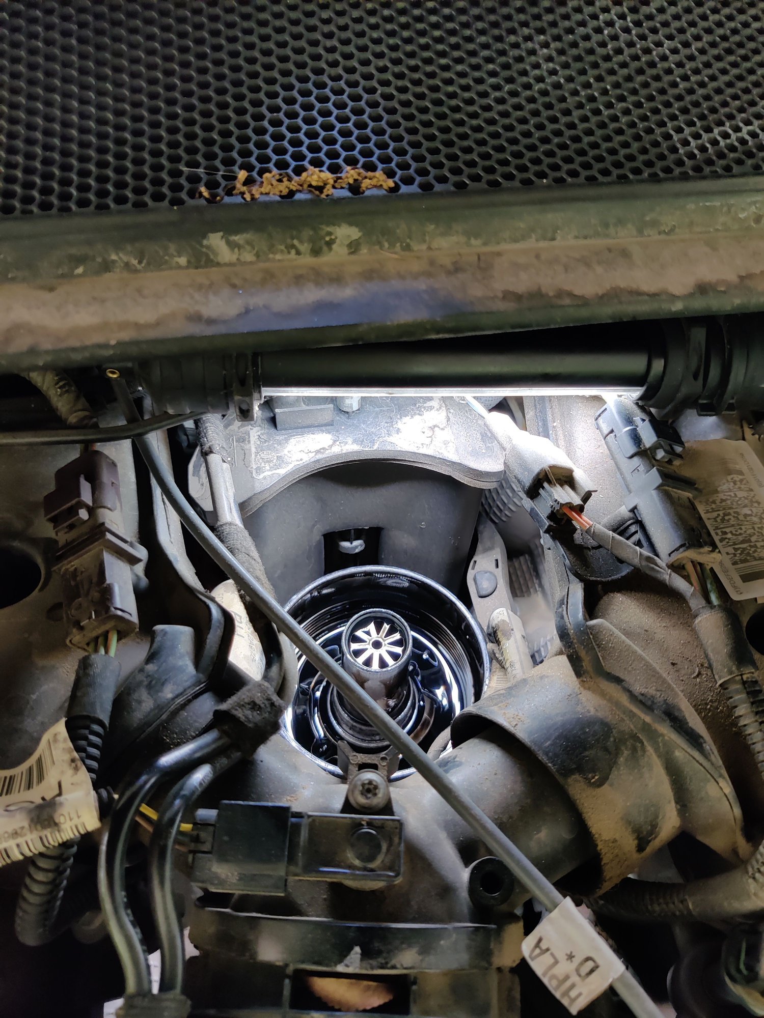

Hey gmfain, what made you decide to clean your DEF injector?
I ask because I keep getting a CEL that I'm sure is regen related. Trouble is, the light will reset after a decent length drive (25-30+mins at highway speeds), but then it will come back on just a few days later. I'll do another long drive, it'll reset....then a few days later, back on.
Wondering if this could be related.
Thx.
I'll be honest, my mechanic told me too every other oil change. I trust him fully. Try it, hopefully it will solve the problem. It's a pretty easy procedure. Just have the extra clamp, as a stand by.
Bosch part # 0-44-021-007 Injector Clamp, pretty universal for DEF https://www.carparts.com/intake-clam...h/bs0444021007

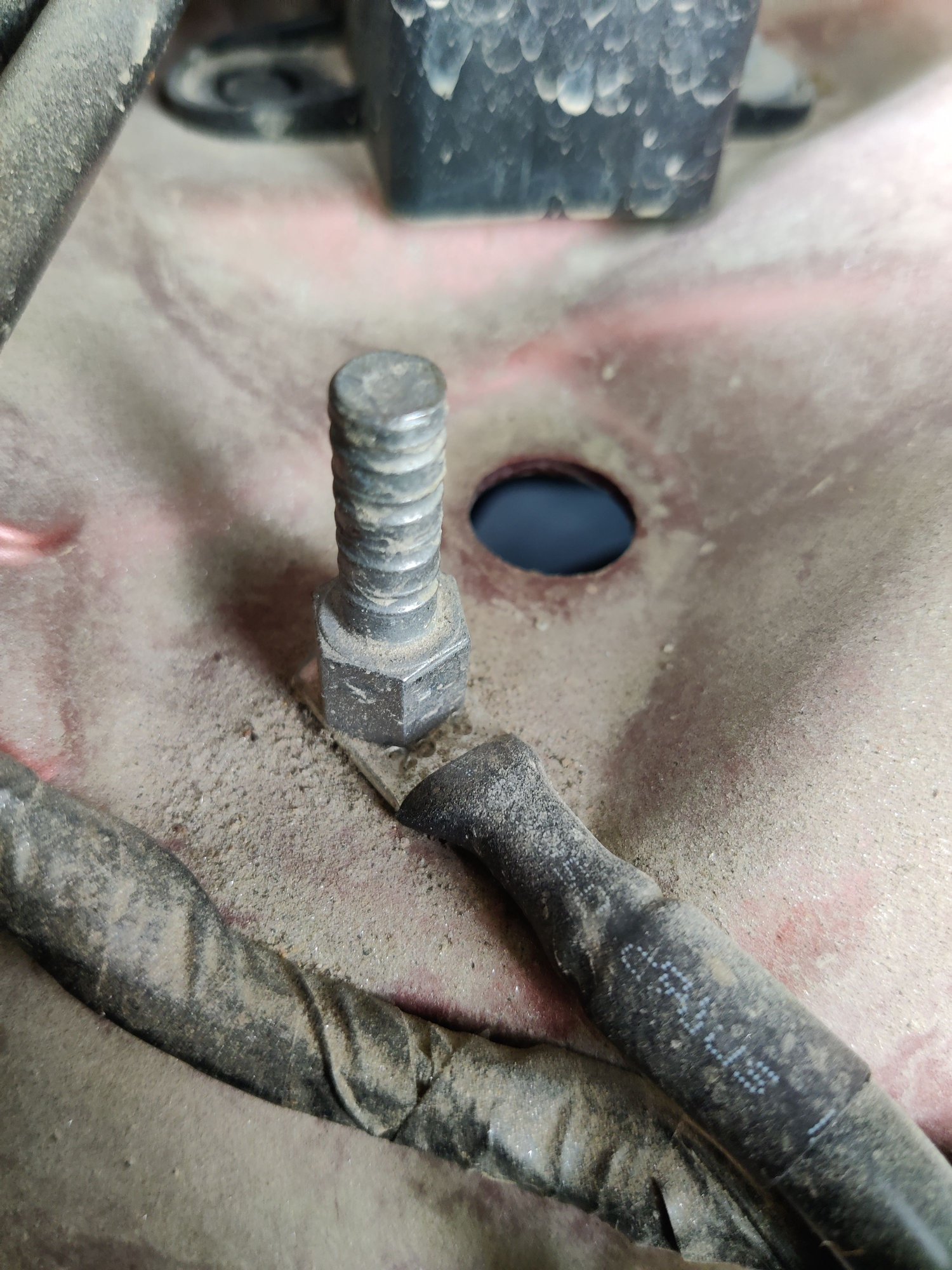

@BchBum11511 Here are a few pics of winch connections. For the positive, remove the two 5mm bolts, and notch the plastic, and mount underneath. Sorry you can see it. clearly.
Negative, just clean it well, don't over torque it.
top view positive
side view, "+" marker it lead from winch.

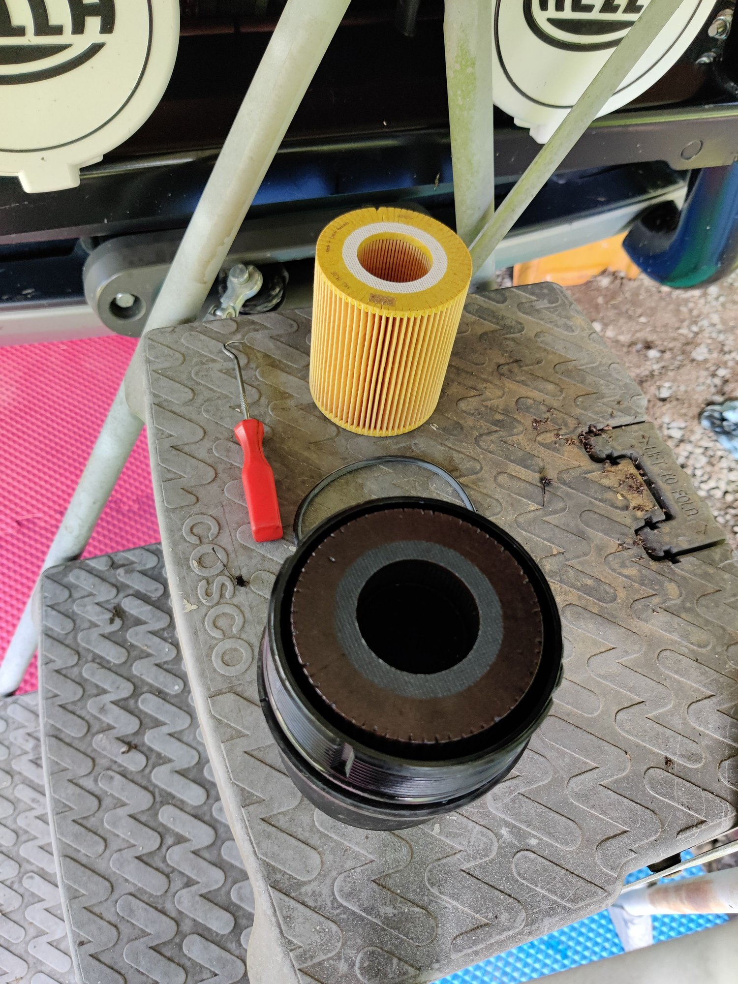

Took some random shots of my oil change.
skid plate dry
drain plug, plus yo can see where the tube from the top terminates.
with muddy hoses, leaks show up easy.
filter
closer filter location
wider filter location
Mobil 1 ESP 5w-30 6.3 quarts
