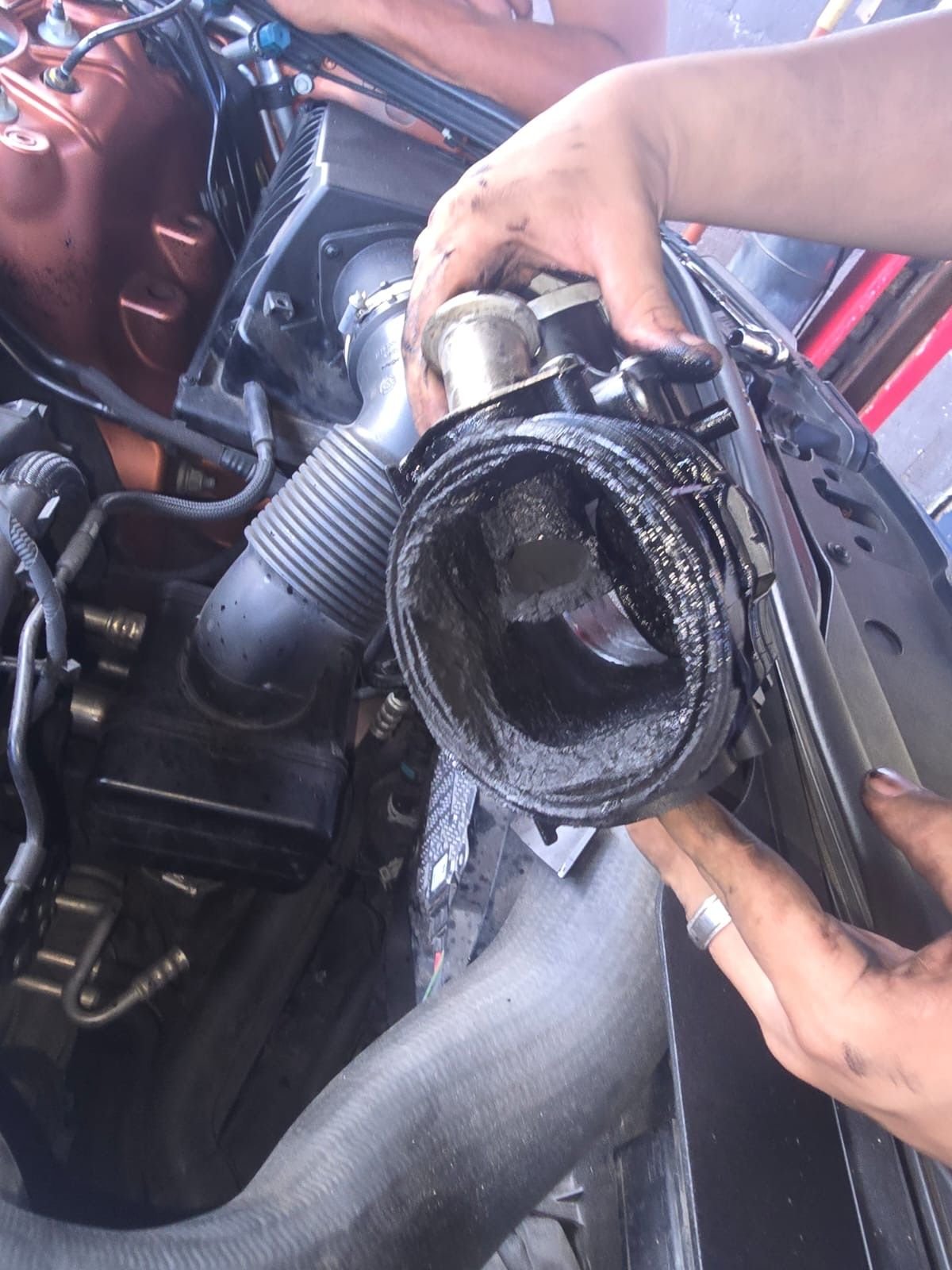

I'd start by checking the air filter, cleaning the MAP sensor, and inspecting the throttle body and intake for restriction. With a gutted DPF like you had, anything and everything can be clogged up with diesel exhaust soot. At one point before my DPF went I had a turbo slow boost error and the intake was clogged down to about 1" diameter at the worst point.

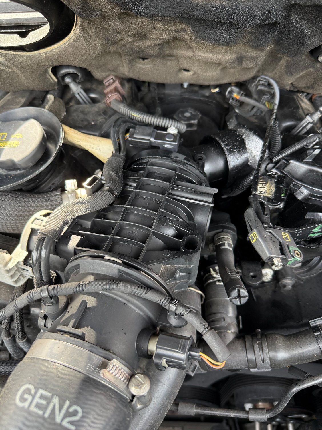

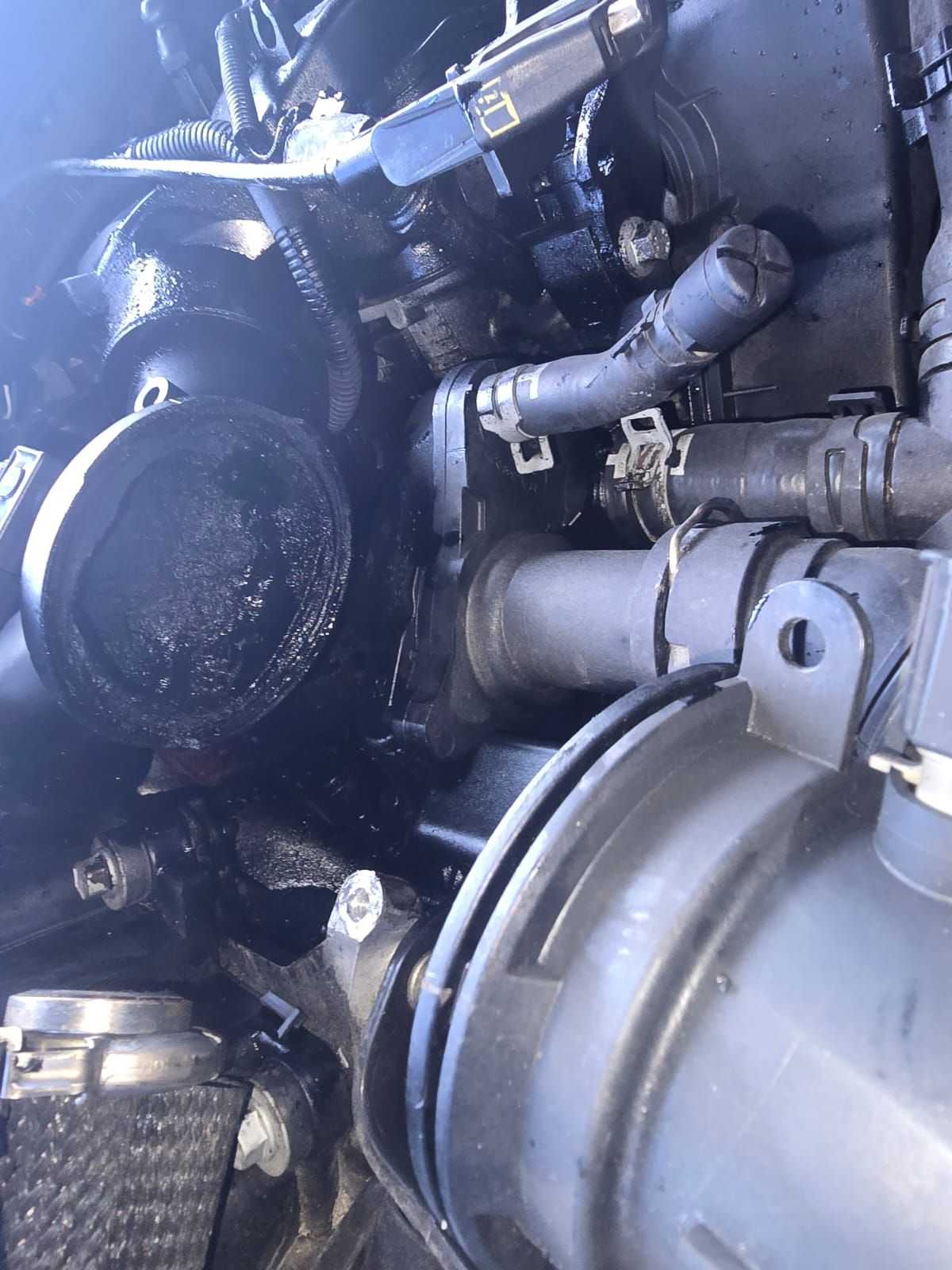

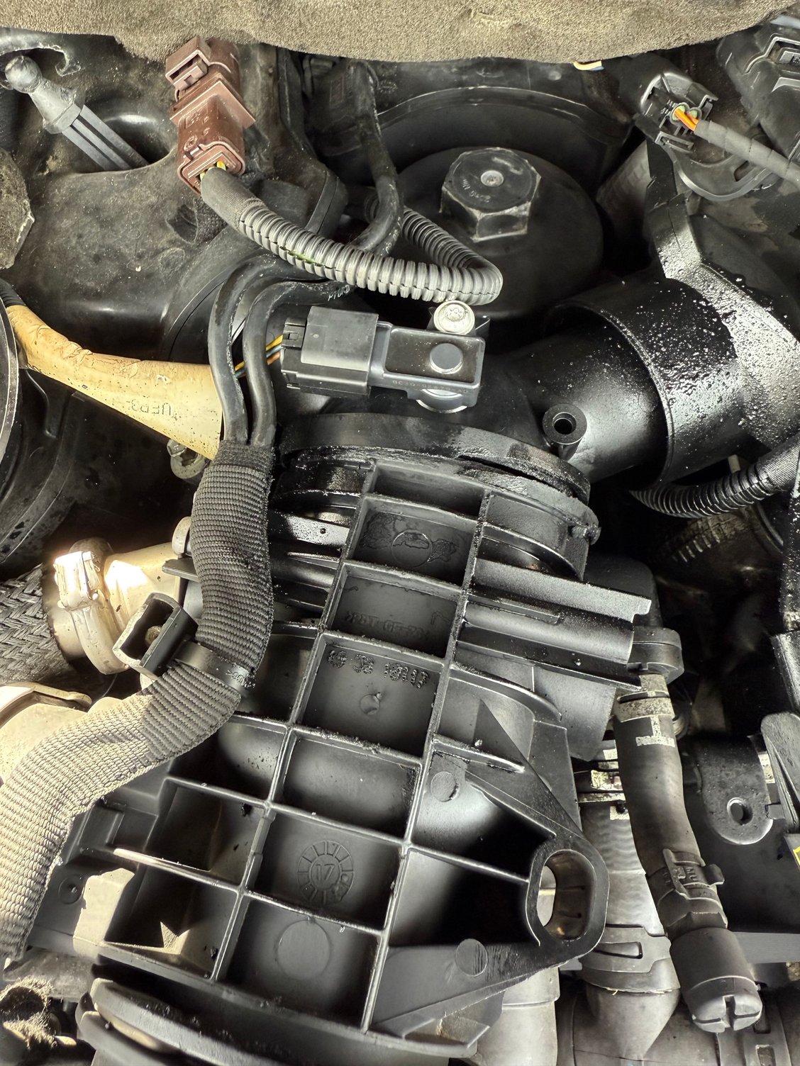

Broken Throttle Body
I wonder what would've caused that intake to fracture in such a way. I would hope someone rested on it or bumped it hard trying to service it. Maybe during an oil change?

Tech trying to solve with a metal piece so I can move the car. Throttle needs to be OEM or there are any good brand to buy?
That's probably a Land Rover only part. Probably get by with JB Weld or a good 2 part epoxy to get you going. Assuming it can get cleaned well enough
