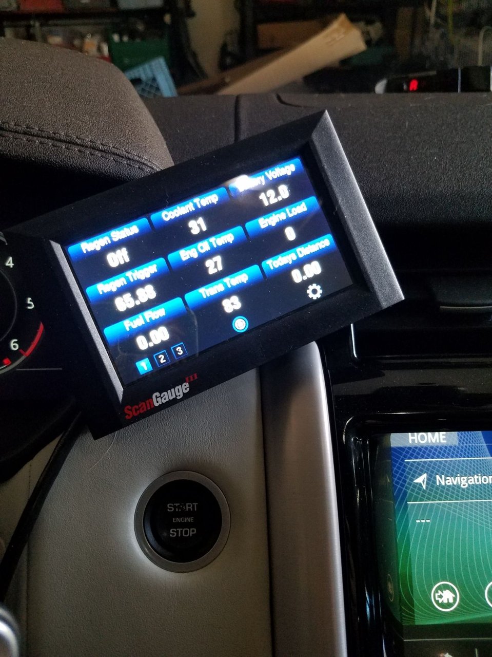

This is page 1 and 3 from my scanner. As you can see, you can program lot of gauges on it. I also have SG2, who I bought like 20 years ago, but SG3 beats it in display hands down.
You can't just "go and buy" the gauge. Nobody stocks it, so it is internet order only. Check your local Autopart for occasional coupons, as I often get 20% off.
Seem all sellers have $300 price, so coupon is the only discount you can get.
