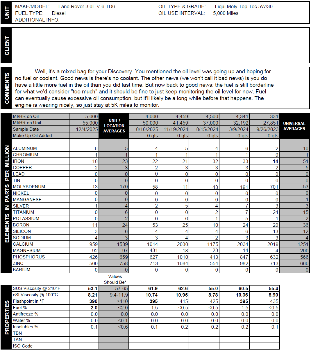

Old Jan 2, 2026 | 09:29 AM
  #46
adam5's Avatar
Joined: Nov 2021
Posts: 215
Likes: 131
From: Southern CA
Liqui Moly Top Tec 5W/30 + PS Diesel Kleen
UOA @55k (I now have a lot more stop/go traffic on the freeway, so that might be the reason for a higher fuel level in the oil)
The motor is now on Liqui Moly Special Tec AA 5W/40
Next UOA should be at 60k
Old Jan 2, 2026 | 09:57 AM
  #47
Kajtek1's Avatar
Joined: Aug 2024
Posts: 63
Likes: 22
From: VEGAS
Frankly I am quite disappointed how Liqui Moly wears.
When fuel dilution might be 1 thing, the flash point and other parameters are pretty poor as well and all that for low mileage on oil.
Similarly on other forum a fellow member posted results for Valvoline oil and that was disappointment as well.
So at this point, the Motul X-Clean EFE 5W/30 seems to be unbeatable oil for modern diesels.
I do have report on it after making 10,000 miles on my Mercedes Bluetec, if somebody would like to compare, but don't want to flood this forum with other brands comparison.
Bottom line, for me there is Motul hands down.
