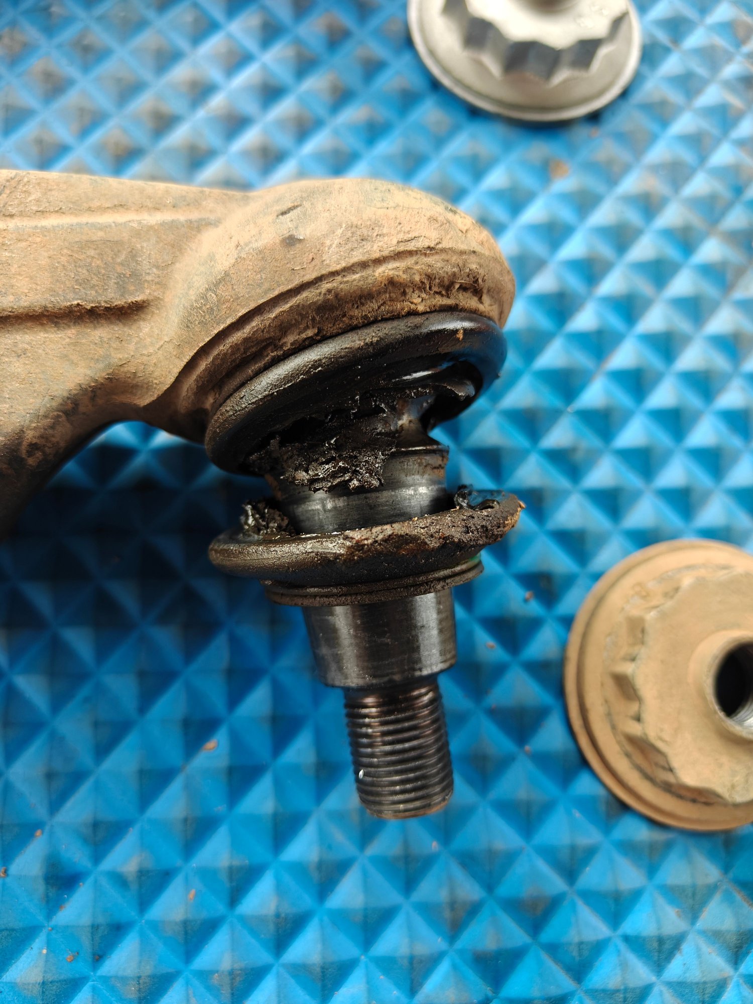

old vs new
old vs new
joint was still tight, boot split and started squeaking, no lube

Originally Posted by bkjecu94
Regular wear and tear or trail damage? Thank you for sharing. kj
Seems to me the rubber boot failed ( probably age), started squeaking from lack of grease.
The ball joint itself was perfectly tight, just lost its lube.
I try to inspect all the rubber during oil change time. I missed it.
