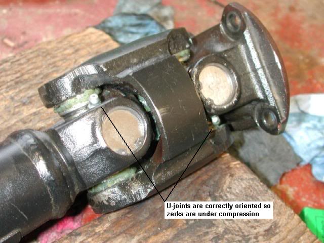

This is the spot where grease fittings need to be (stock does not have as many). Plus regular U joints as you mentioned. Hope you don't need hubs, they are kinda one unit Hub Assembly With ABS Sensor (Same Fit As Genuine Part # TAY100060) - Land Rover Parts & Accessories
