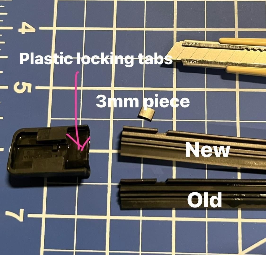

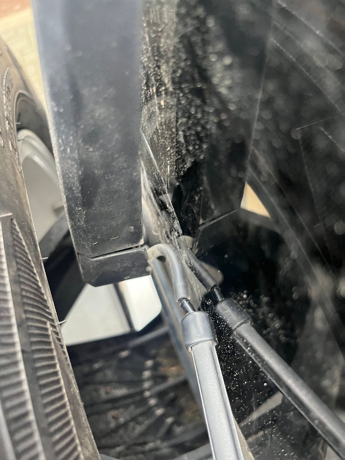

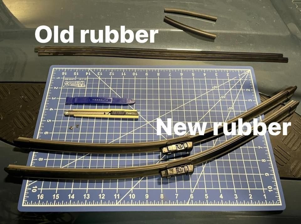

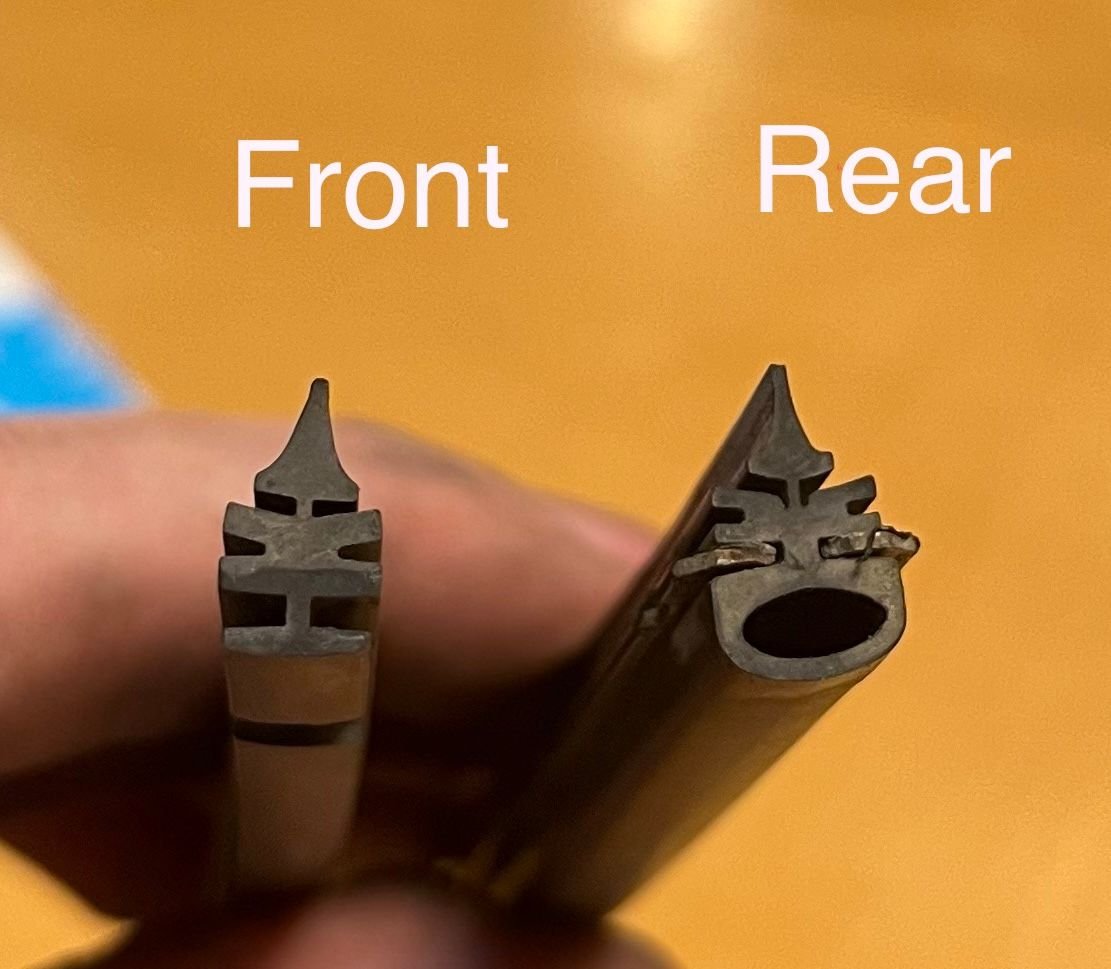

Default Wiper Rubber replacement
Another quick service item
$6 for 4 rubber replacements.

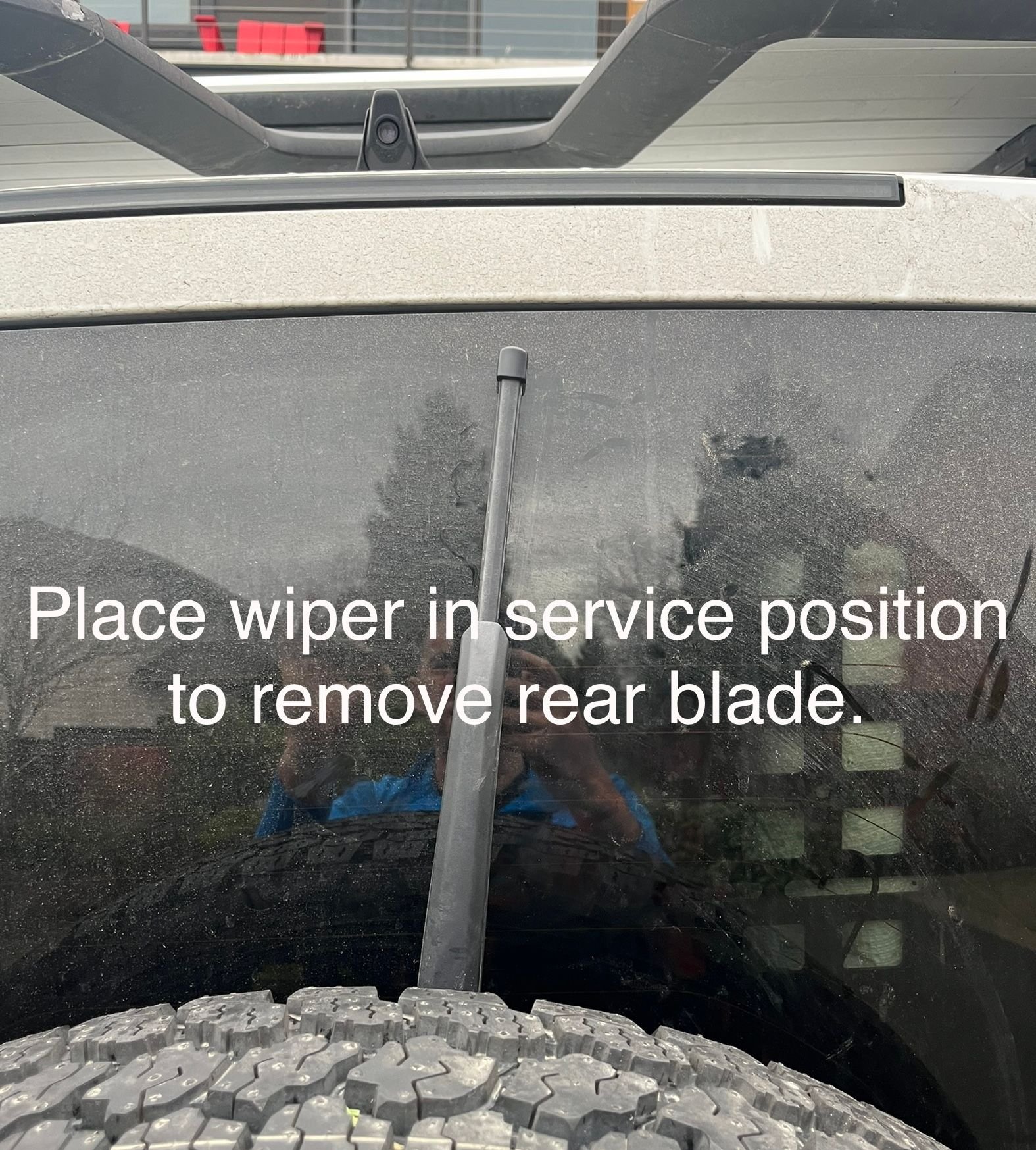

The rear wiper could not be replaced. It gets almost no use anyway so not really a bother.
A few minutes to remove old and replace with new

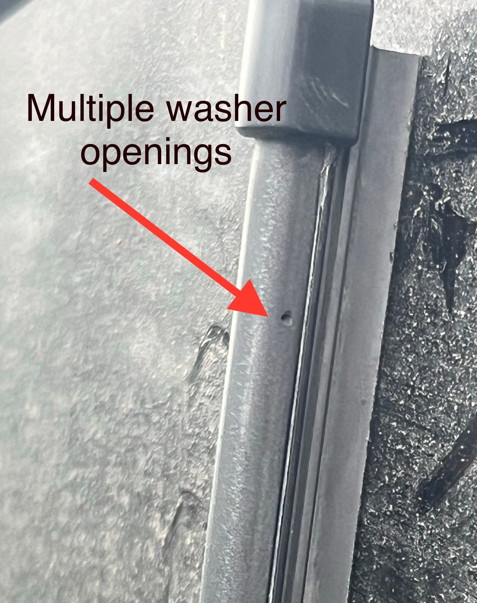

Rear wiper rubber serves as it’s own washer jet.
Activate service mode to remove blade.
Washer nozzle attaches to base of blade.
Multiple washer jets/pores in blade. Clever.

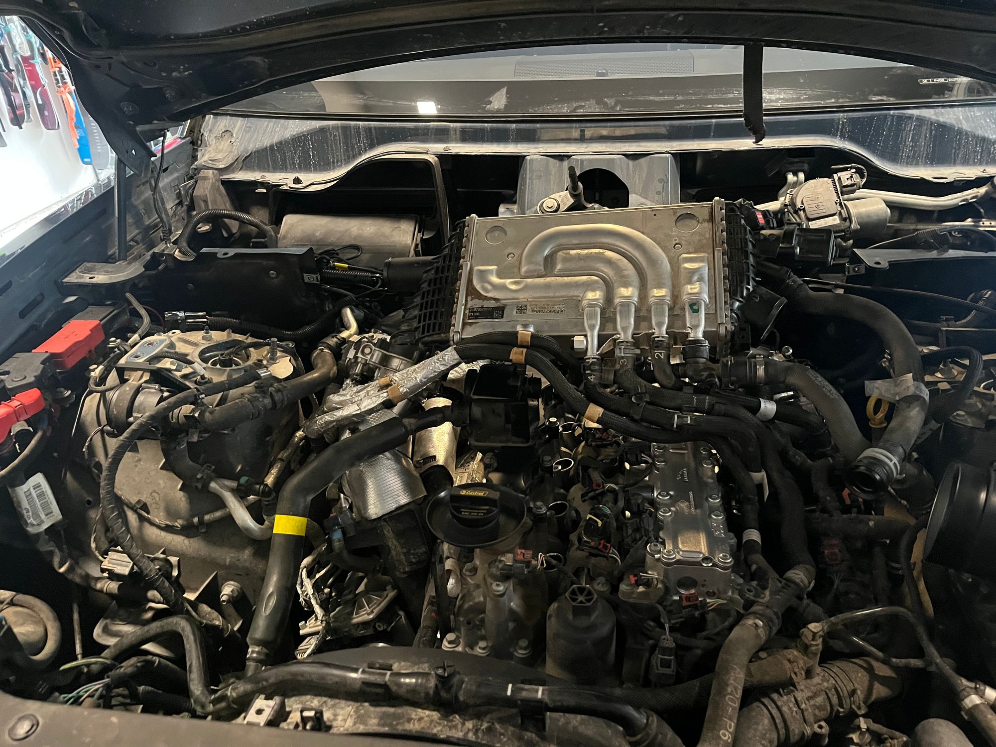

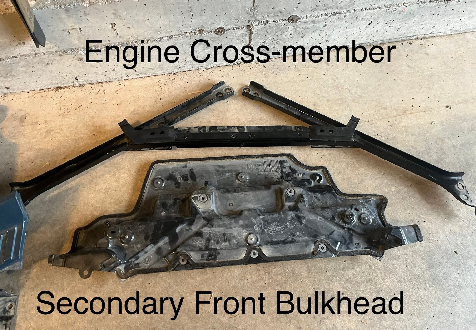

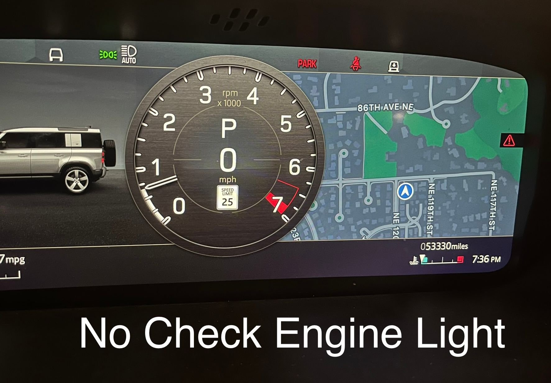

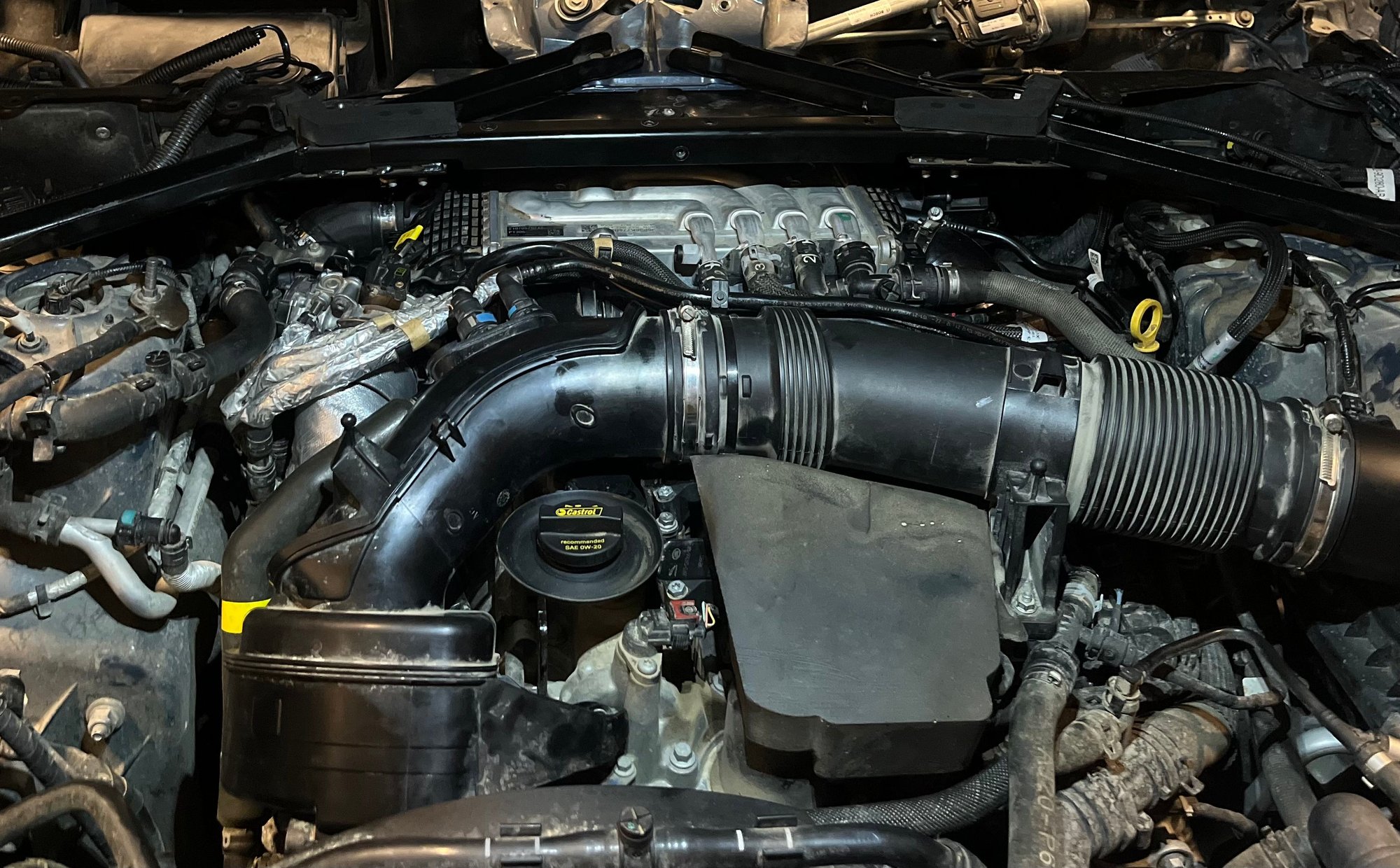

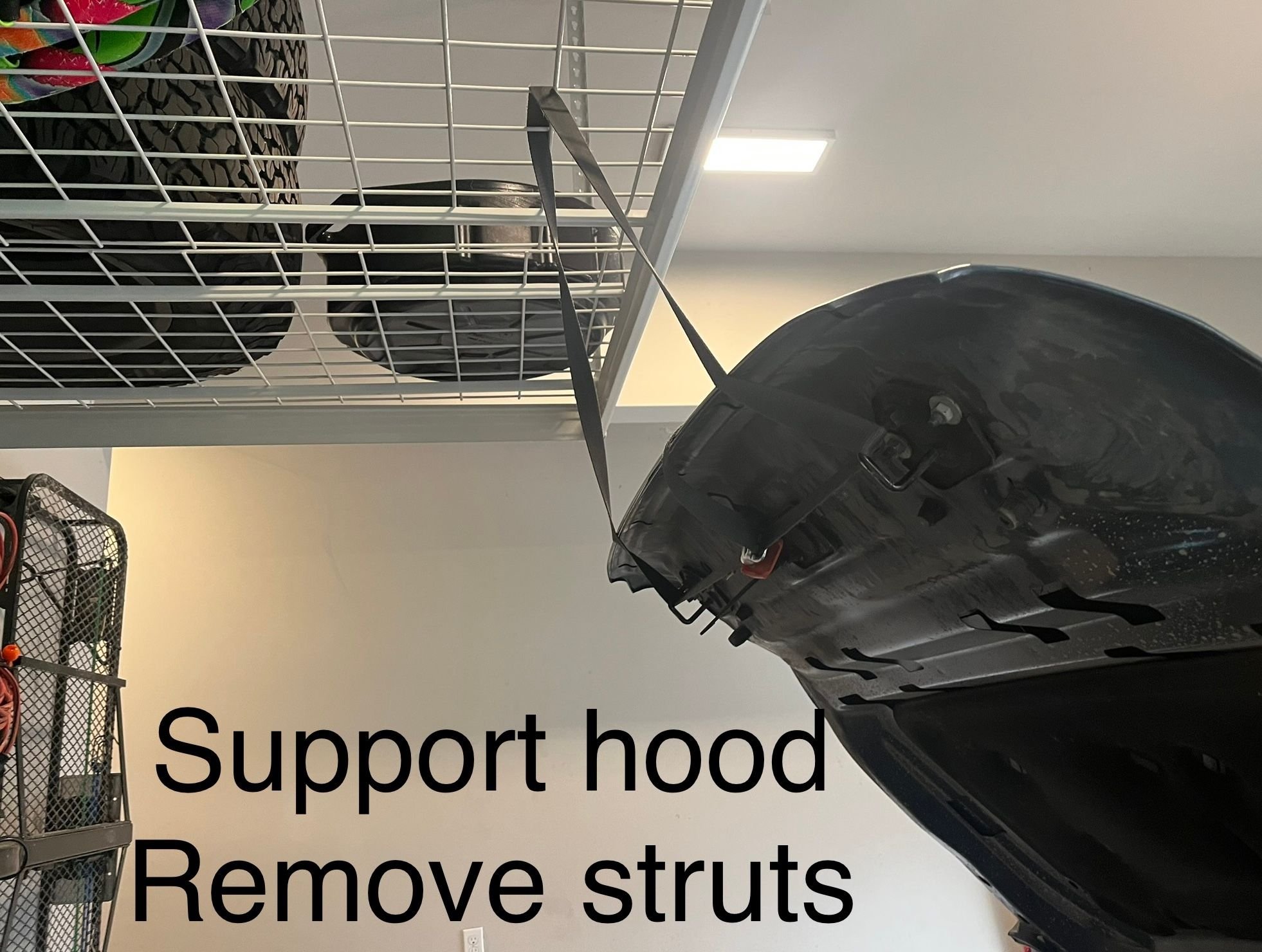

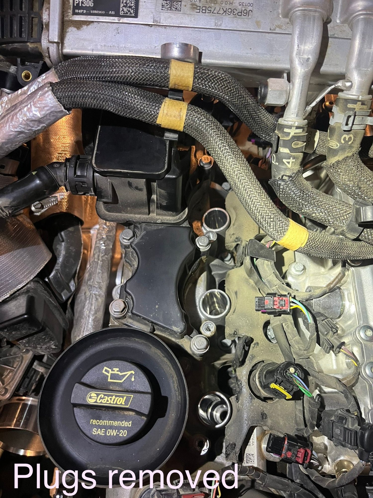

Default P400 Spark Plug Change 53,300 miles
This was a fiendishly difficult job. Broad steps are below. Electrical connectors, clamps, clips, hoses, and factory torque values have been omitted.

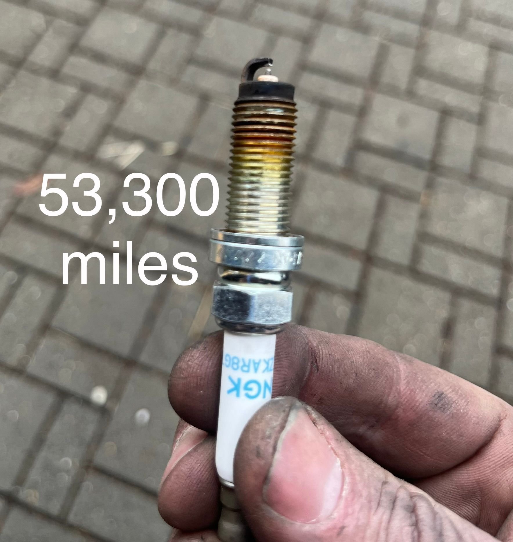

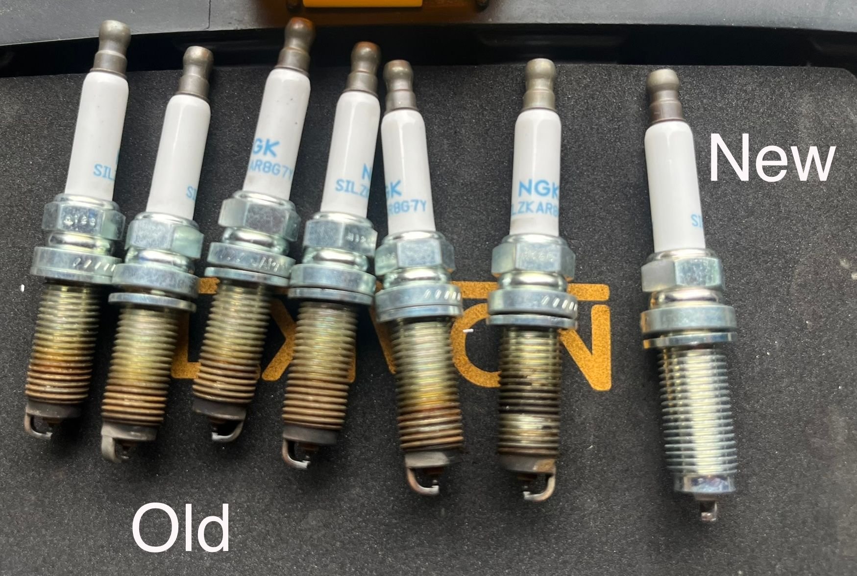

A little earlier than the scheduled maintenance. Use profile may justify doing it earlier than the prescribed 63,000 miles. Seeing the plugs and feeling how they came out, I think this sort of time-frame is reasonable.
Parts needed
6 Spark plugs. I used OEM from Landleaping.com ​​​​​​​
Special tools neededSteps
  • Verify spark plugs are correctly gapped. 0.6-0.65mm. The OEM plugs LR178881 should be correct from factory and should not be adjusted.
  • Disconnect battery
  • Support hood and remove struts
  • Remove Wiper arms and place to side.
  • Remove front cowl

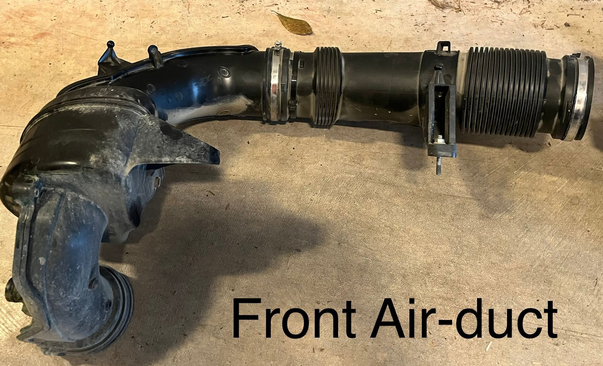

  • Remove Air duct
  • Remove Engine Cross-member
  • Remove Front secondary bulkhead

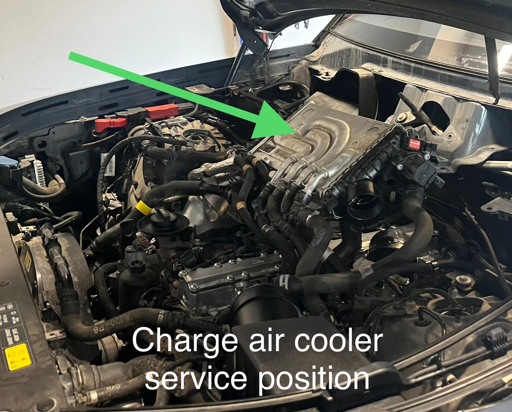

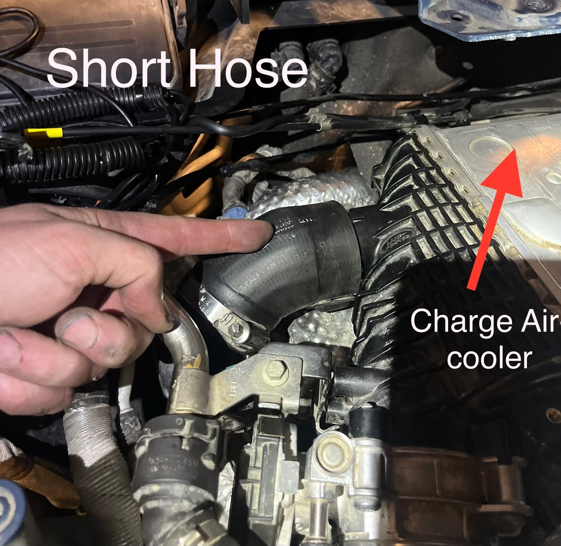

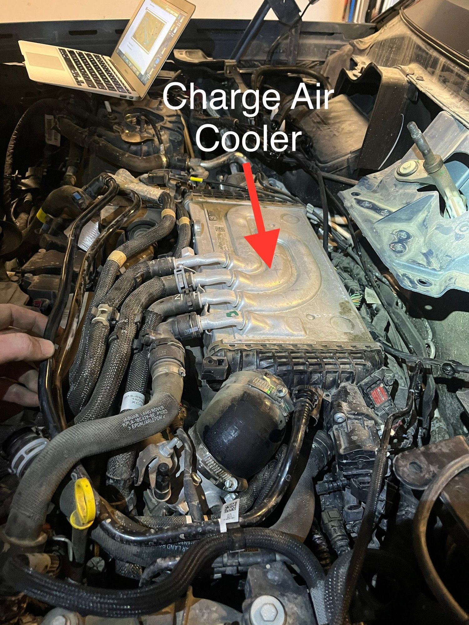

  • Put the Charge air cooler into service position. (This was a nightmarishly difficult step due to the short hoses)
  • Remove ignition coils
  • Remove spark plugs
  • Replace spark plugs with new.
  • Reposition charge air cooler. Again insanely difficult.
  • Replace all the removed stuff in reverse order.
  • Beverage(s)
Looking into the spark plug housing and the cylinder below.
This hose was a nightmare to remove and reattach

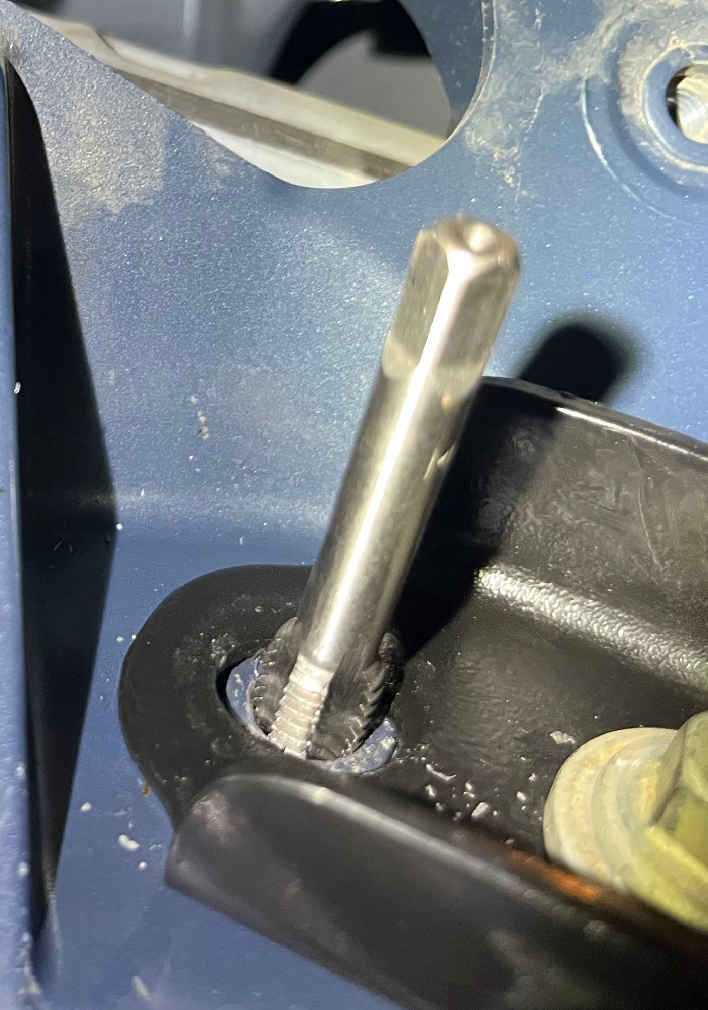

One minor snafu.
A cross-threaded bolt in the engine crossmember.
This is likely from before courtesy of my dealership. I will need to re-tap that thread and torque it down. M10 55Nm on the bolt.
Everything else torqued to spec. A few unused clips in the engine bay and some missing bolts I replaced now in use again. (Another of my dealer’s signatures.)

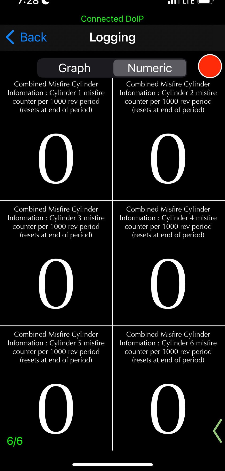

GAP tool to read for any misfires today. It would appear all is in order.

Well done! Hopefully before I get to 60k someone will post a more in-depth video of that short cooler hose with some tips and tricks!
Old Dec 30, 2024 | 04:01 PM
  #117
GavinC's Avatar
Joined: May 2021
Posts: 2,570
Likes: 3,647
From: Kirkland WA
Yeah I'd love to know how better to remove and reattach it. Some sort of hose removal tool if one exists would be the right job. There are two others that were tricky too but this one was a real bear.

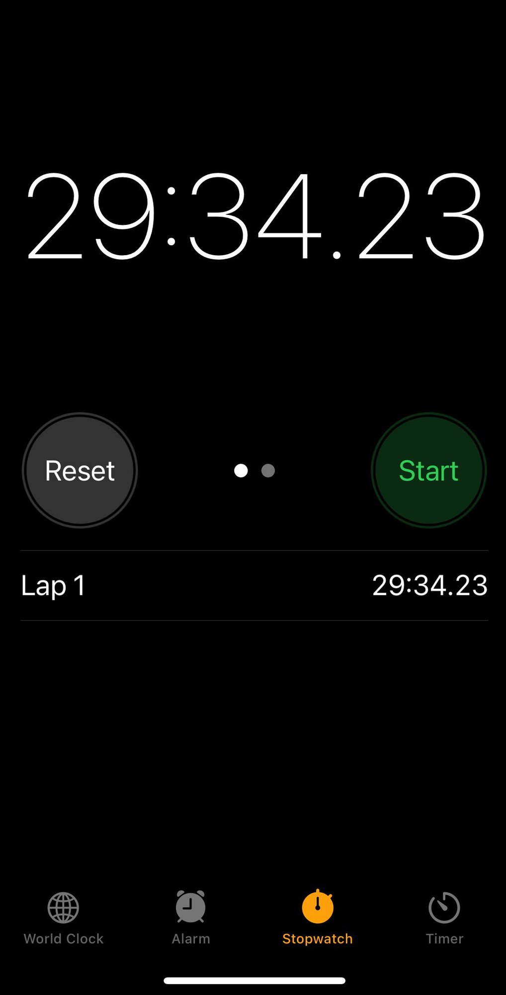

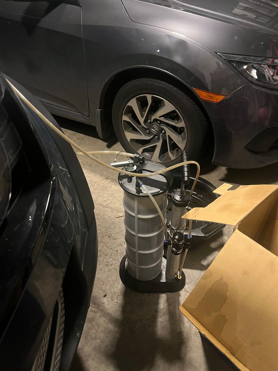

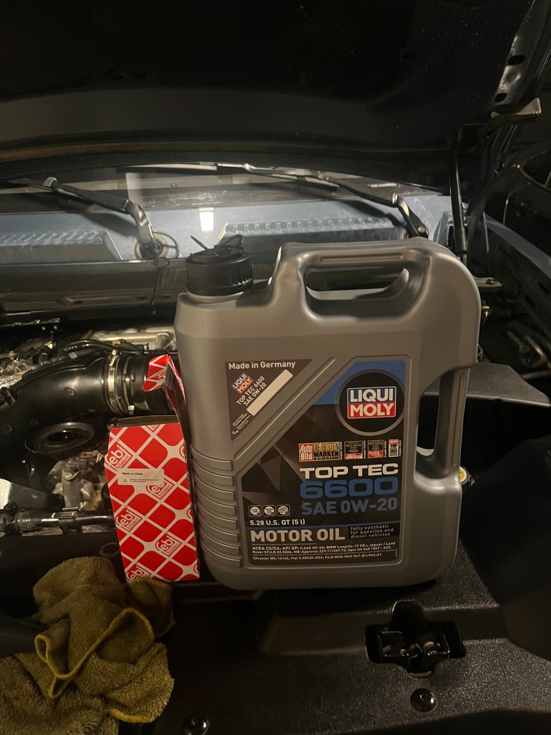

Default 54,400 oil and filter change
Routine little task for a Friday evening.
30 minutes to completing tidy up and having oil ready for disposal.
simple as you’d like.
Recut the thread for the M10 bolt cross threaded at an earlier time. Engine cross member. Recut an M10 bolt I had from the AC armor to match. All good again.
