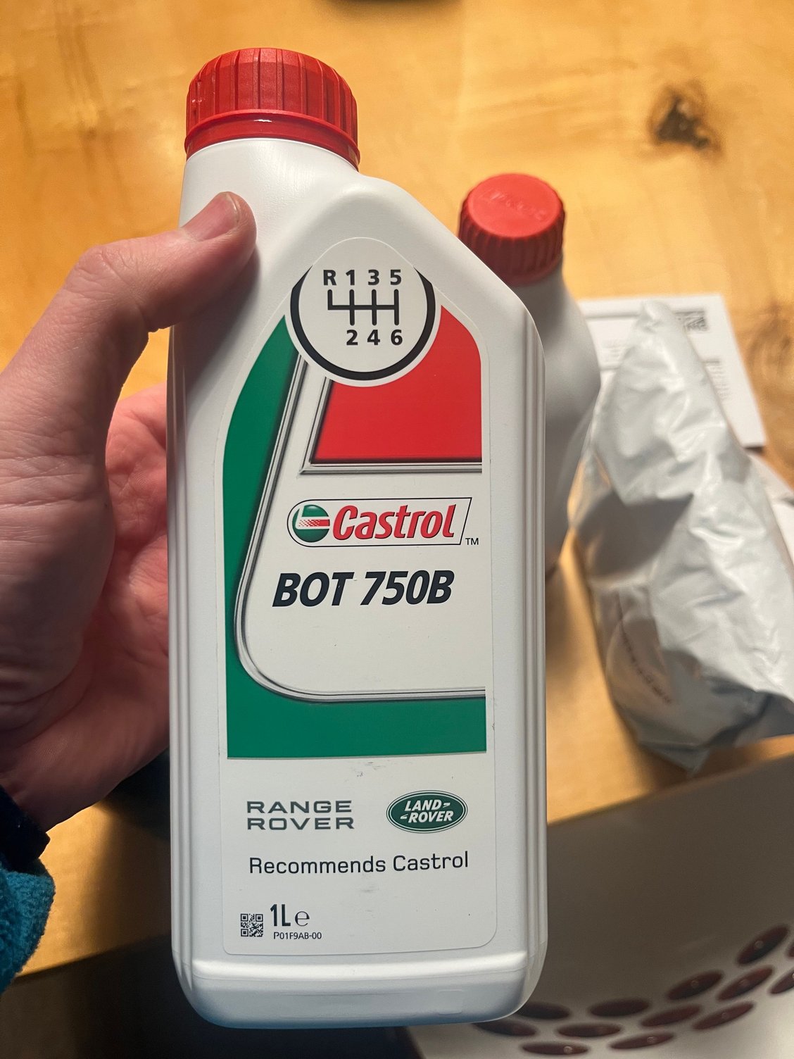

Supplies acquired for the front diff drain and fill.
2 liters for about $110
New drain and fill plugs too.
landleaping.com were very helpful in making sure I got the right oil. Highly recommended.

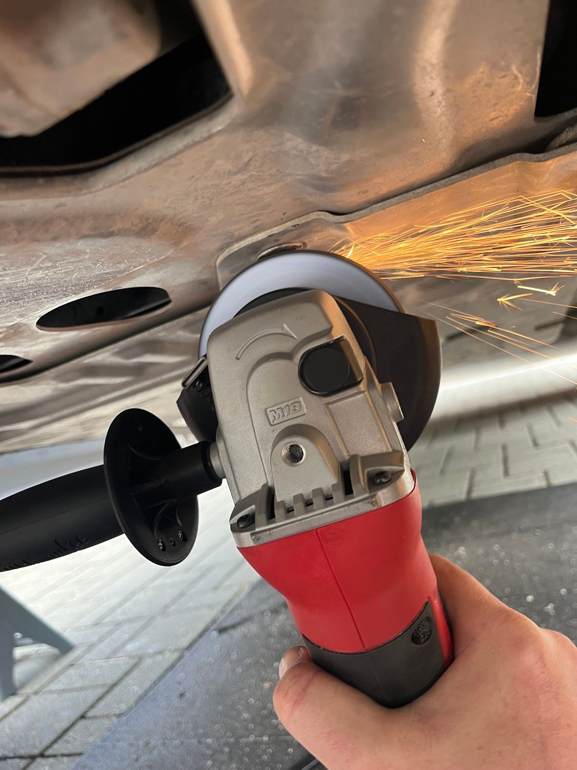

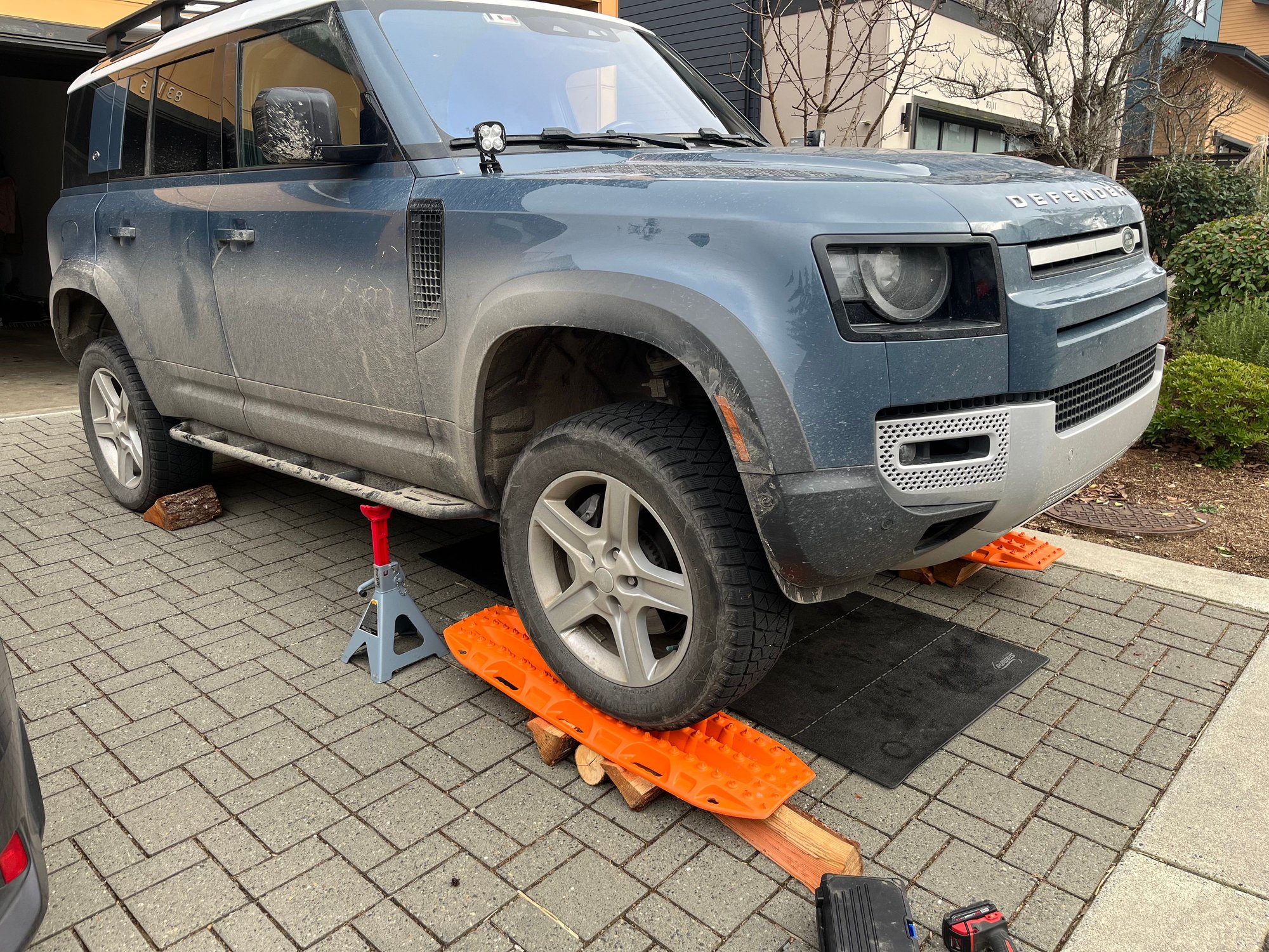

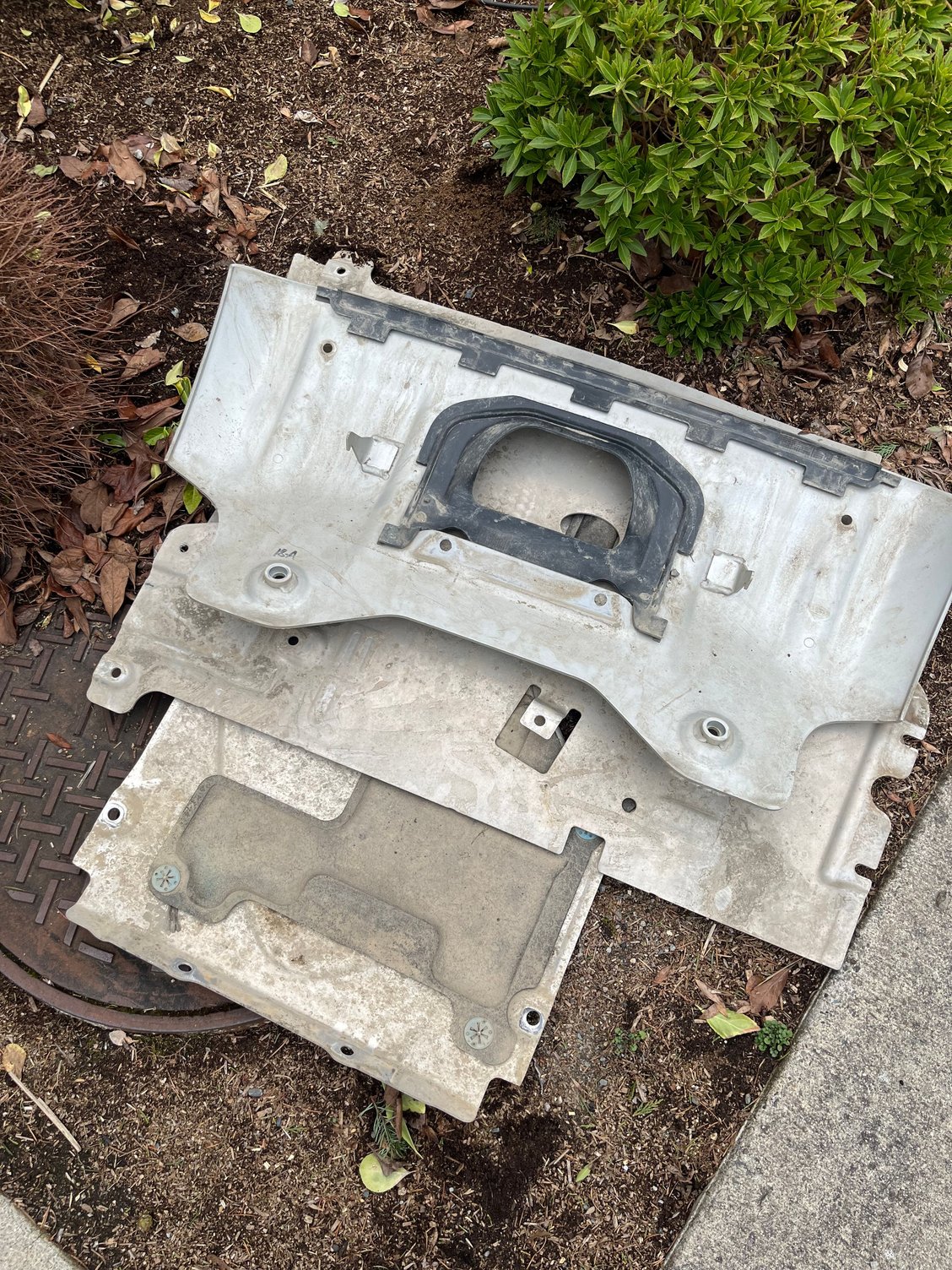

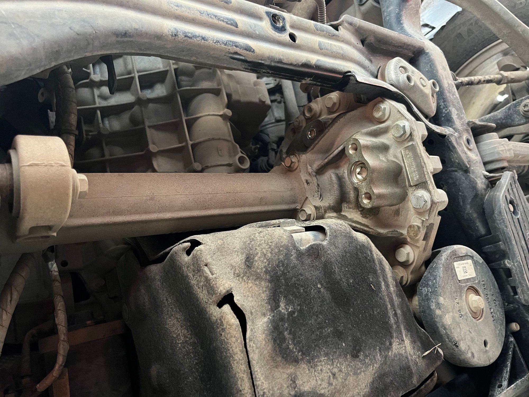

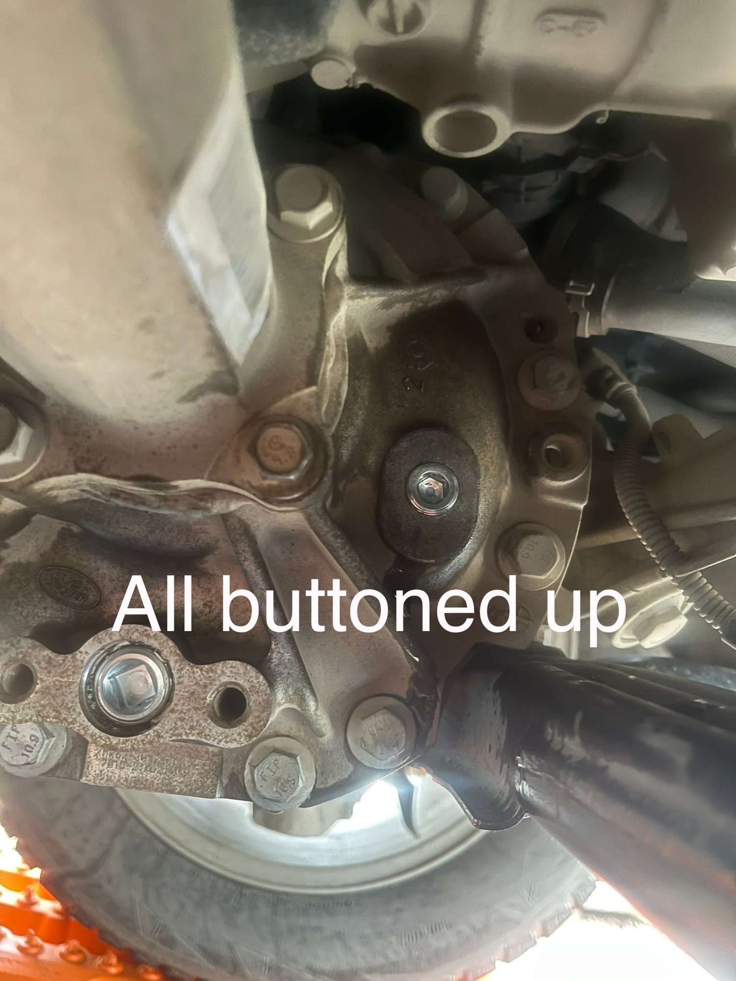

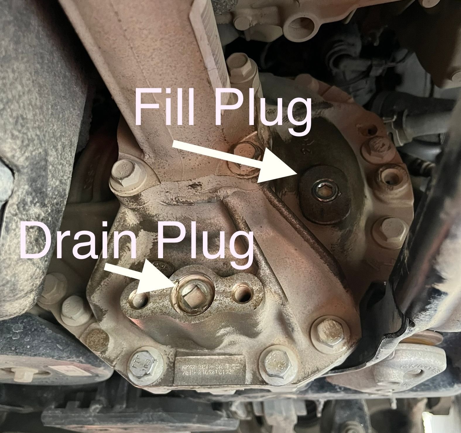

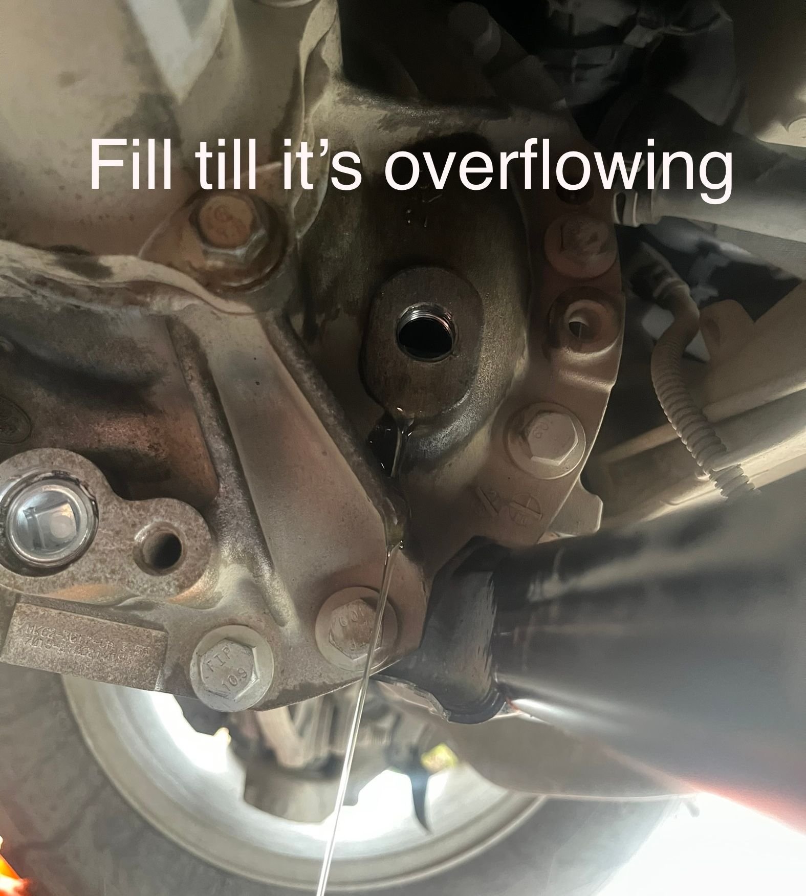

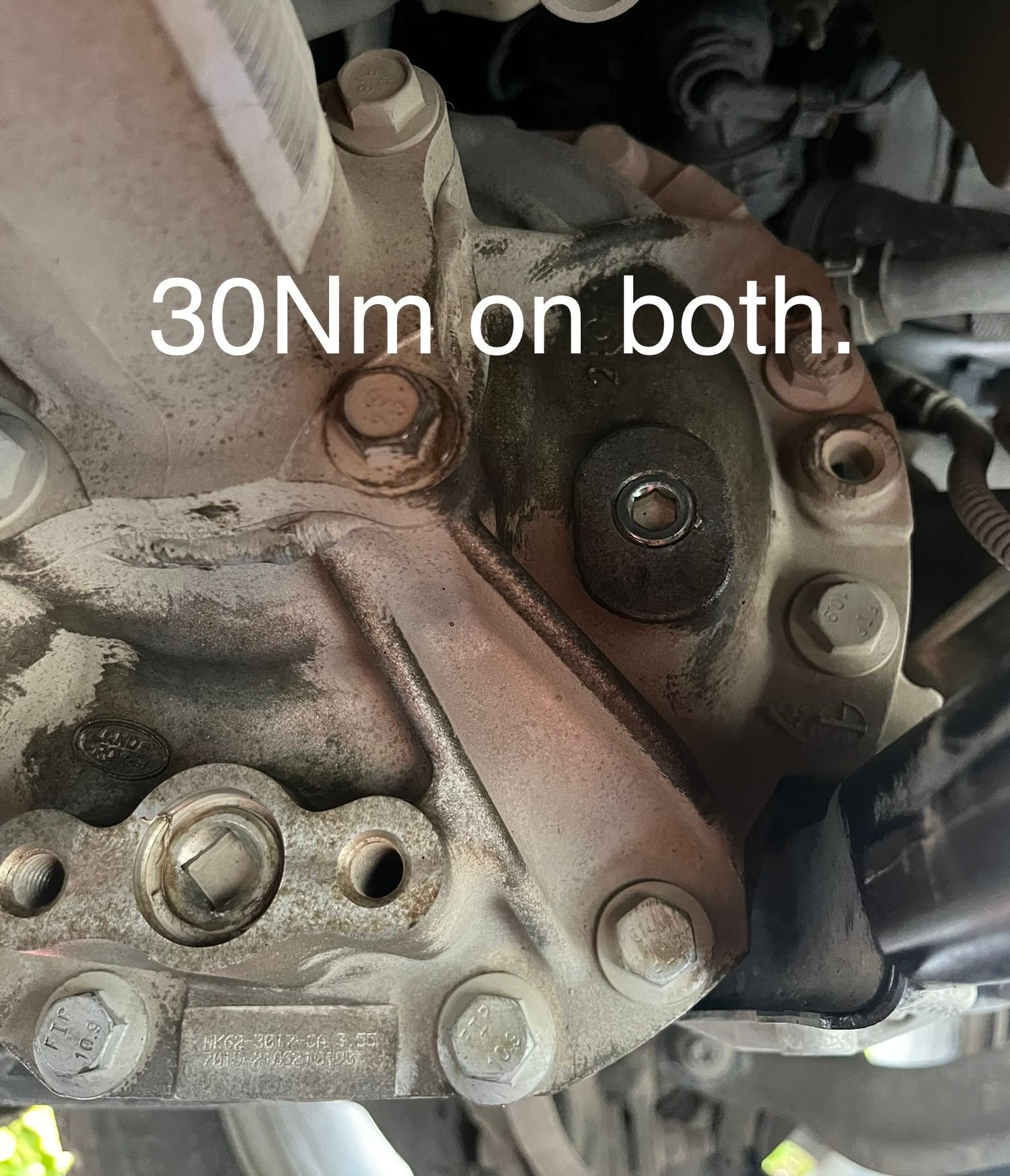

Default Front Differential Drain and Fill. Defender 58000 miles
Only needed 1liter of diff oil.
A simple job bracketed by the hassles of under armor having a bolt shear its captured nut.
