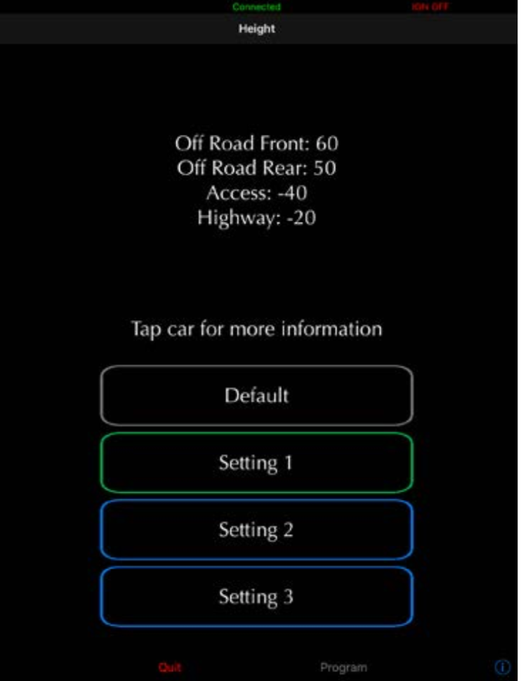

Thank you, I am aware of llams. It’s a lot of hardware to install.
im not even looking to access different heights from OEM. I just want to disable the automatic height change at 50MPH so I can drive around in offroad height if I choose.
was hoping the GAP tool has this since I already paid for it!
Old Jun 17, 2024 | 01:54 PM
  #286
stevemfr's Avatar
Joined: Sep 2022
Posts: 159
Likes: 185
Unfortunately, while we even have a method to allow off-road height to be run at any speed, we're not going to implement it due to liability issues. You can simply change the vehicles height with the IIDTool, though. If you add 75mm you'll effectively be at off-road height at standard height, tho you might run into issues if you then try to go into off-road height and in off-road, you'd have very little suspension droop left (downward movement of the suspension). Our Ozzie customers often add a few cm's (3-4) for long drives in the outback. That way you're keeping the cg sane as well.
Llams provides a quick way to change heights (the twist of a ****) but requires an install - and, if you already have an IIDTool (or plan on buy one) and an additional 40-50 secs, the IIDTool has 3 height memory profiles with which you can change the vehicle's height at the touch of a button. You simply change the height to what you'd like (you can change all or one axle or even one wheel at a time) and save the setting to one of the 3 profiles.
