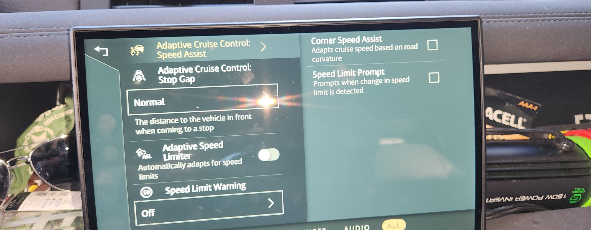

Just got my GAP tool and was looking to progam a new key. But despite updating the software and putting my rig into service mode via the LR app... I don't see any of the standard options under the main menu Service / Test.
Does anyone have experience with this issue and a solution? Here a screen shot of what I'm seeing.
