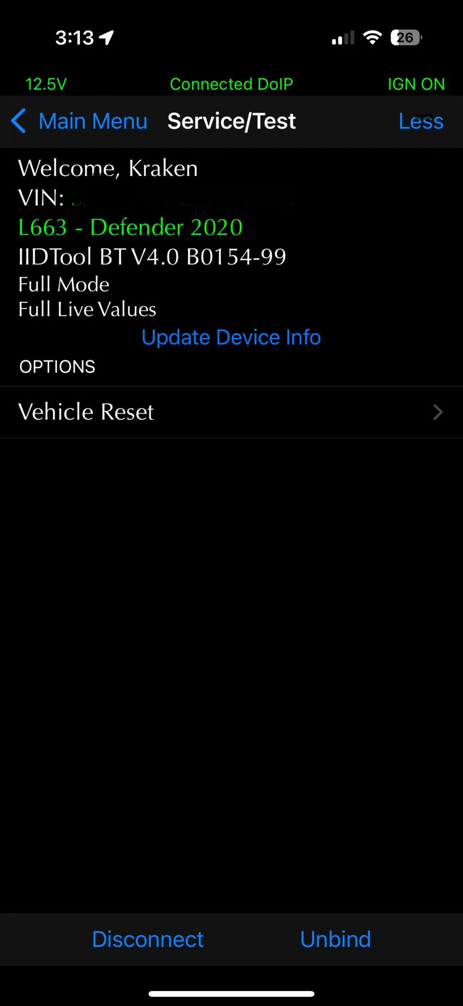

Just got my GAP tool and was looking to progam a new key. But despite updating the software and putting my rig into service mode via the LR app... I don't see any of the standard options under the main menu Service / Test.
Does anyone have experience with this issue and a solution? Here a screen shot of what I'm seeing.
Same issue here. Wanted to test this out with my RTT last night but couldn’t figure it out. I sent the GAP team an email. I have the G4 BT and a 2020 110 P400.

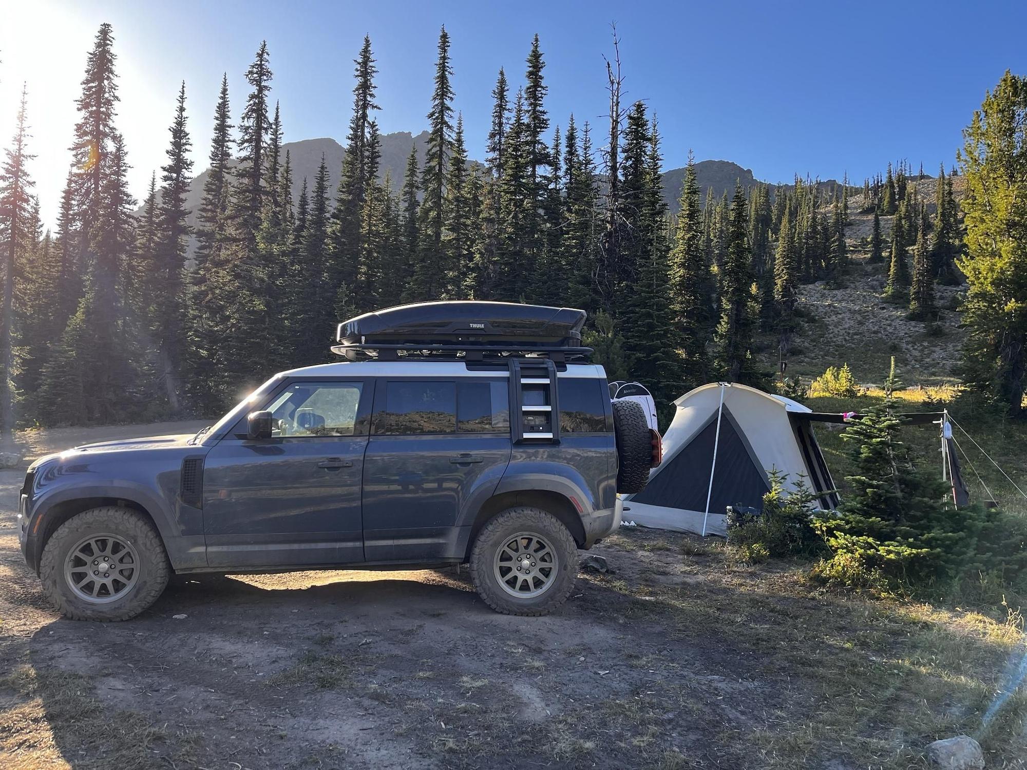

Originally Posted by markjlr
Ok, to camp or greenlaning,
We sleep in the back on camping trips. I disabled the vehicle waking up and the lights coming on or off with solely the tailgate/boot door opening and closing. Now for my regular contributions to the forums:
Multican 703 “BCM interior light trunk” Fitted.
Multican 703 BCMinterior light delay” Fitted. Immediately turns out all vehicle lights without a 30 second delay.
So the 1st one stops ALL vehicle lights when trunk/boot door is opened or shut.
The 2nd one immediately stops the lights when any of the 4 passenger doors are opened because our vehicles are set for a 30 second delay which drains the battery.
Haven't finished reading the whole thread yet, but do these settings stop the vehicle from firing up all the electronics everytime door is opened? RTT is on order and planning to do a bunch of configuration changes this weekend. A bit nervous for my first time out camping in the woods resulting in a low voltage / dead vehicle .. doh!
Are there configuration changes / is there a way to stop the Defender from booting up everytime a door is opened while camping?
Old Jan 22, 2025 | 06:55 PM
  #396
GavinC's Avatar
Joined: May 2021
Posts: 2,593
Likes: 3,692
From: Kirkland WA
Yes. It's dead simple. Leave 1 door cracked. Car will shut down and stay shut down. You can open and close all the doors to your hearts desire. The car will not fire back up. At night when you're bedding down, close the door (or not) and lock up (or not). When camping remote I leave the door cracked and lock it last thing. More to keep bears away from food in the car. Never had any power related issues camping. Zero.
