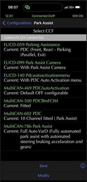

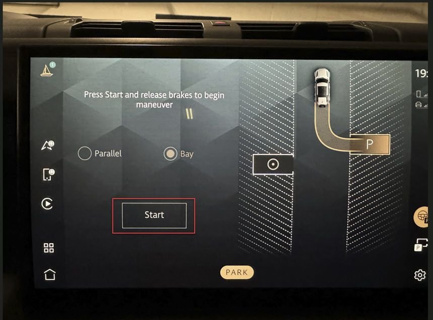

Originally Posted by Phil McCracken
Can someone smarter than me review what I am doing wrong. I have successfully enabled a number of features using the GAP tool however I am having an issue with the park assist.
I have enabled the following features:
After a few reboots it shows up on the screen and I can select the parking space however the Start button is greyed out (although it doesn't look like it it in the image)
I release the brake and attempt to click on start however it does nothing. Has anyone else encountered this issue and if so, how did you resolve it?
I'm running a 2023.5 X with software 4.2.0
Has anybody got it to work on models 2023 or newer? Why start button is grayed out? Is there some change in technology between newer and older models?
You are stuck right where the rest of us are stuck. All we need is for that little start button to light up, but we haven't figured out how to do it yet.
