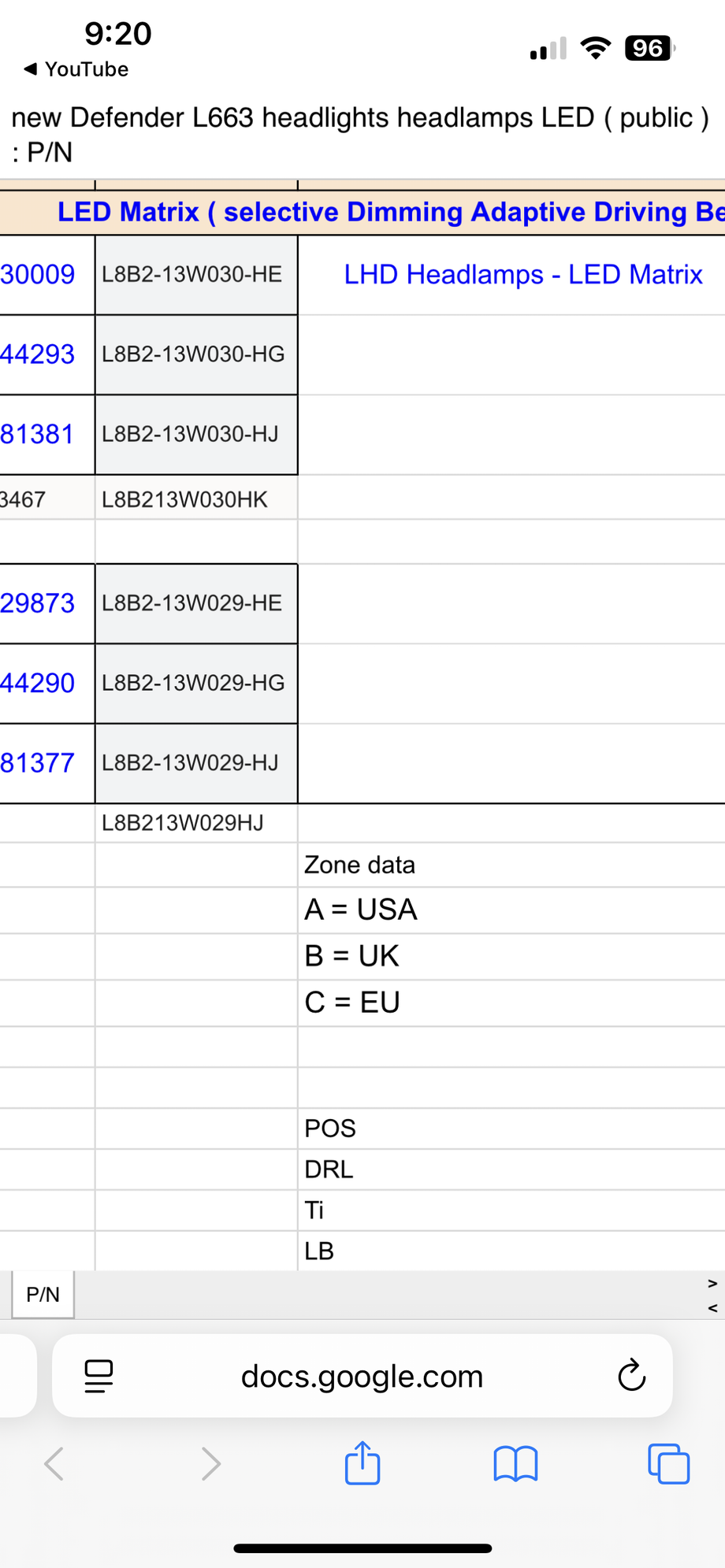

PetarJ posted that up above as he did the retrofit and got his matrix headlights working on his US defender. Sounds like he worked with Patrick at GAP to find all the things that needed to be changed.
Simon at powerful II also has a document on defender headlights which also includes this snipit, check out the “zone data”
Simons defender headlight spreadsheet

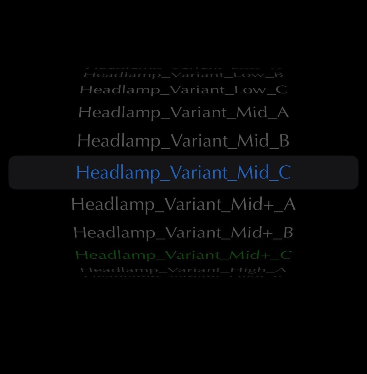

Nice doc file, thanks, it's very helpful with postfixes and those regions. Regarding zones it's quite weird because Headlamp_Variant_MID_C did nor for my with EU lamps with postfix EB (DOP - 2021) but with Headlamp_Variant_MID_C+ works

Do you have LED Premium or LED Matrix headlamps ?
LED Premium as Matrix was not allowed to get in US in 2020
Old Nov 6, 2025 | 12:44 PM
  #555
PetarJ's Avatar
Joined: Jul 2025
Posts: 12
Likes: 8
Headlamp_Variant_MID = LED Premium
Headlamp_Variant_MID_C+ = "Laser" or at least that's what was visible in the ADB menu
Old Nov 6, 2025 | 12:57 PM
  #556
Zamordysta's Avatar
7th Gear
Joined: Oct 2025
Posts: 7
Headlamp_Variant_MID_C+ = "Laser" or at least that's what visible in the ADB menu
As you can see at the bottom I have mid+ c (green) and it works fine. I used to have mid c (blue) and I had problemu with indicators.
I my opinion laser matrix lamps are high variant.
