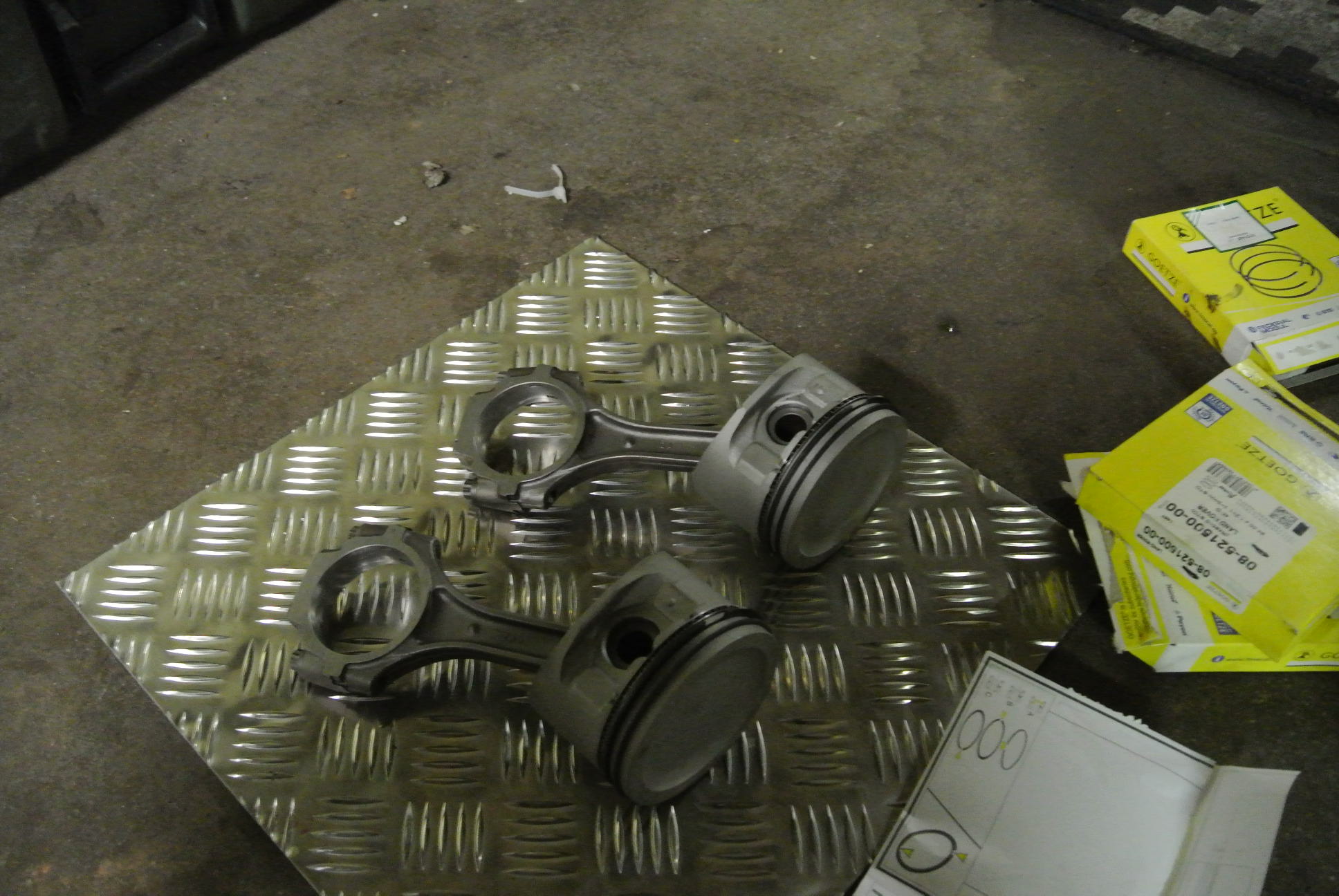

stuck in the pistons tonight. big end caps are 15ftlbs + 80 degrees. nothing big here. make sure to lube sides if the ends and caps, as well as the bearing.
ring gaps I referenced earlier, but should mention that only compression ring 2 has a top orientation. writing on 1 and 2, but 2 has a top reference.
