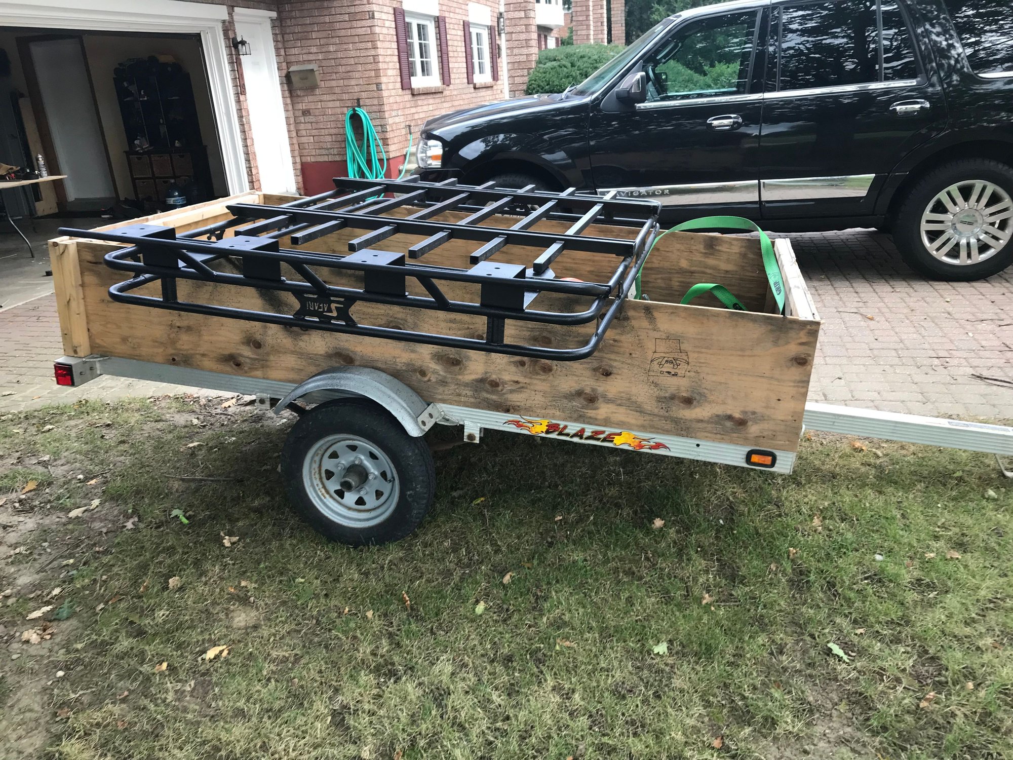

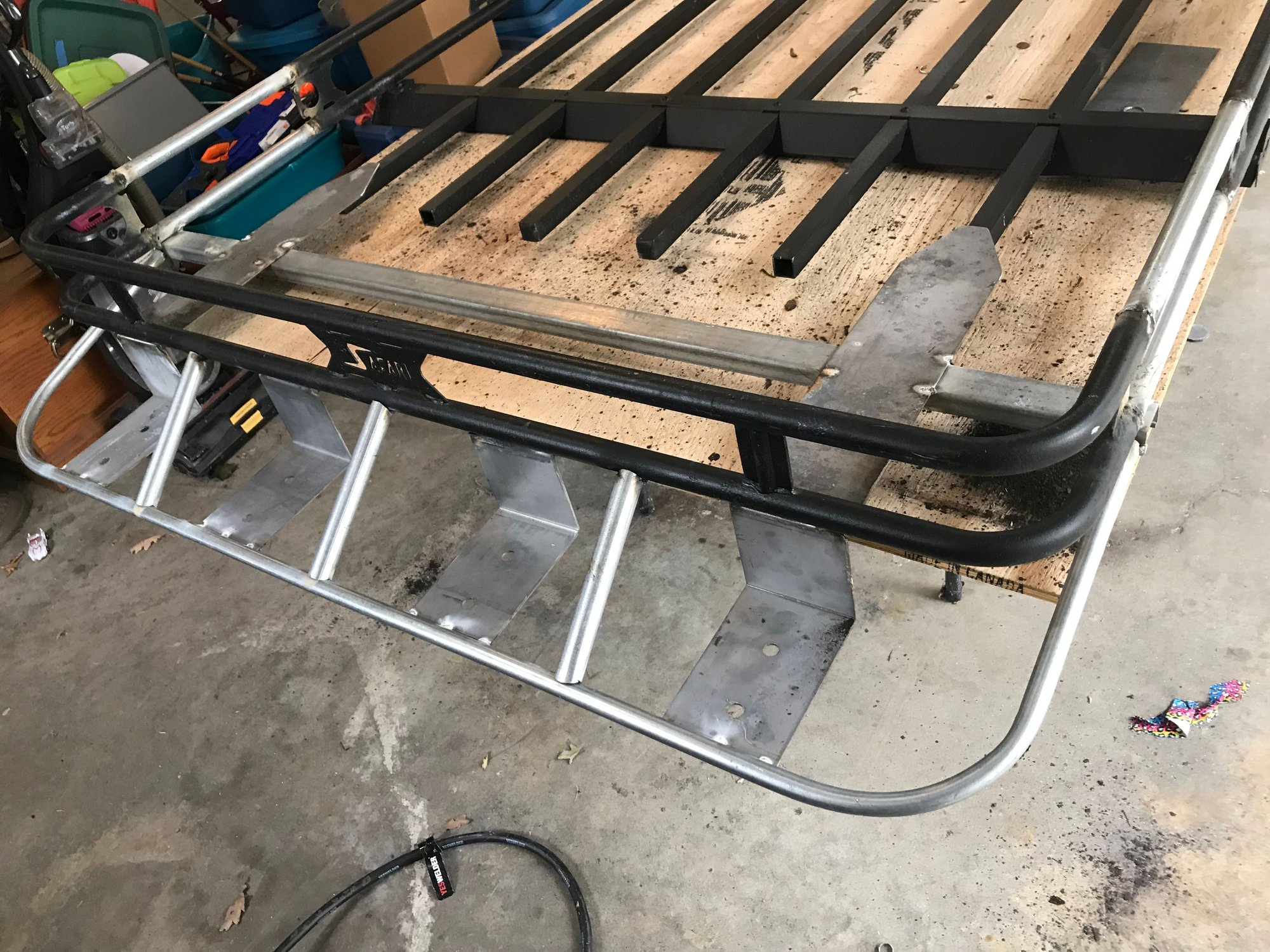

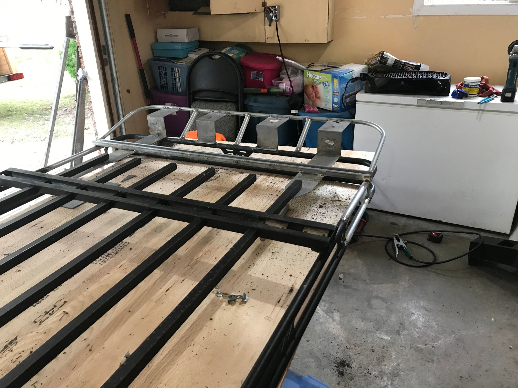

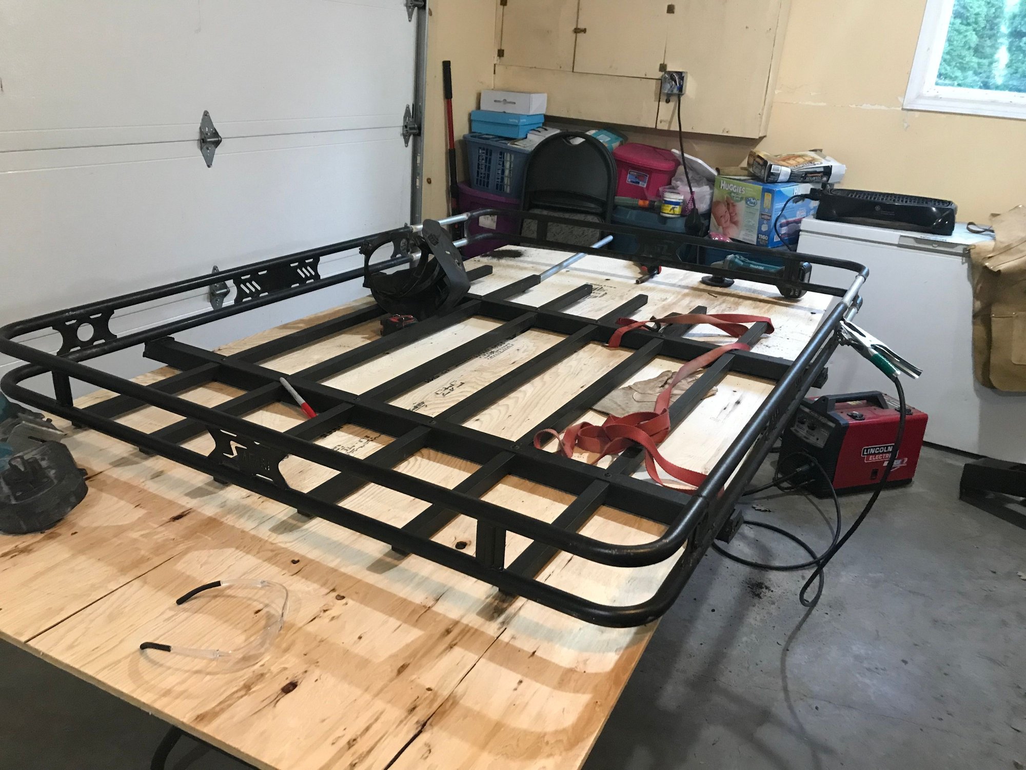

Starting to resize the rack for my rover. Adding 13” in length. And will make up some light mounts. The old tube is kinda rusty inside.
It’s hard to weld the old rusty tube. I probably should’ve just built one from scratch and sold this one but I’ve started now. 😒
Old Sep 5, 2019 | 09:13 PM
  #83
Looks like a solid start though

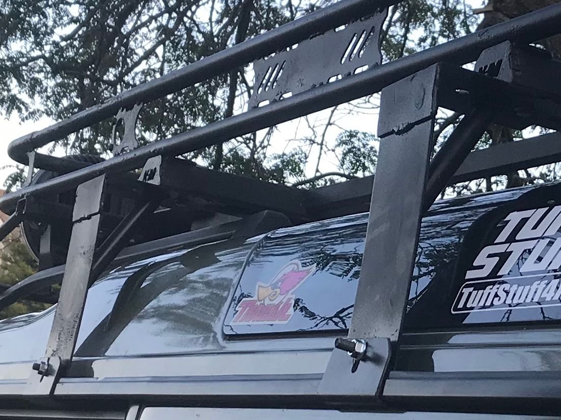

Built light mounts and painted it quick. Needs a guard on top for branches but not sure what I want yet.

Looks good nice work

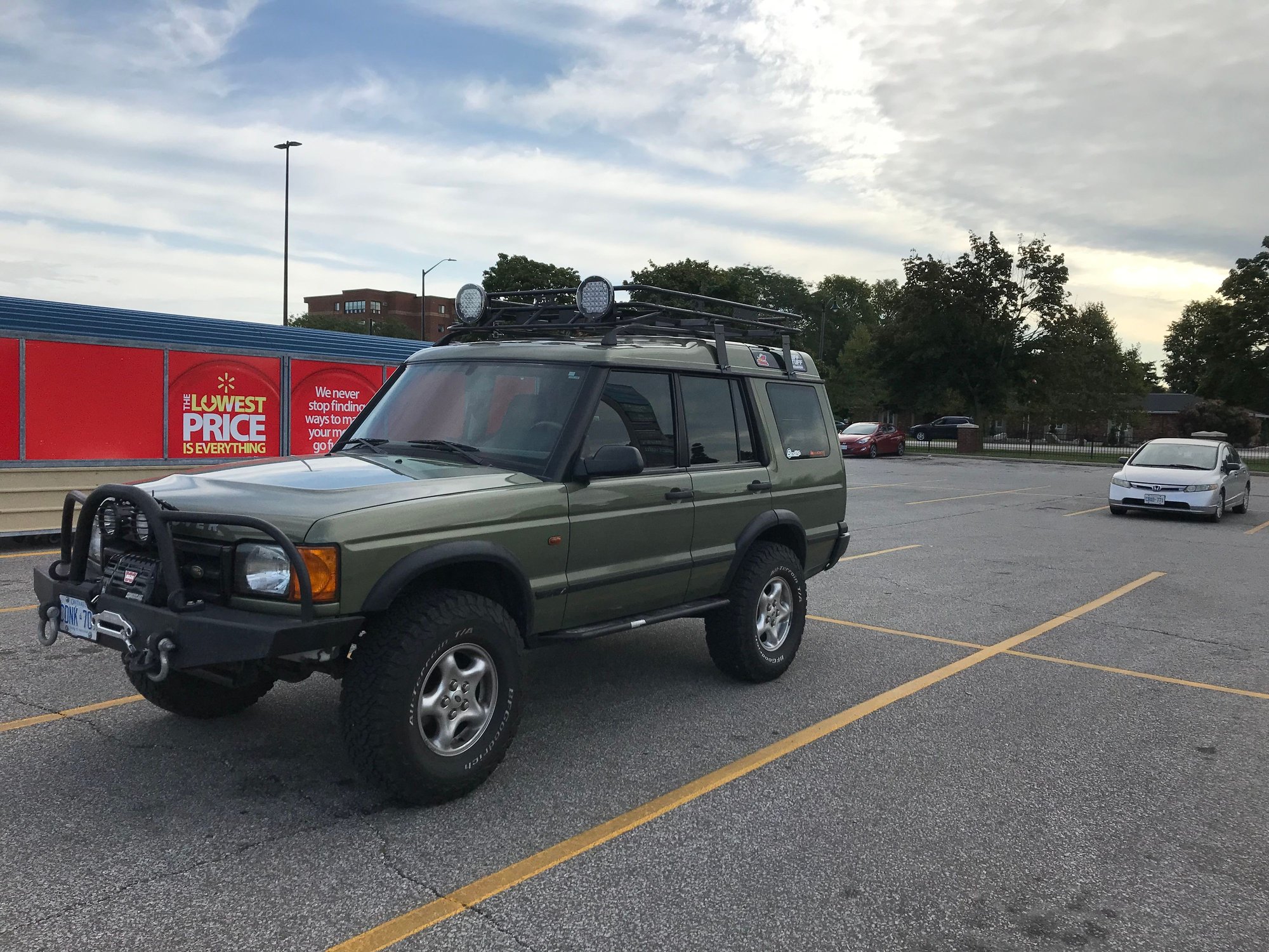

Well it’s on there but I need to change a couple things. And get 2 more lights

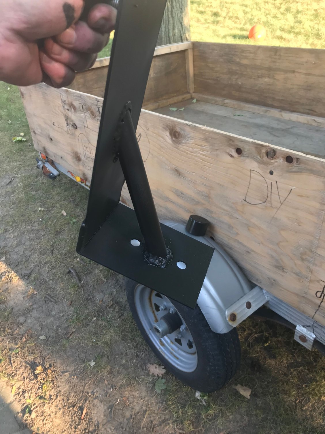

Version 2 of my mounts
Flexi flyer version 1 lol

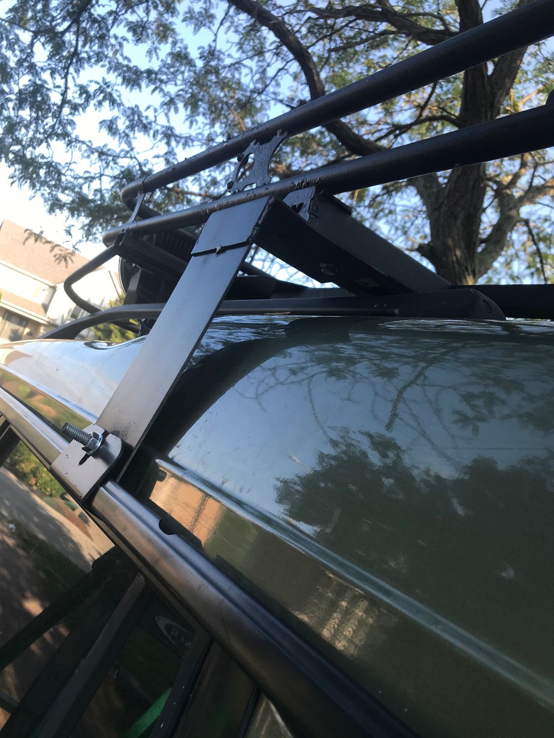

I finished up the reinforced mounts and made studs for the high lift.

I am not sure I would put the high lift up there, that is a lot of weight on the the gutter, or maybe add a couple of more mounts on that side to spread the load
