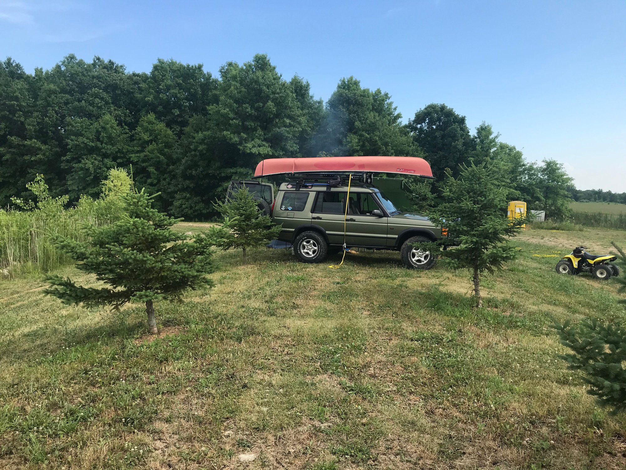

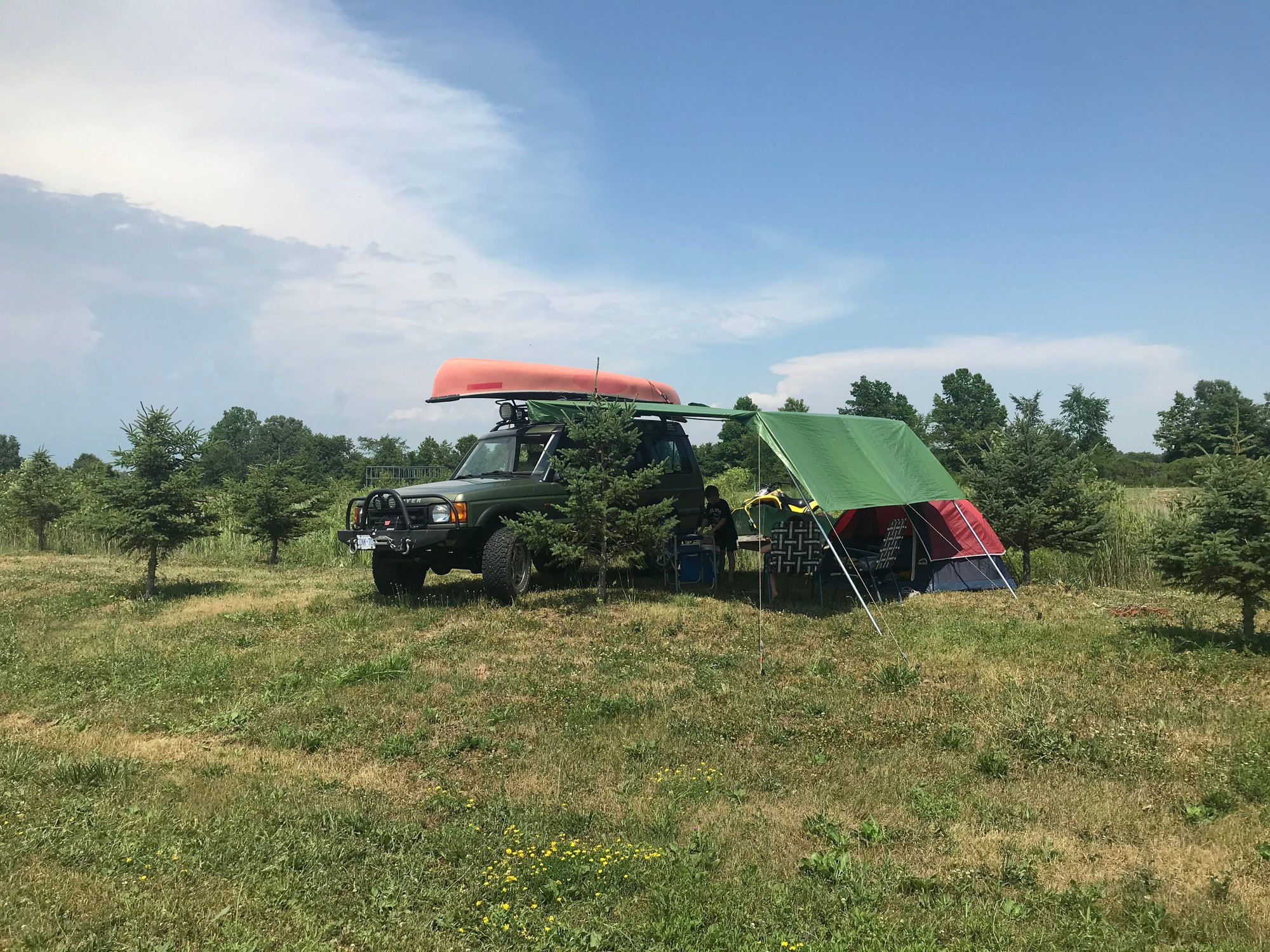

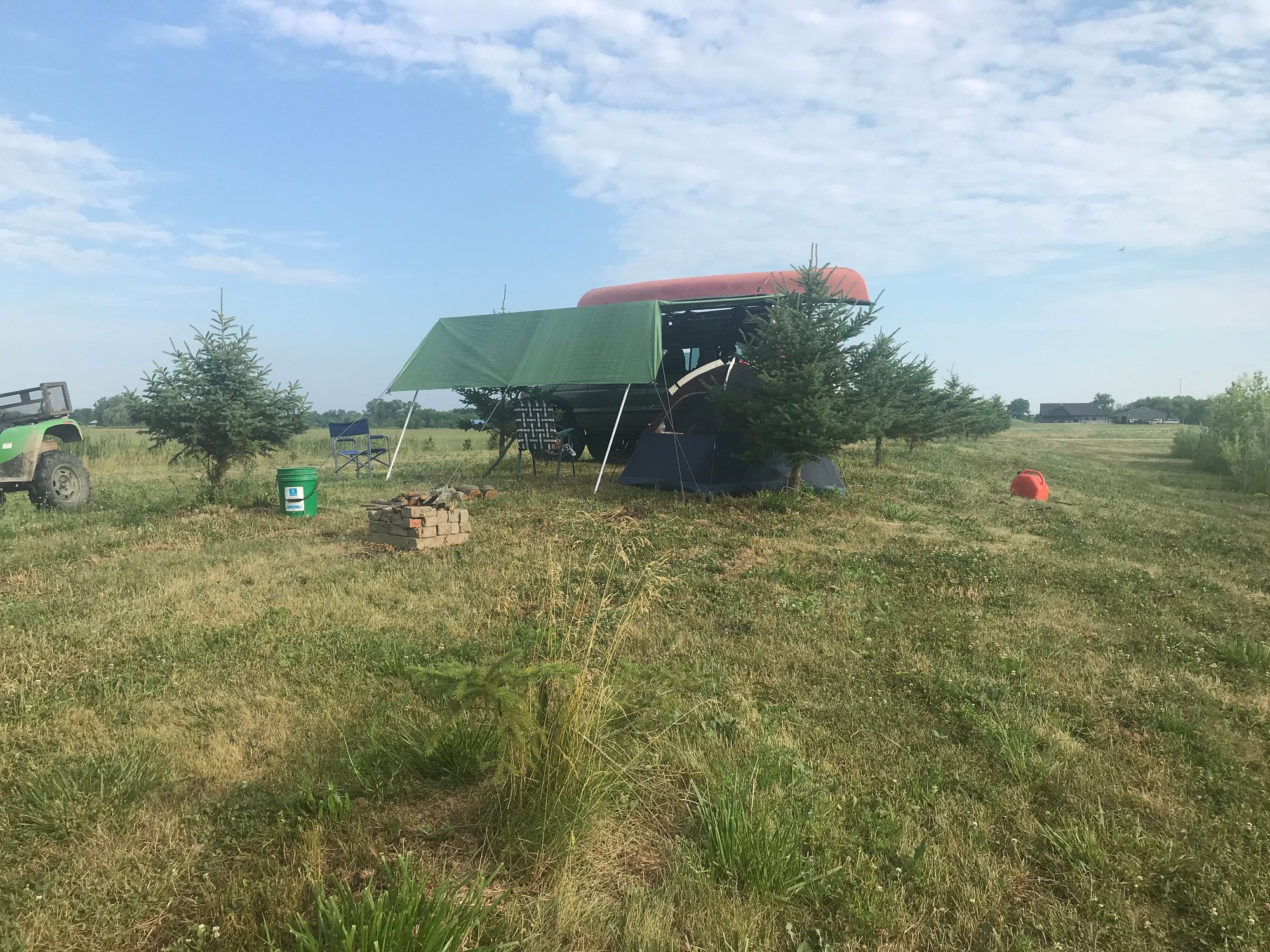

From: Amherstburg Ontario
Got a good camping trip in with the kids. The awning helped a lot with the sun.

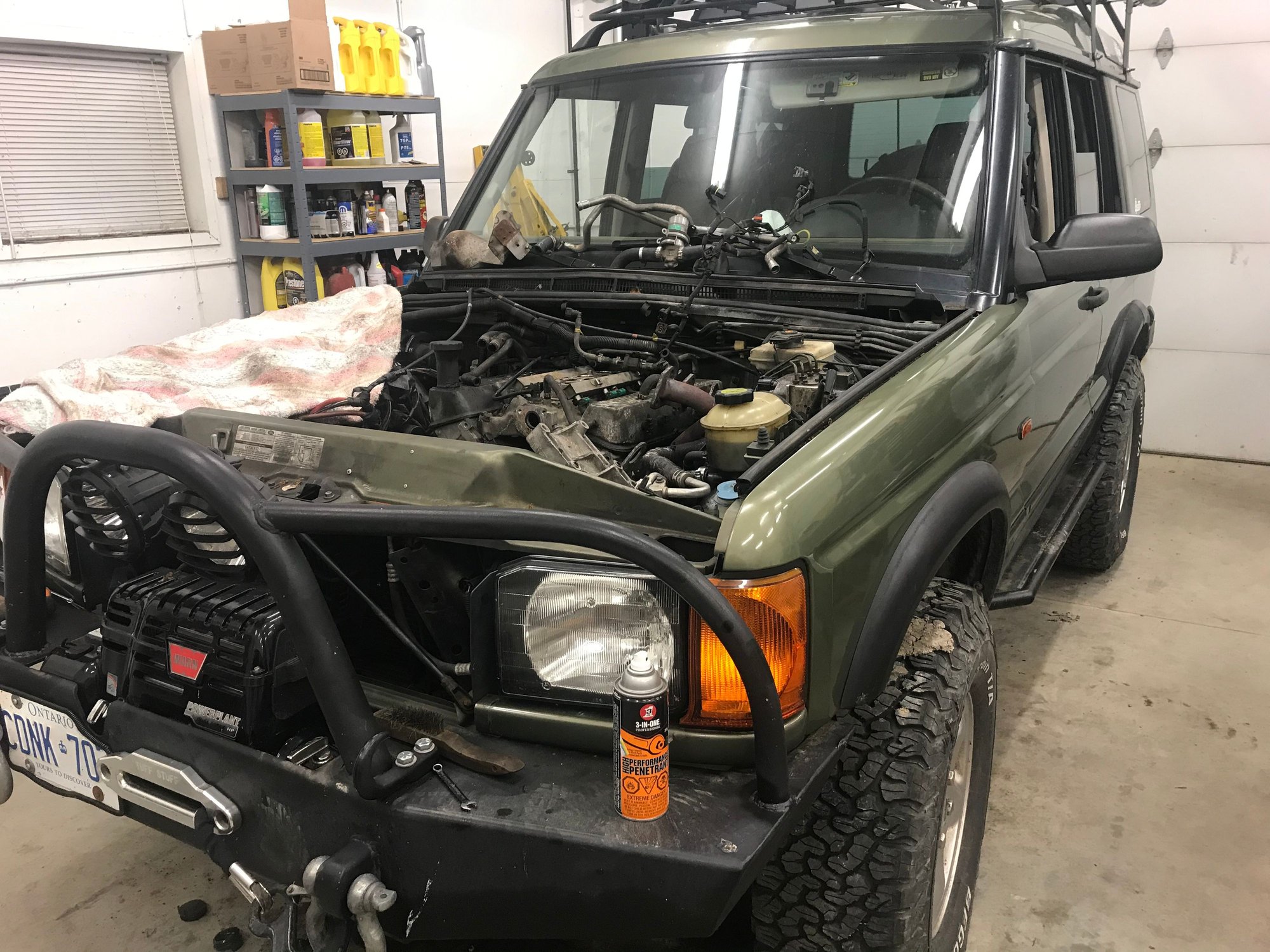

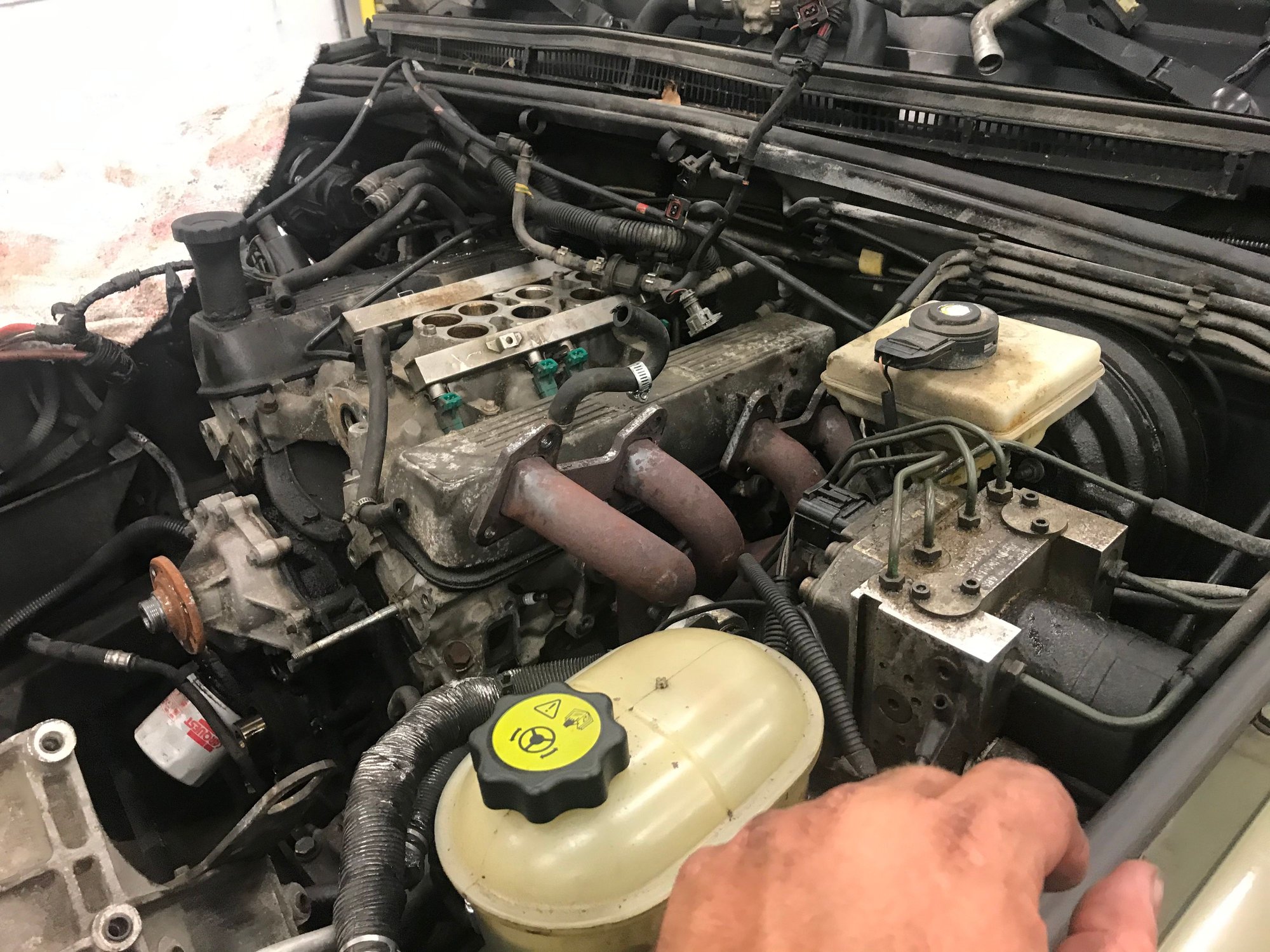

Motor swap time.

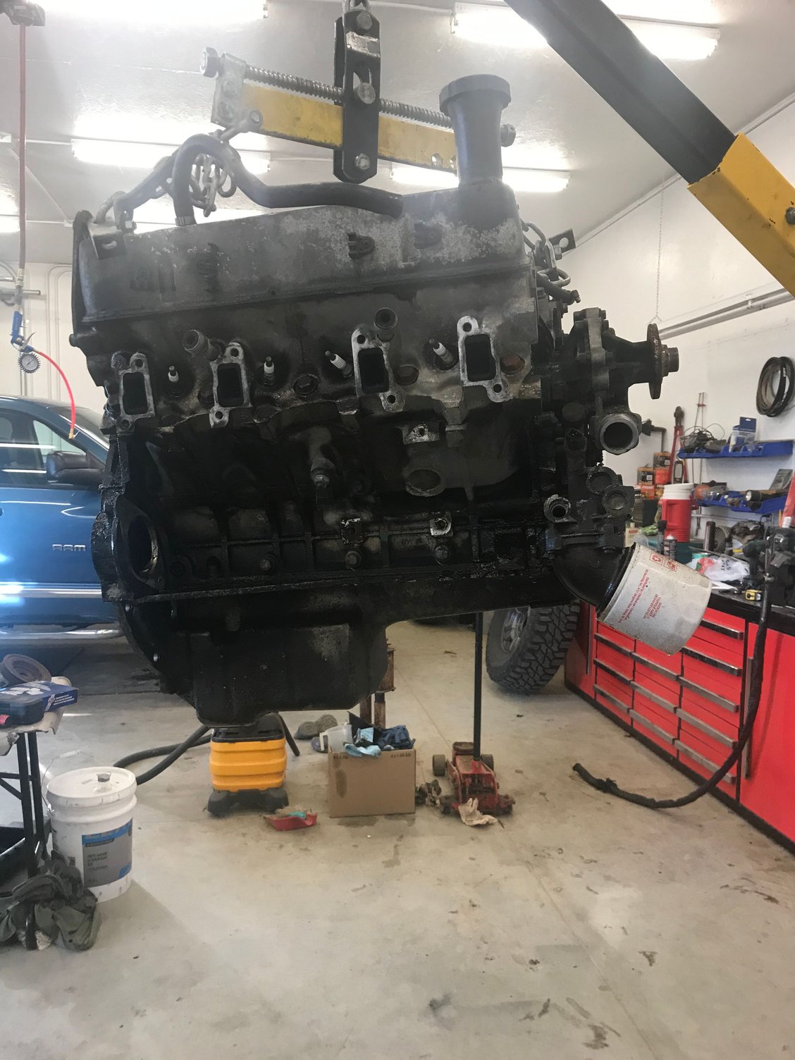

Well I’ve had 2 3hr and 1 2hr session to work on pulling the motor so far. It’s at my buddies whose 15 mins away. It’s a great shop but it sucks not being at home to give it more time. 3 kids and a wife seem to limit my wrenching time. Lol oh well
i thought I’d of had the motor out this morning but can’t seem to separate the engine from the transmission. The last rover motor came apart fairly easy. I’ve looked and relooked but don’t think I’ve missed anything.
maybe a second set of eyes next time I’m there
Old Jul 21, 2020 | 07:51 AM
  #167
Fastercat's Avatar
Joined: Nov 2017
Posts: 788
Likes: 295
I must of been bushed last time, when I got to work On her last night I found 2 bolts I missed right away. Lol. Out she came no problems. I also pulled my lower steering u-joint off to soak in cleaner and lube up. It’s often gotten stiff and needed spray oil to free up every few months. I’ll go through the wiring harness while is out of hiding and re-wrap/tape up where needed. I’m thinking of doing that coil relocation deal, but I’m not a fan of longer plug wires.

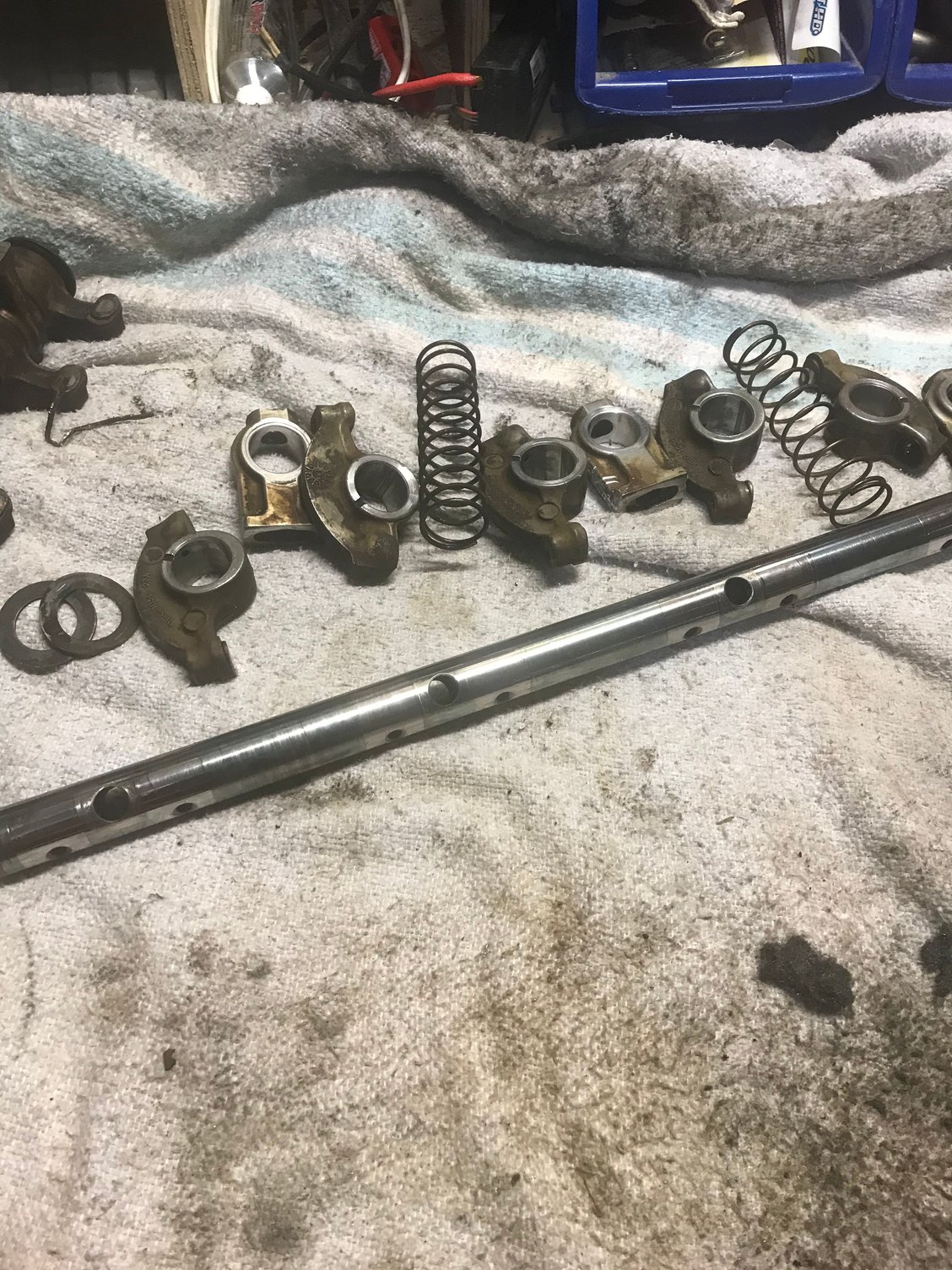

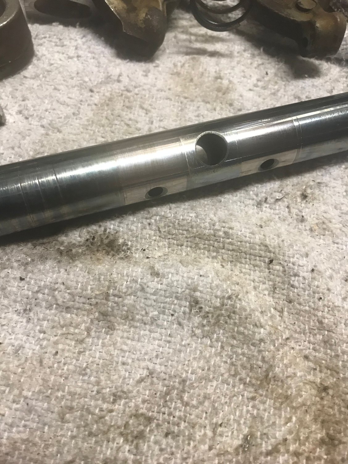

The old 4.0l rockers and shafts are in great shape, so that’ll save me some coin. I’m going to ceramic paint my headers myself. I was going to get them coated which I know is way better but I just can’t afford that much at the moment. I’ve been driving my old p38 that my brother bought off me while my trucks been down. Lol I think I’ve spent almost as much time fixing it as working on my truck. Lol. It left me stranded Friday night. First time I’ve ever been stranded by a rover.
