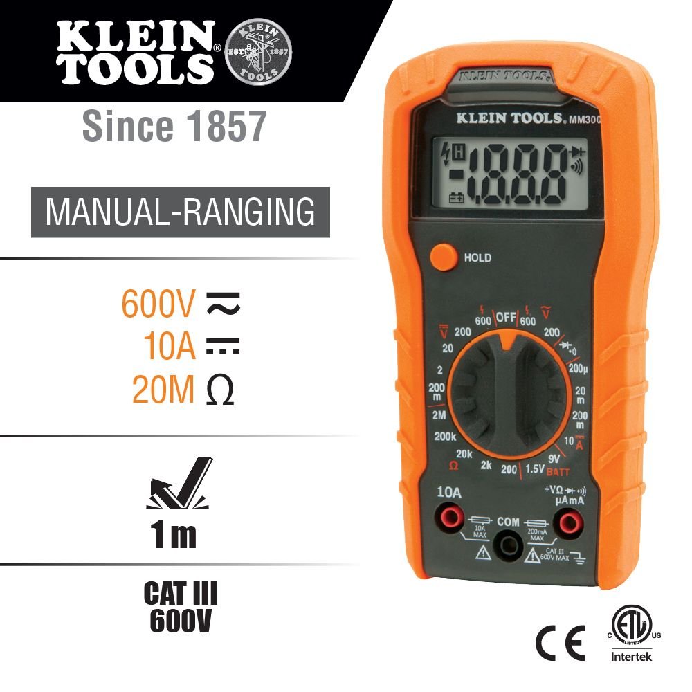

So I went up to test the fuel pressure, but apparently the pressure tester I have doesn't have the right size for the valve on the fuel rail, so gotta buy a adapter. Then I ended up finding a can of starting fluid and it kinda sounded like it wanted to start at first, but then nothing even when spraying little sprays in. So then I went to test the coil pack, and honestly don't think I was doing it right, so when I test it on the coils red wires I should have it unhooked except for the plug that goes into the loom? Also as I am still not very proficient with multimeter would that be the V on the left side with the solid line, then dashes underneath, or the right V and the curved line? Will attach a pic of my multimeter. So tomorrow gonna head to town and pick up a adapter for pressure tester, so I can actually test it lol.

Yes for the meter setting, 20 or 200 is fine. Straight line is DC, wavy line is AC (sine wave). If you can connect an alligator clip on one of the coil terminal nuts, or back-probe the plug connector with a pin or fine wire at the red wire. Should read battery voltage with key ON.
Trying to figure what could cause no spark. I think if the shifter is in the wrong position, that causes no crank, but just make sure it is really in Park or Neutral, maybe try each position. Same with anti-theft, I think that gives no crank, but not sure. I think the only thing that could cause no spark is the CKP sensor, wiring or coil relays, or the ECM. Checking for volts at the coils will get us closer to the answer. Sorry this is taking so long.
