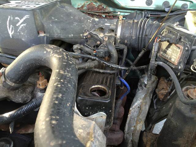

Another question too: I don't know if this is related or if this is just random, but in the attached picture you can see that there is this mud colored stuff in the engine bay and on the inside of the hood. Is that just from driving or is that something else? I'm not entirely sure. And yes I just took the oil cap off.
