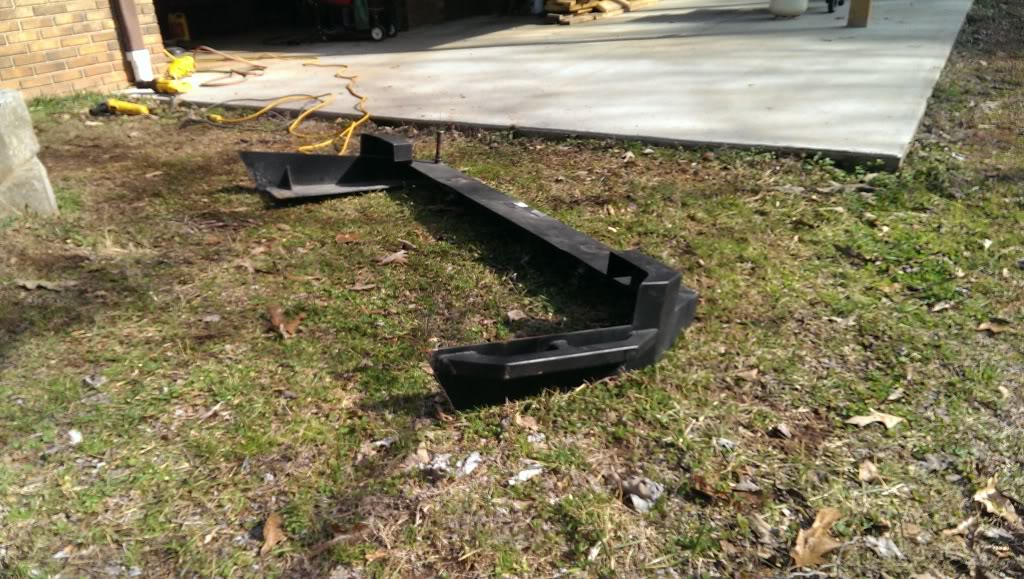

Didn't work on the truck but did a lot of work on my rear bumper. Started like this...

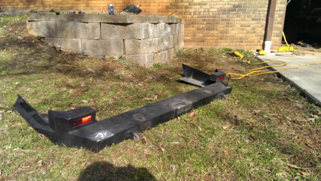

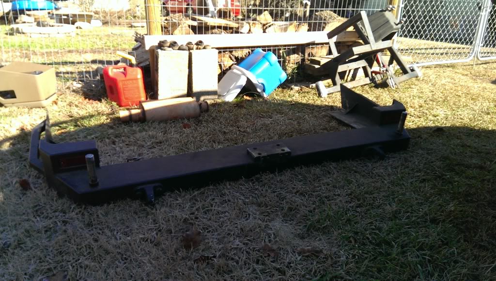

Cut off the 2nd swing away post, removed center latch catches, welded on new mounts, trimmed the wings and filled all existing holes and ground it all back down. Ready for a coat of paint and a run in with some rocks or a tree!

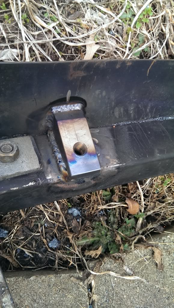

I like it $100 shipped? Lol
Got a good pic of the mounting?

Its the same as the Rovertym but one had a bolt bottomed out and broken off in it and then I broke an ez out off in it so I just had a buddy machine me some new mounts. Torched off the old and welded on the new. Excuse the weld on the left side. My buddy thought he had enough gas left to get it done but we ended up making a trip to the welding supply shot for another tank.
