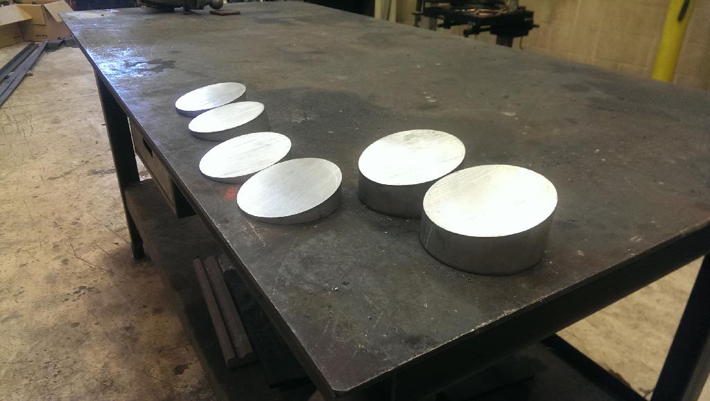

Made some spring wedges yesterday. As you lift your truck the pinion points at the diff more and the lower spring perch angles towards the resr of the truck. These go between the axle and the perch to bring it back to level. Takes a spring that looks like ")" to "l".
One set it for Ian, the taller set is for me. I'm going to remove the ones I have and sell them along with the extra set pictured.
*I didn't get a pic after drilling the mounting holes.

Neat. Let's see them installed.

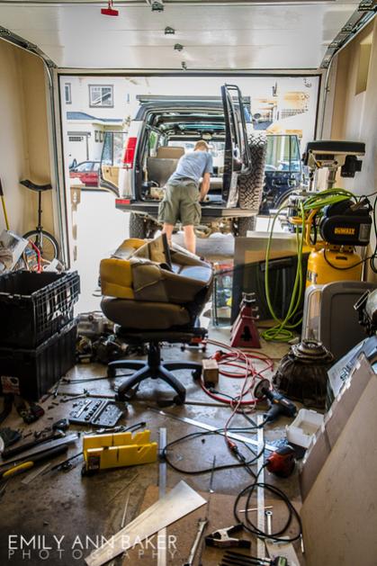

Far too much to list. Instead, here's my ****.
Attached Thumbnails So what did you do to your Disco today?-p142142264-4.jpg

I've had a set installed for a while, I'll try to snag a pic.
Hey, nice compressor! I've got the same one!

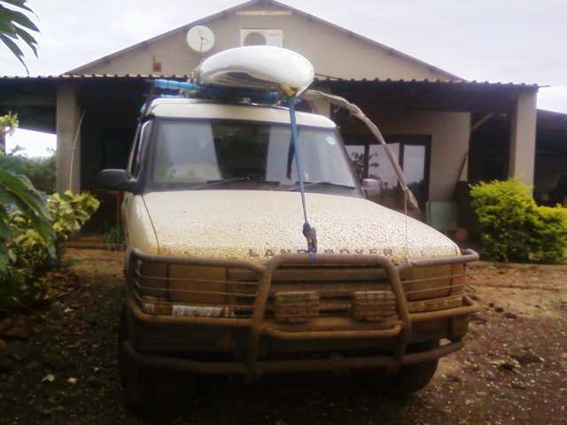

Yes, 80% off road and the rest high way (If you can call our roads High ways)
Did all the expensive mods to survive the off roads and the Disco behaves well.
Had a trip South last week and this time of the year is our peak rain. Had 150 mm Monday and the roads became rivers. The bonnet was under water more than once. Pic of my return home.

Best 110v compressor I could find.
Yeah much progress on metal rover. Passenger side almost done. Just need to strip and paint roof silver with satin clear coat to match. Pics soon.
