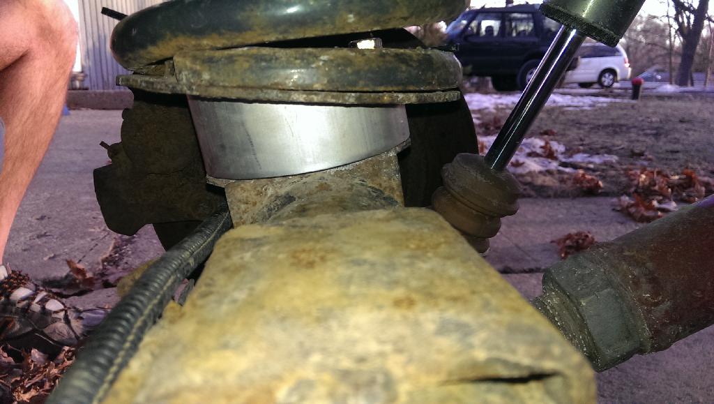

Originally Posted by EricTyrrell
Neat. Let's see them installed.
Here's the wedges with built in 1" spacers. Shows how it makes the spring perch level when the axle is not. Please excuse my leg, LOL.

I think you might want to consider a DC rear shaft with that pinion angle Brett!

Looks good. Did you make slanted washers for the bolts too?

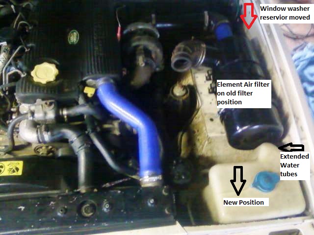

Default Air filter Mod
With all the mud and rain we had the last 3 months the original filter became "soggy"
I have decided to install an element filter.
Removed window washer reservoir to front and extended tubes and wiring.
This intake position is temporal because my snorkel is already dispatched from Johannesburg, South Africa.
Only problem I see is when the filer needs to be cleaned or replaced I will have to lift the complete outer body to get to the element.
Meh. It doesn't vibe. I'll get the wheels back on it and see where I'm at. Maybe adjust the trailing arms to get the pinion down a bit. We'll see.
LOL, no. I actually just removed my cones and installed some retainers. The bolts are ok, they don't mind.

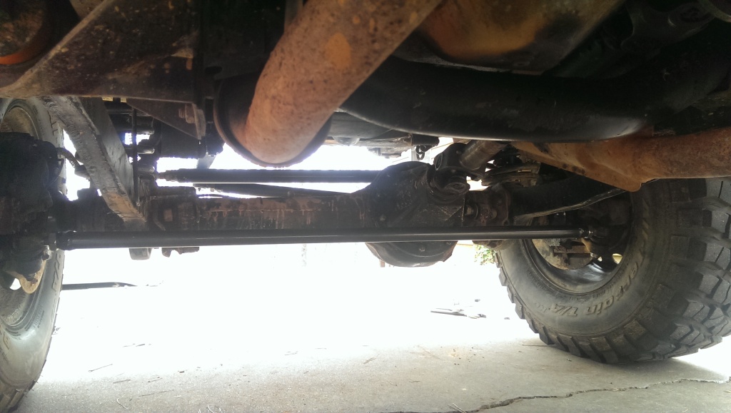

Installed my new spring wedges thanks to Brett. They straightened out my springs a good bit. Also put the rebuild rear third back in and installed my new custom steering rods. Drag link is 1.5x.25 DOM and track bar is 1.25x.120 DOM. Went with a smaller track bar to fit better with a future 3 link.
