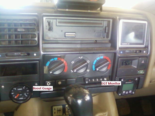

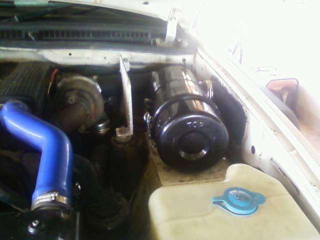

Could do a few things again on the Disco
Installed Snorkel and had a perfect fit to the Element Filter.
Made asbestos heat shield and installed between filter casing and Vnt Turbo.
Installed Turbo boost guage and very happy to see boost up to 1.2 bar.
At cruising 110- 120 km/h boost on 0.9 bar with revs @ 2750 Rpm.
EGT 360 deg C
Steep incline, 2 km+ in fourth gear and revs at 3000 Rpm, boost 1 to 1.1 bar and EGT 550- 600 Deg C
Pull away changing into 2nd gear boost 0.7 @ 1350 Revs EGT 280.
When floored in 3 rd boost 1.2 Revs 3200 and EGT rising rapidly from 280 to 660.
Idle to 1100 revs Zero boost.
