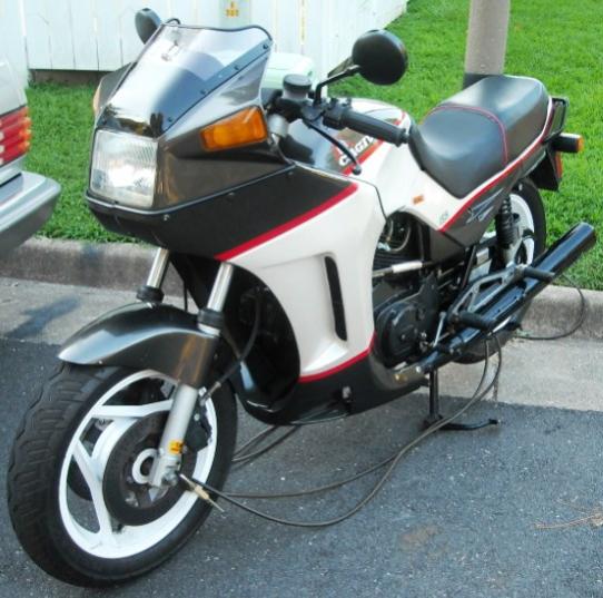

Used my Disco I and a small trailer to get a stablemate over the weekend. Picked up a low mileage (9500 km - 5900 miles) 1987 Cagiva 650 Alazzurra, Italian v-twin motorcycle. Pretty neat little scoot, TONS of character, good middle-weight performance bike right out of the box (Ducati air-cooled 650 Pantah engine with Desmo valves), 2-2 exhaust, triple disc brakes, chain drive, Euro-spec full-fairing version, etc. Found a source for steel-braided lines in the UK, so ordered a set for the brakes and clutch. Will change plugs, oil, oil filter, install the lines and bleed the brakes and clutch, check/adjust the chain, etc. by 10K kms, so that will be my "zero" mileage for future maintenance.
I haven't had a chance to clean it yet, but that's on the "to do" list, so you'll have to excuse it's grungy appearance. It's locked to a light pole for now, with a cover on it overnight. But I'll be moving it tomorrow into a 10x10 public storage unit I rented over the weekend (8 miles away), and will lock it inside, so it will be more secure there, and out of the elements ("out of sight, out of mind!"). And I do have a lock thru the left front brake rotor, thus the small green dot in-between the gauges, reminding me about it! I haven't done it, but I've seem some people take off on their bikes, forgetting they had a disc lock, and the result wasn't pretty!
Now if I could just get the rear hatch door to open on the Disco!
