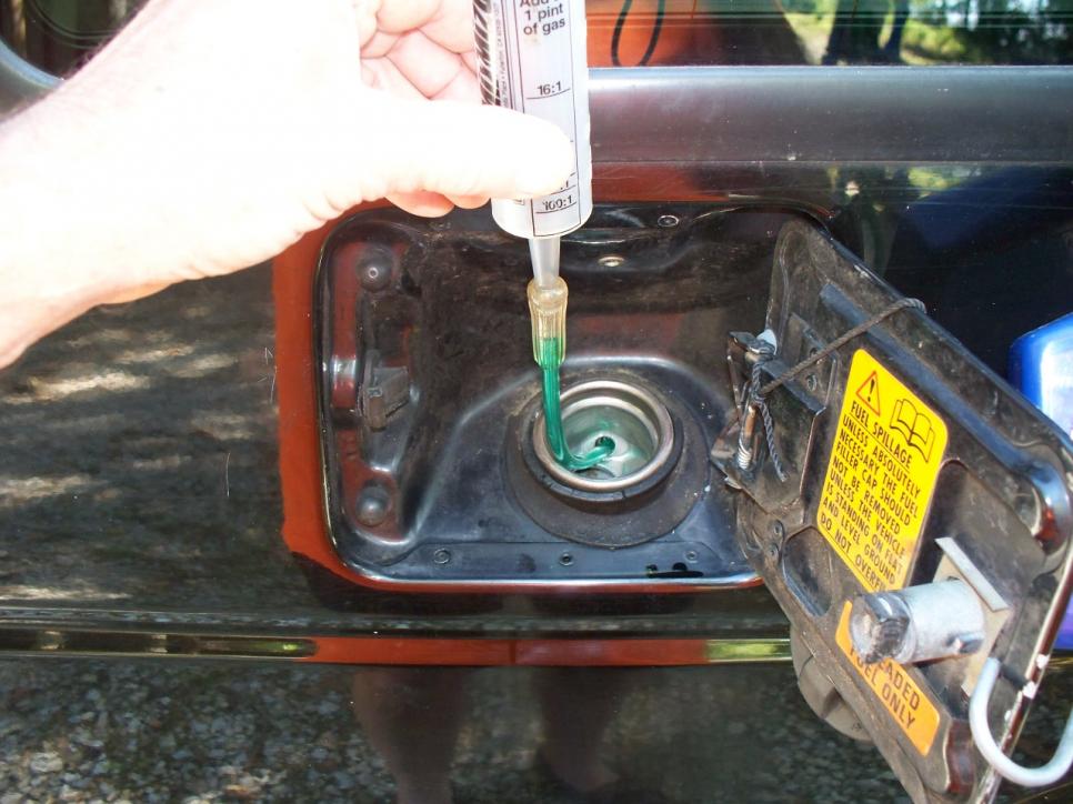

Default injector cleaner in filler vents
My 98 LE has taken gas extremely slowly since I got it and today I found a thread “gas tank problem” in the archives about burping/leaking gas fillers that said the vent tubes on either side of the filler neck get clogged with varnish and can be cleaned by pouring injector cleaner down them. ( Some folks also had leaking problems due to cracked hoses and others say there was a recall on the tank and filler and to call the dealer with your VIN to see if yours was done.)
I rigged an oil mixing syringe with a short piece of oxygen hose to fit in the little vent holes and poured half a bottle of Valvoline injector cleaner and most of a can of Seafoam down them. (partial containers I had on hand) . I thought about spraying carb cleaner in them through the little straw, but decided it might be too strong and went with the recommended fix. Hope next fill up will go faster.
