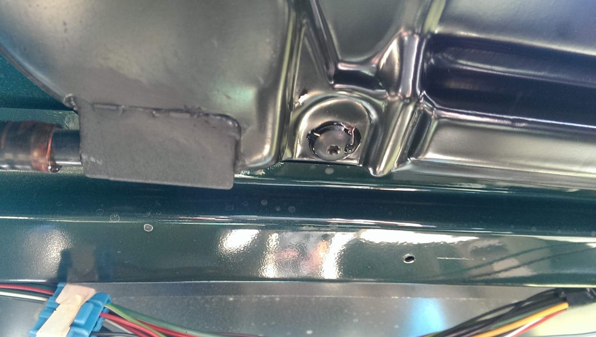

I pulled the headliner to source my various water leaks. Mainly plugged drains. Not too bad. Then i noticed nearly every torx screw was loose. The screws for the front motor were backed out like an 1/8".
So now all is tight and siliconed where needed and lines cleared. Also drilled a hole through the roof for lights and adjusted the cargo door so it actually touches the seal on top

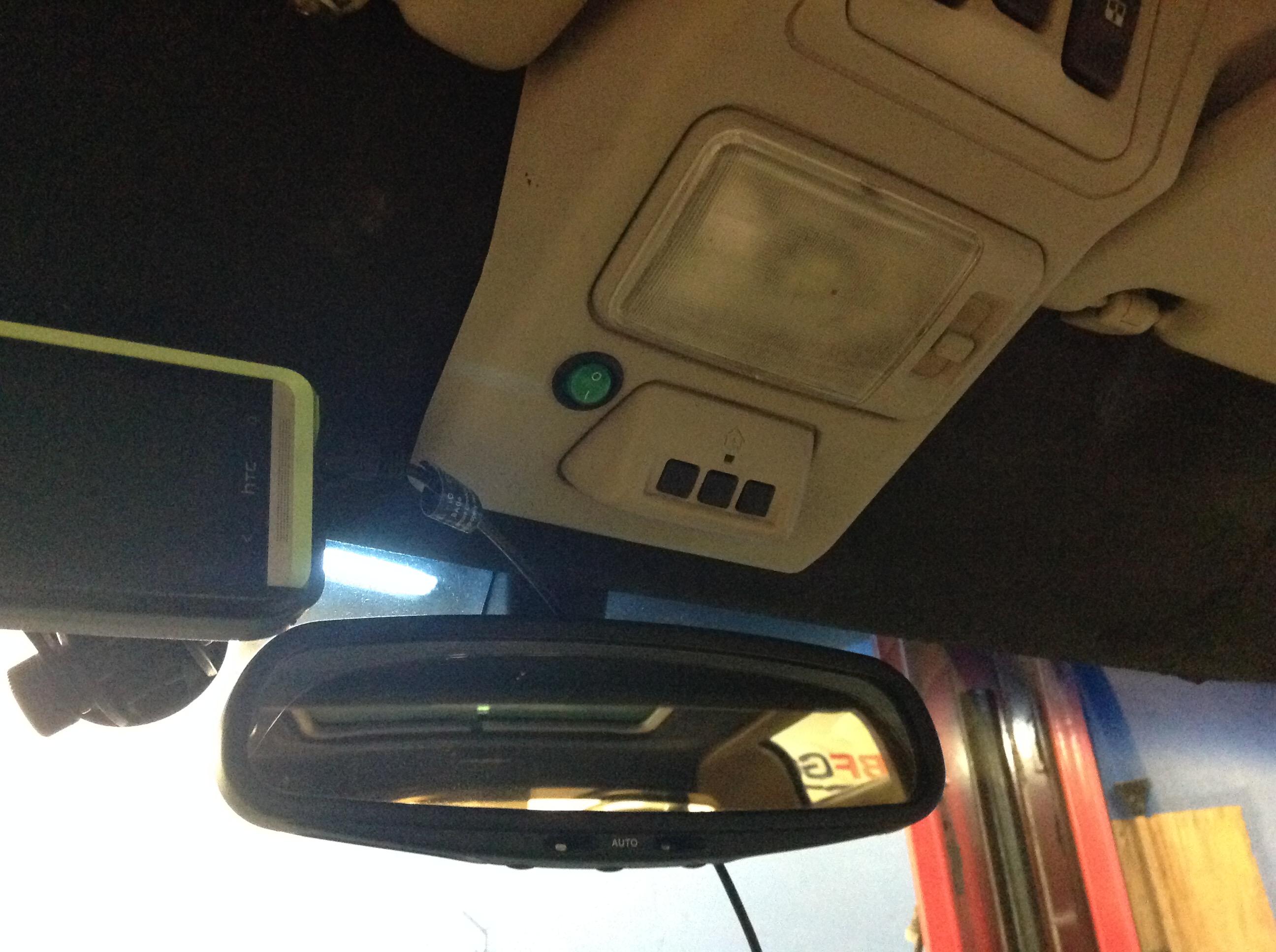

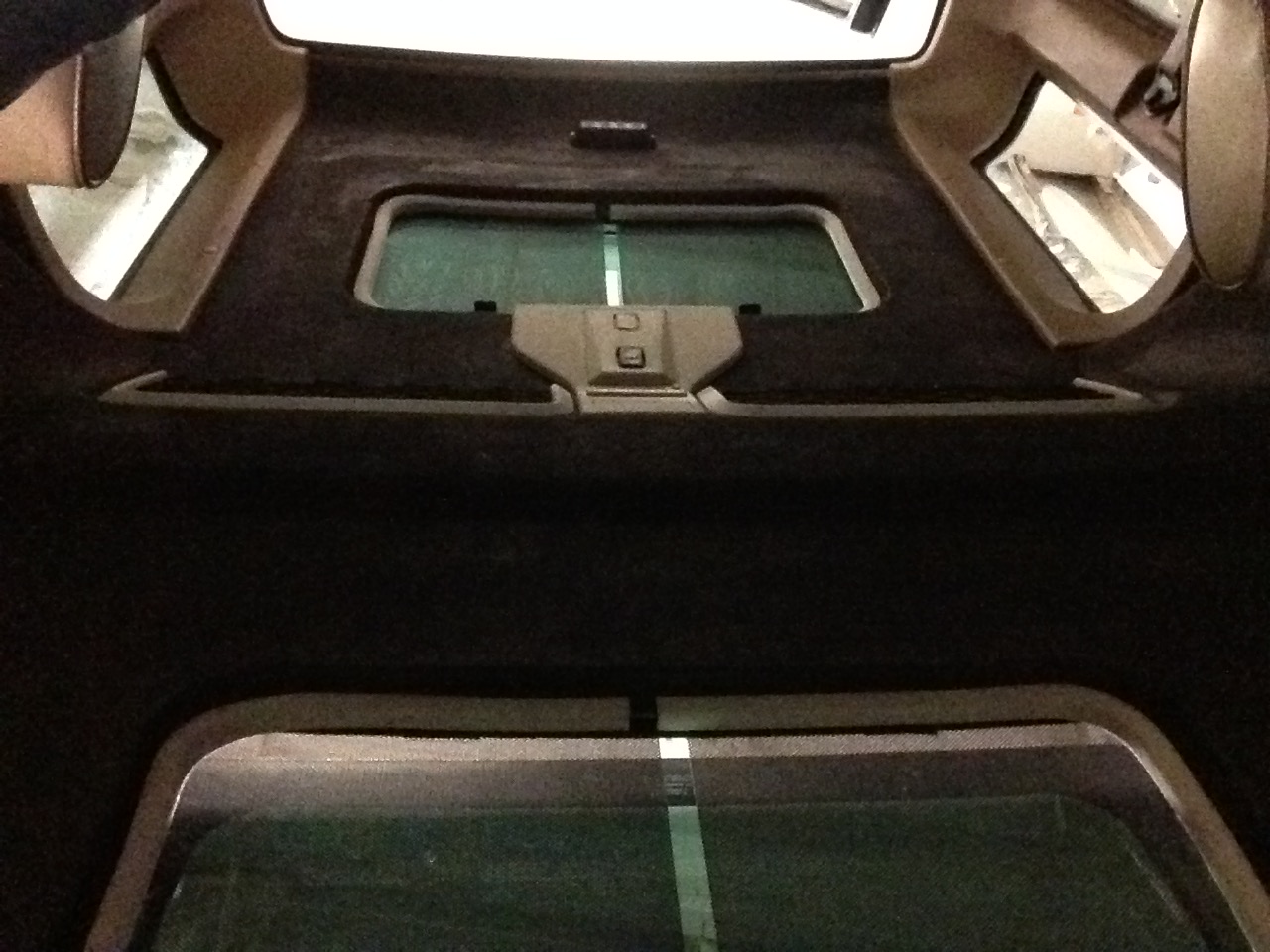

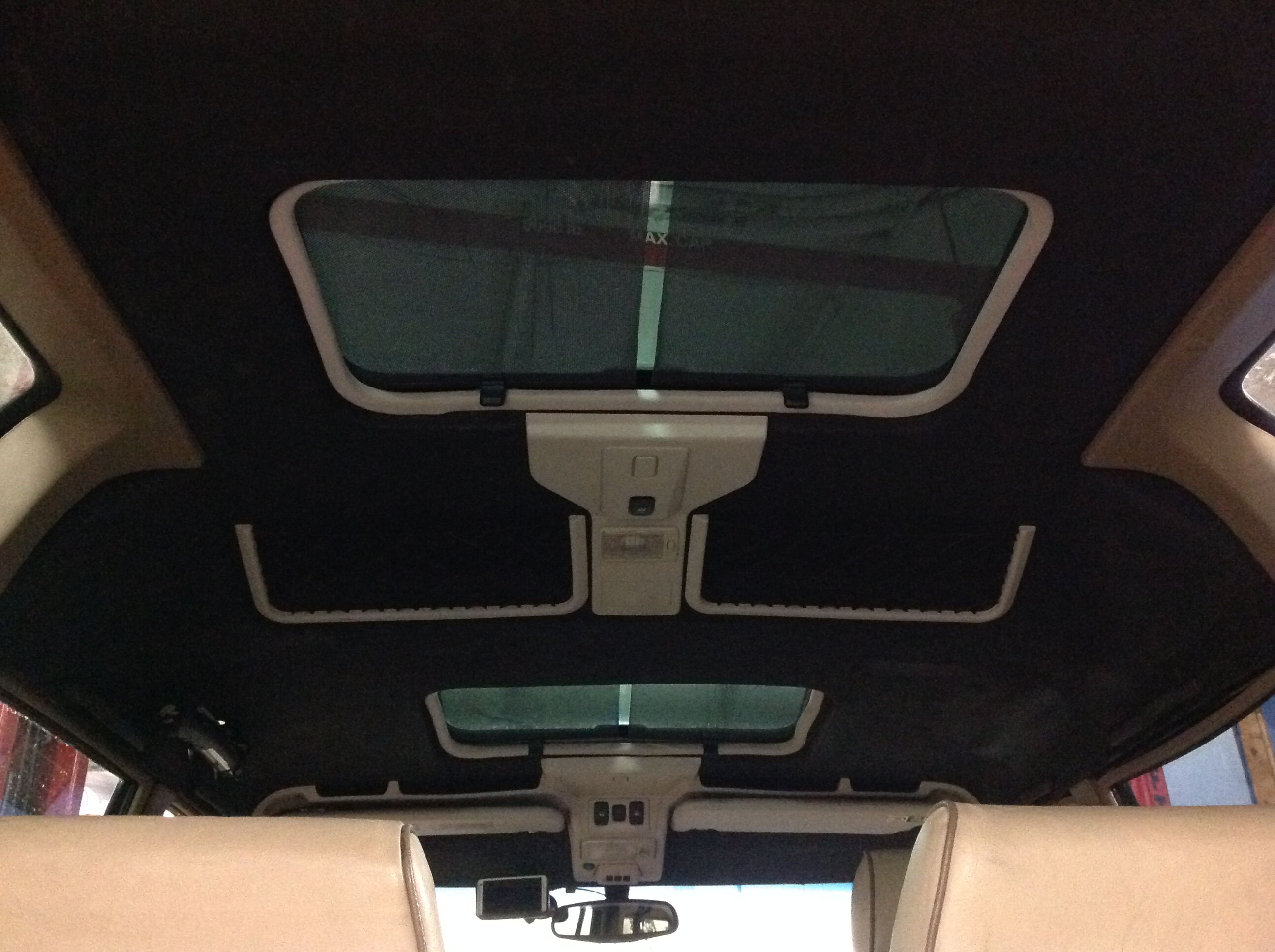

Well I buttoned up the headliner tonight. No more water leaks. No more binding sunroofs. No more sagging fabric. Led cargo light securely attached to headliner. Flashlight mount securely fastened to headliner. Switch for roof lights mounted next to homelink. Also wired in a remote module for the roof lights. That'll be nice to not get blinded when walking back to the truck after hooking up the winch rope
