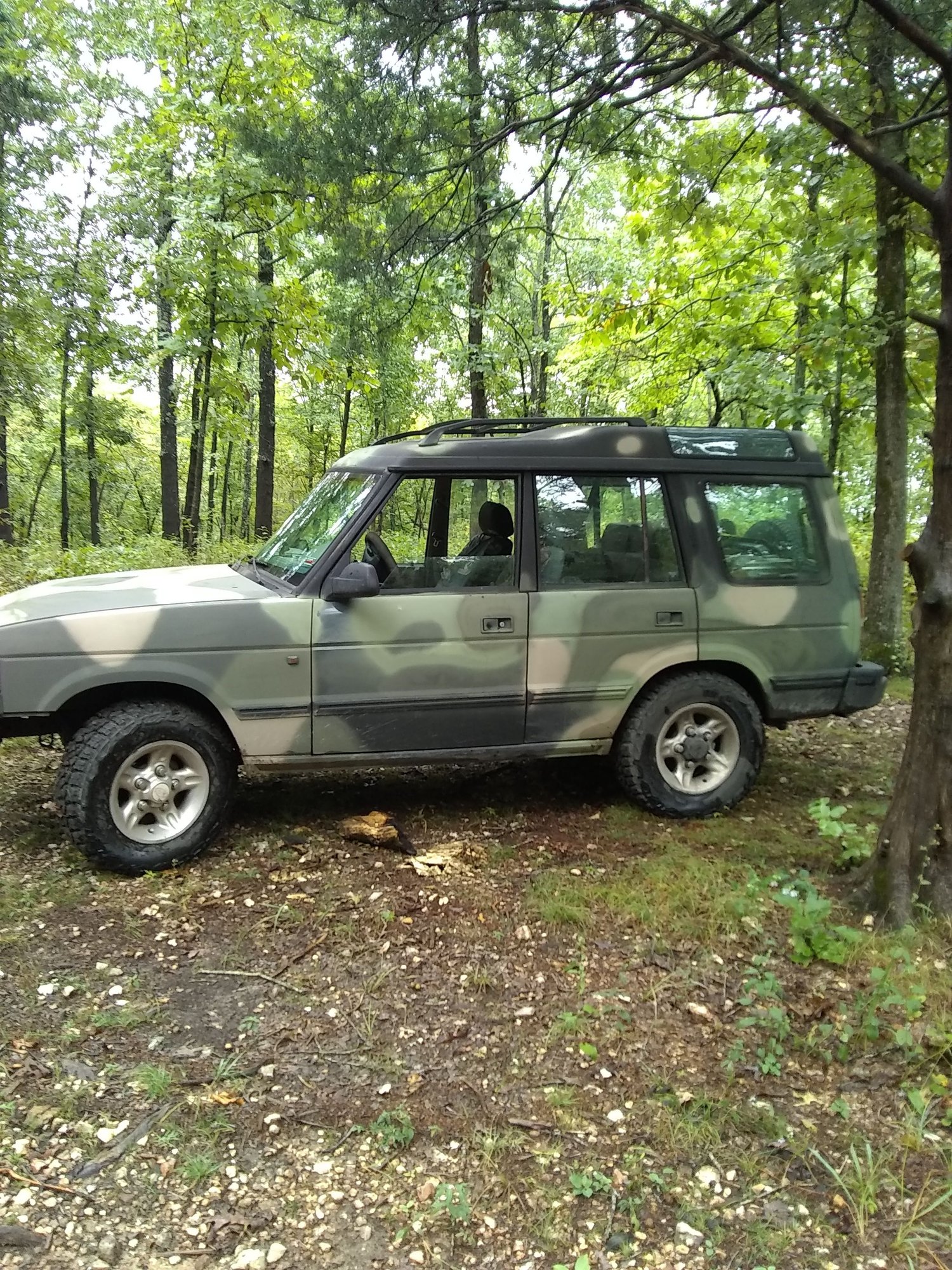

Default Mark twian national Forest
Minimum maintenance roads and ATV trails .
Did some Early deer season scouting , my disco 1 is home in these woods 😀😀
