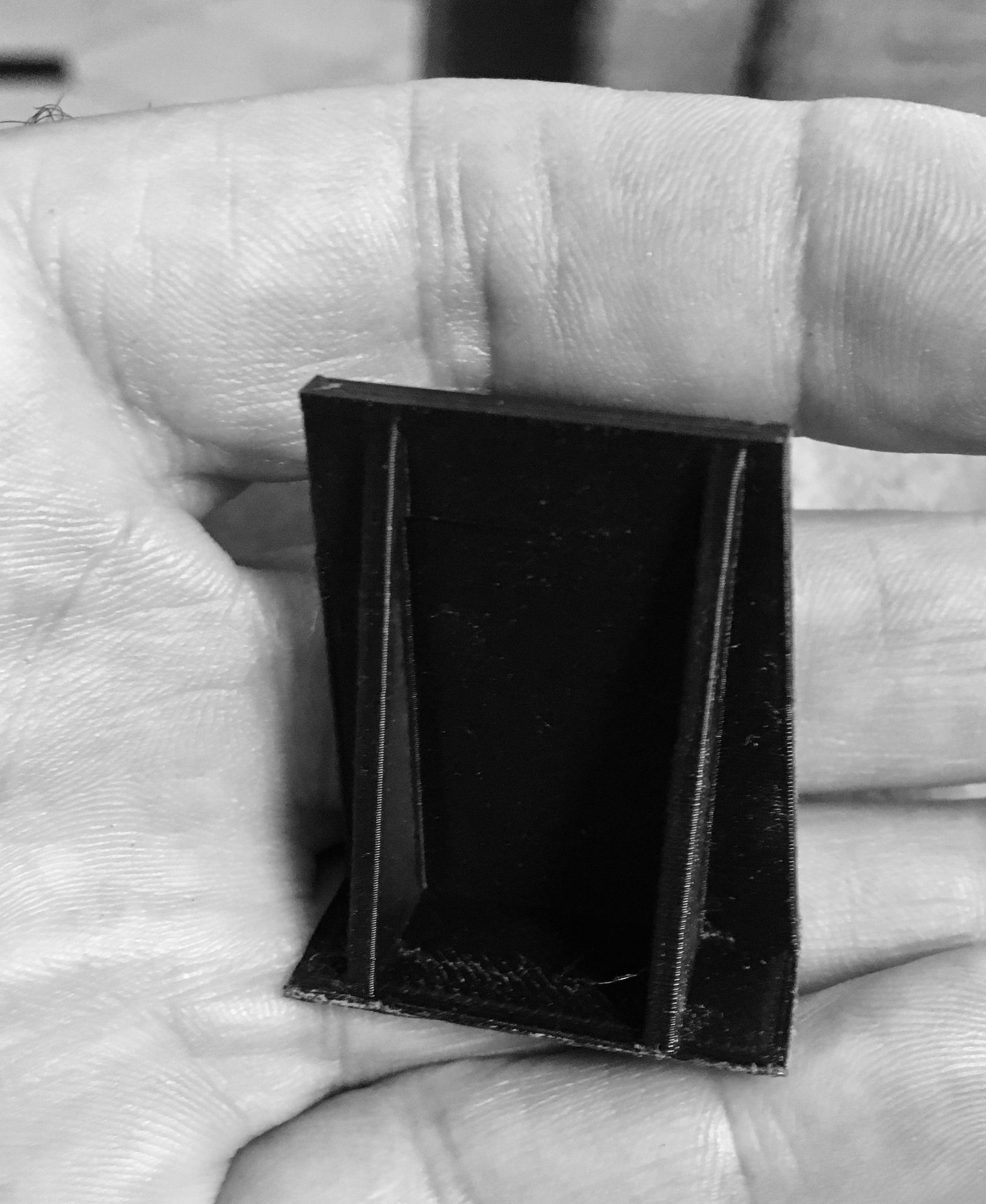

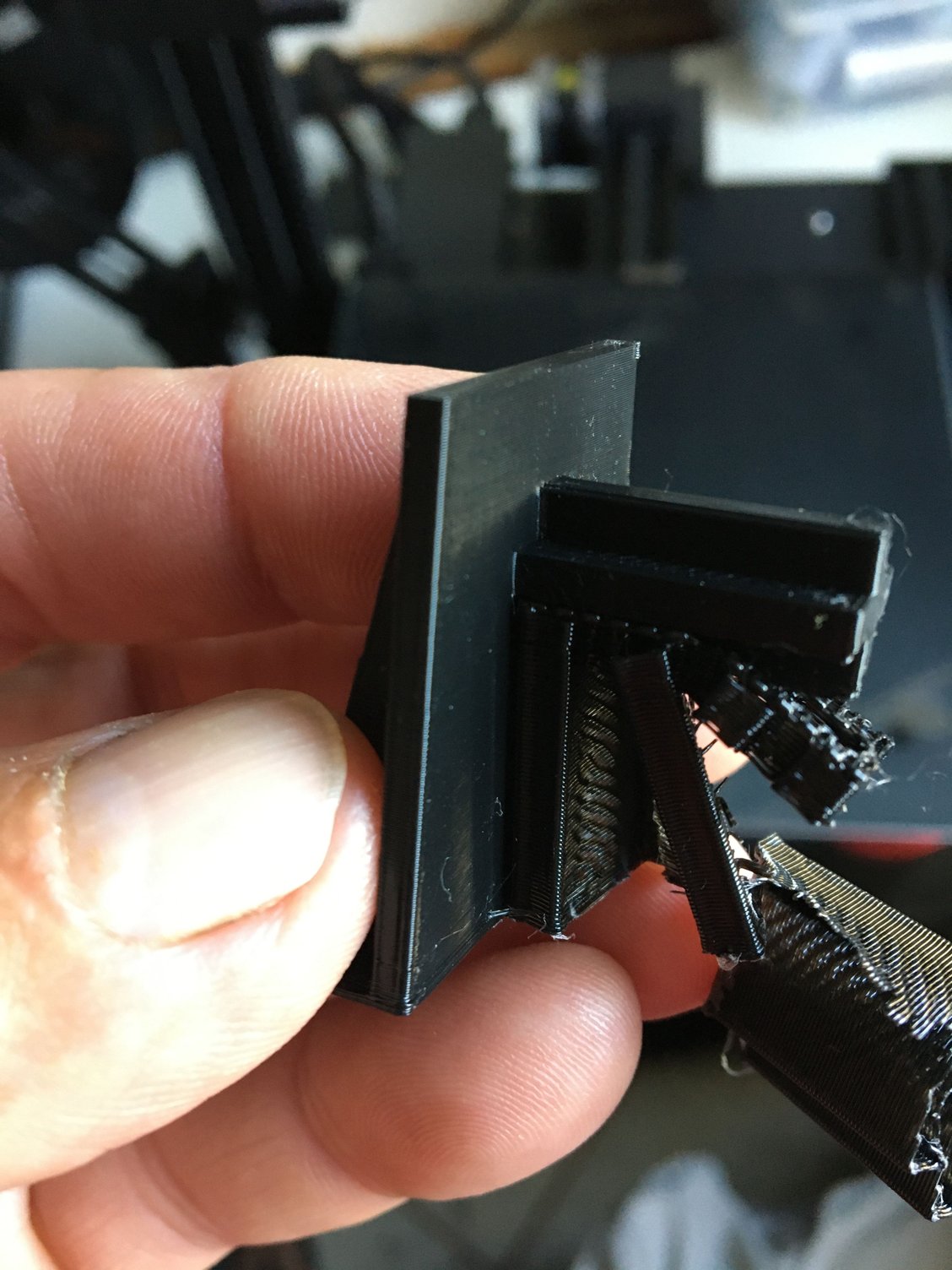

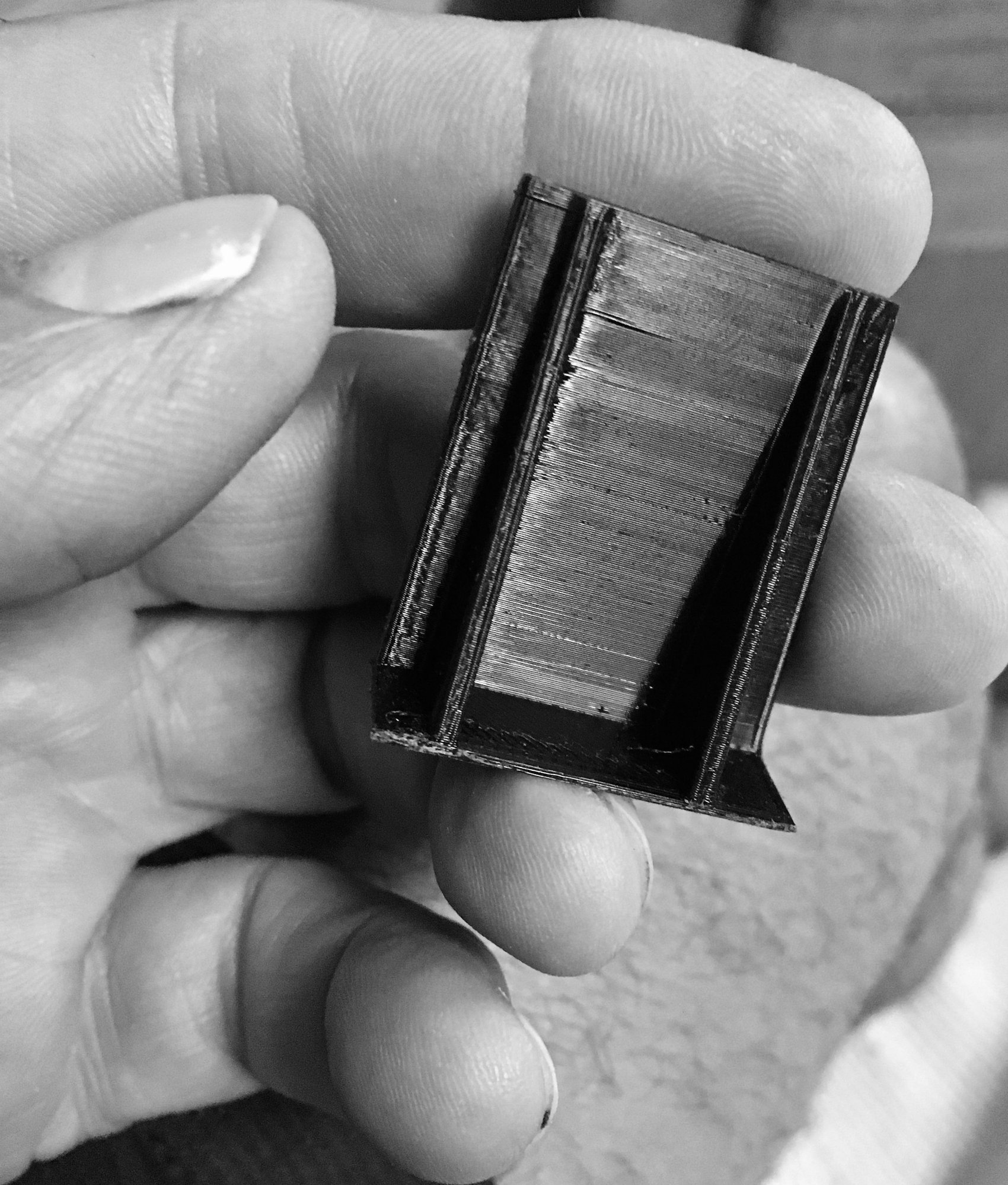

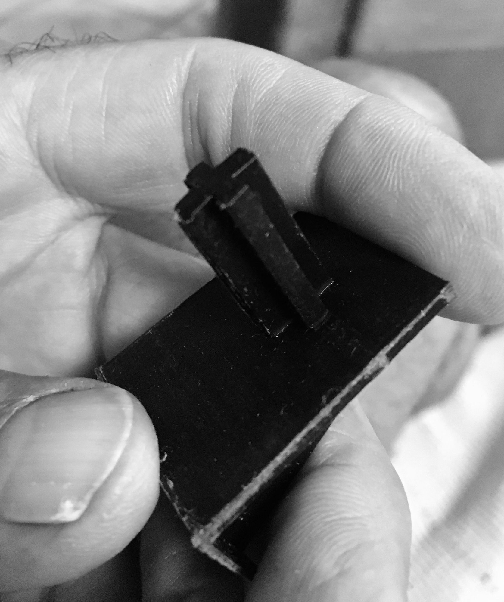

Default Supports
Made supports for the grill, no more gettho repairs. More 3d printing coming up.
Left it a bit proud for sanding to have a good mechanical bond.
Is identical to the factory piece
The back
They are called supports, do the floating part can stay up. If not you can build it in two pieces, but then you have to glue them together.
