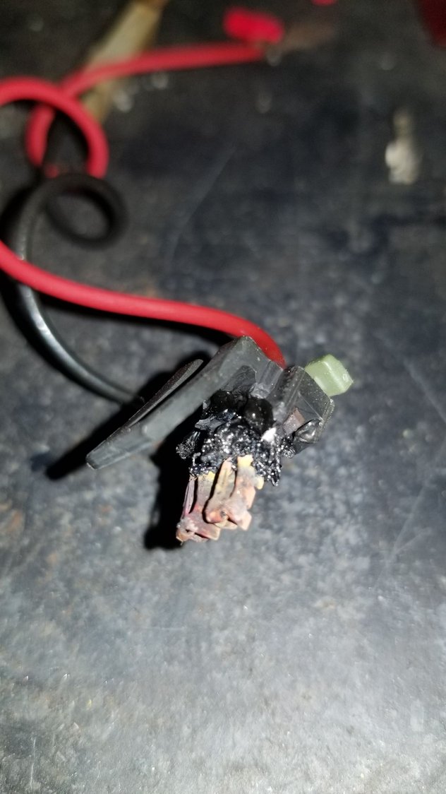

Replaced Fuel Pump last night / this morning.
Saw a bit of crispness.

Wow you are lucky it wasn't worse. I just replaced the little pump that is plugged into, I suggest anyone to replace the whole unit, it works fine but takes 2 tries to start in the morning, I assume a crack in one of the plastic hoses so that it doesn't stay primed, I need to replace the whole thing.
