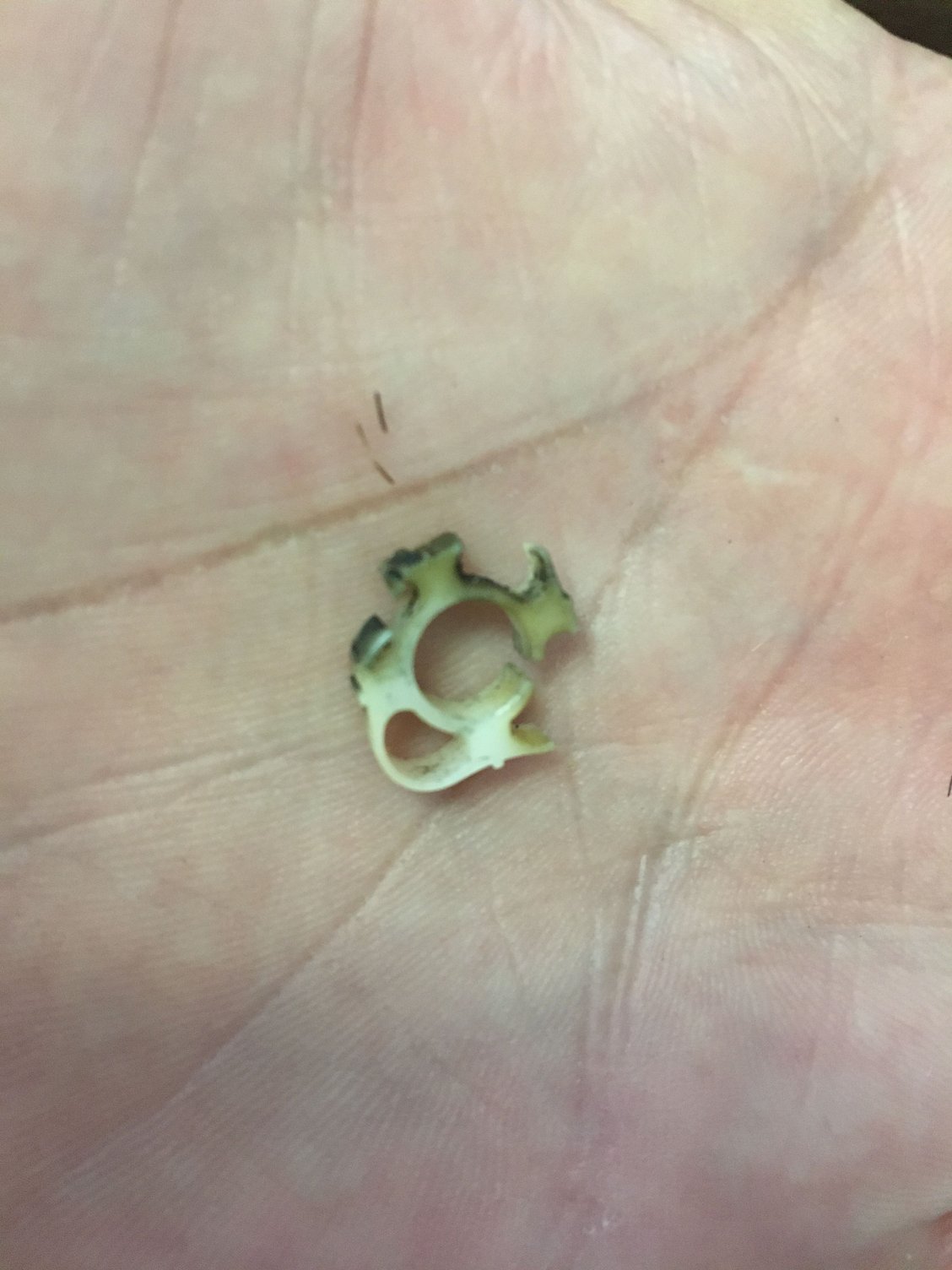

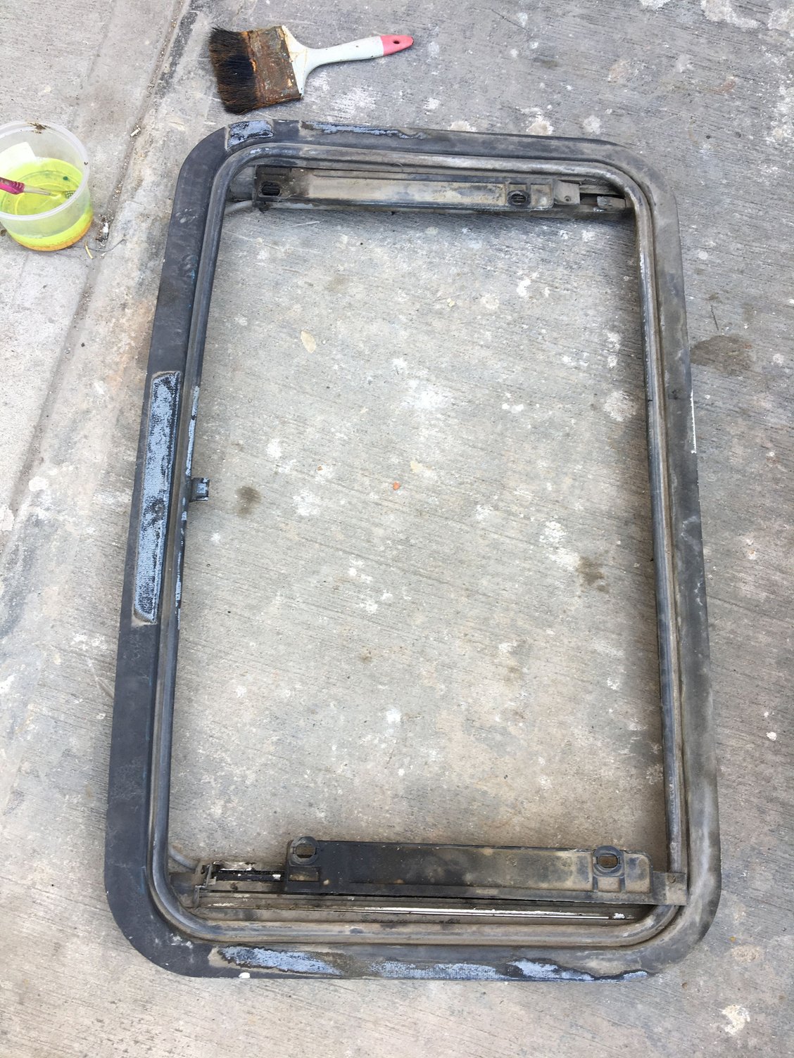

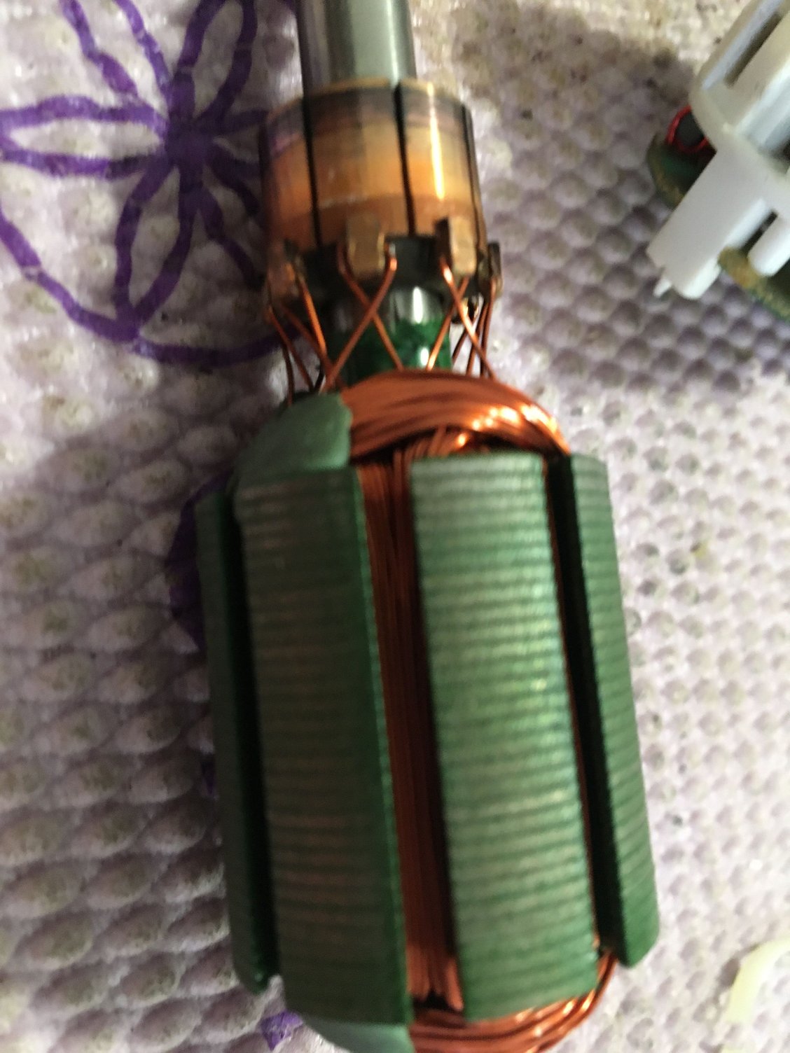

Well after two years, I finally got back to the the Disco 1. The rear sunroof leaks, because it was stock partially open. The motor tried to move, so I started there, plenty of rust brushes ok. Worked but the issue didn’t go away also you could clearly see that the left wasn’t moving(trying) like the right.

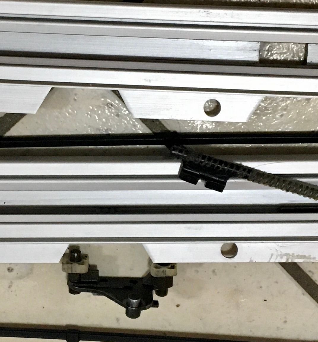

So I went down the rabbit hole, I had the liner out for repair anyway. The thing was caked with California desert dirt. The lines are clogged, but the issue is the worm cable.
After lots of cleaning, some pieces came out then I had to figure out how to take it apart, my first time ever. So I took apart the broken one first, then took my time on the other one since is in great shape. I needed to see what the broken part looks like.
So now I have to figure out how to make one and do something about the busted squares.
After the sunroof, abs delete, headliner. So the next few weeks should be Disco all the time.
Filthy motor
Now that looks awful
Need to make some of this, or similar
Detailing, after cleaning it glides before didn’t even move.
That little part,at the end is the key to all of this.

That little white slider is going to be a bitch to locate. You might want to take some measurements of a complete piece and find something like a window slider that will work.
just and example of what I mean...
Amazon Amazon
Old Aug 9, 2024 | 12:33 PM
  #4687
Moab63's Avatar
Joined: Nov 2022
Posts: 59
Likes: 15
From: San Diego, more or less
https://www.amazon.com/dp/B0BC96HXM7...WxfdGhlbWF0aWM
Thanks, I was thinking of something just like that. If not I’ll make some out of delrin, I know it has a bit of flex built into the design. But I’m guessing it won’t be necessary in the unobtanium part.

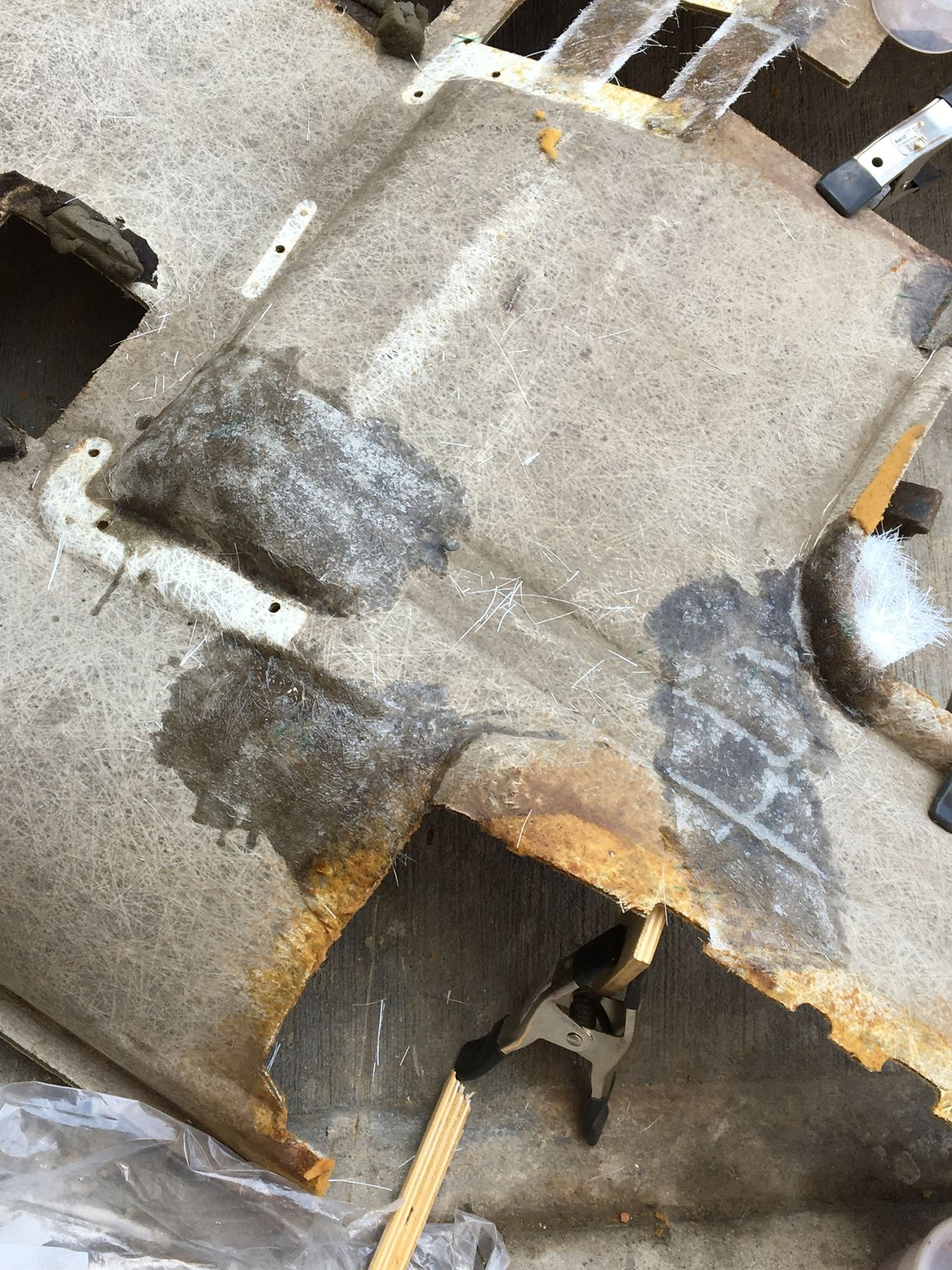

I started to repair the headliner, removal, cleaning and reinforcement with fiberglass.
The mess
Some fiberglass added
The cat

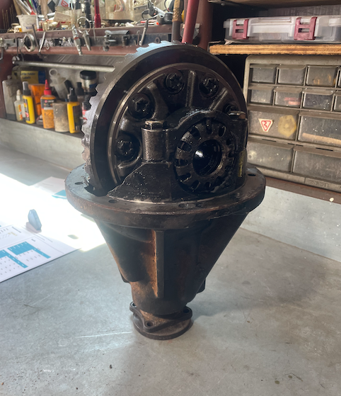

Swapped out the 3.54 diffs for ASHCROFT 3.75’s this week.
I’m running 267/70 16’s and wanted to get the shift points back to factory.
Last year on our trip to Colorado, Monarch Pass brought the Disco to her knees.
We pulled the axels out and left the calipers and rotors on. On the front, I removed the swivel housing bolts that bolt it to the axel housing and pulled them out, resting them on jack stands. The rear was simply a matter of removing the five flange bolts and pulling the axels out about a 12" or so.
I’ve done a couple days driving around the hill country here in Austin, TX and
I have to say I’m very happy with there results.
She seems to kick down now when I put my foot in it and climbed the hills without losing MPH.
Have to give a shoutout to Eric and Lucky8. I got the bearing/seal kit as well as the Ashcroft shim kit from them.
All in all not too bad a job to do.
Painted up - happy with the pattern
rear diff was MUCH easier to remove than the front.
