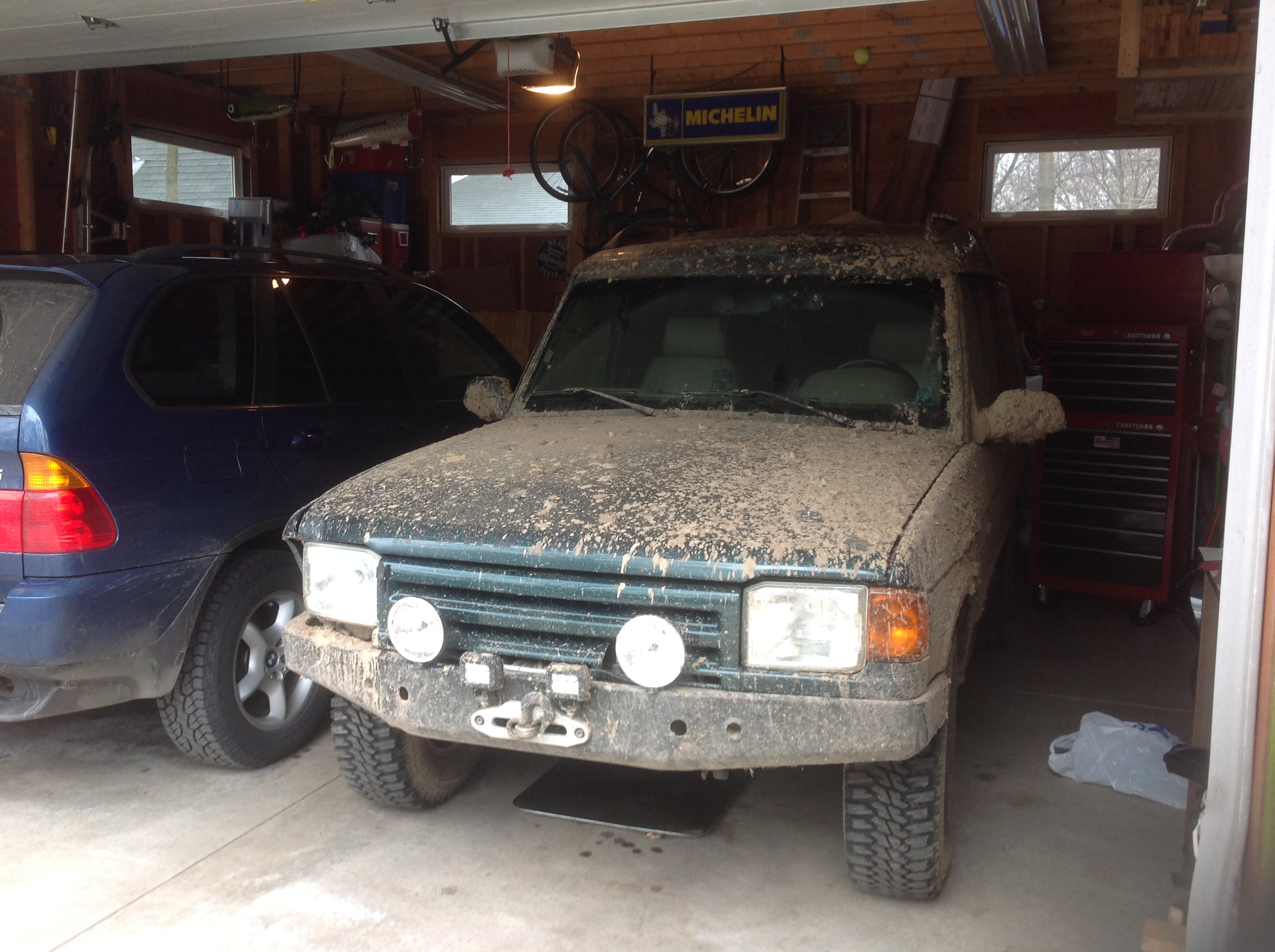

Last weekend I took the ol girl a few hours north and tromped her through the woods. Only had to lock the t-case twice. That things a tank. I tried but couldn't get stuck. Only had two issues in four days of abuse, front left lug nuts came loose. No damage easy fix and after getting out of a particularly nasty spot, brake pedal went to the floor. It would hold pressure after a few pumps but in a few minutes went to the floor. No leaks, no fluid loss, passed visual inspection...I drove a few miles back to the cabin and pumped the brakes with the truck off till the pedal was so firm it barely moved. Again no leaks. And no issue since. 200 miles back home then to work today still working fine.

When was the last time you replace the brake fluid? I had a failure after coming down Pikes Peak, water gets sucked in and when it gets hot becomes steam and only the e-brake saved an accident. replaced the bleeds because they were rusted from the water condensing. Cheap fix if you were heating up the brakes.

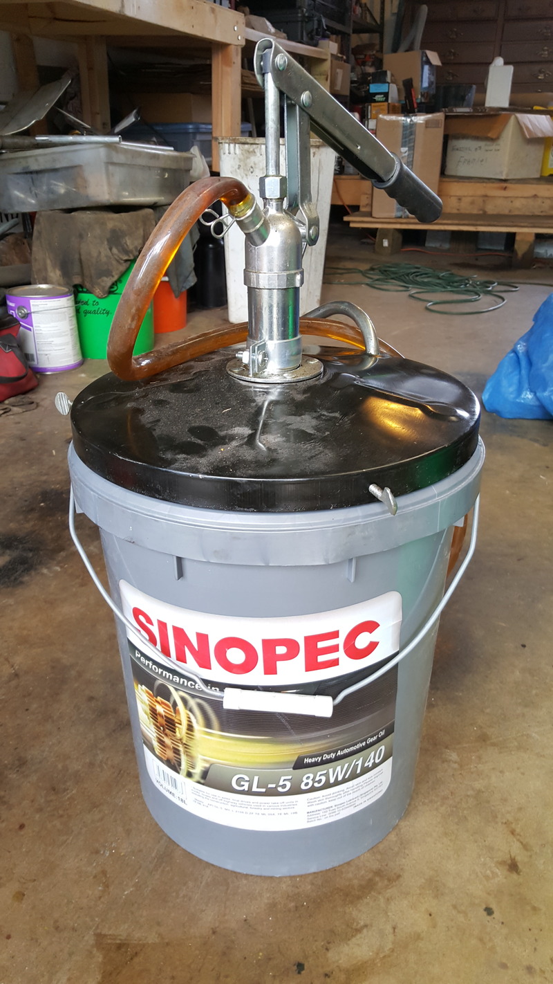

Received 5 gallons of sticky, smelly goodness from Amazon.
So I changed the front diff and Transfercase oils.
Also jumped on the Amazon Subscribe and Save for 2 gallons of Rotella 15W-40 every 3 months. Works out to about $11.50/gallon, the cheapest I've seen.
