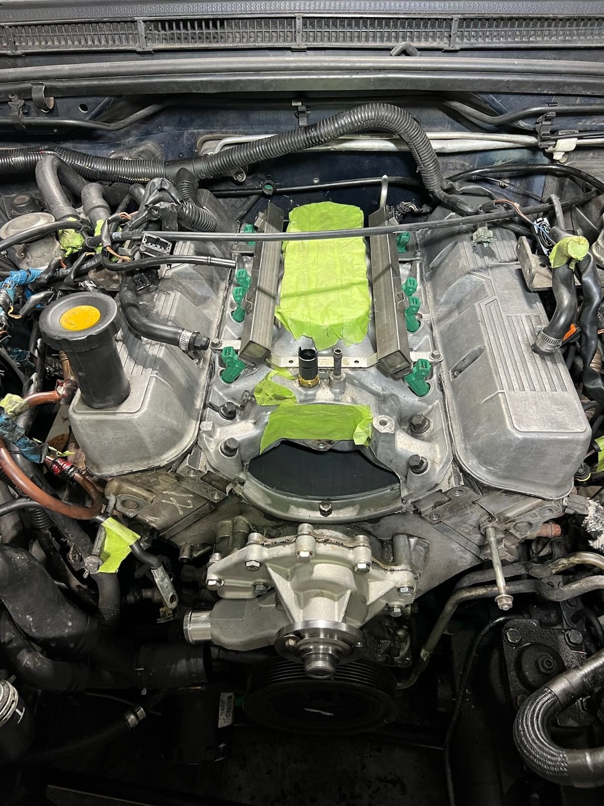

Greetings, can someone help me understand how to replace the the two intake inlets on in the upper intake one for the PVC and the other the brake servo line. I ordered the two from Atlantic British both are broken.
PVC appears to have thread to screw in but the other one for the brake servo line I have no idea how to get it out to put the new one. I am rebuilding some things, mew injectors, new valley gasket intake gaskets, water pump, new power packs relocated and cables. Starting to put all of it together fixing the intake now. Need help with this question.

Punch the servo connector out through inside of the intake with a long 3/8 drive extension.
