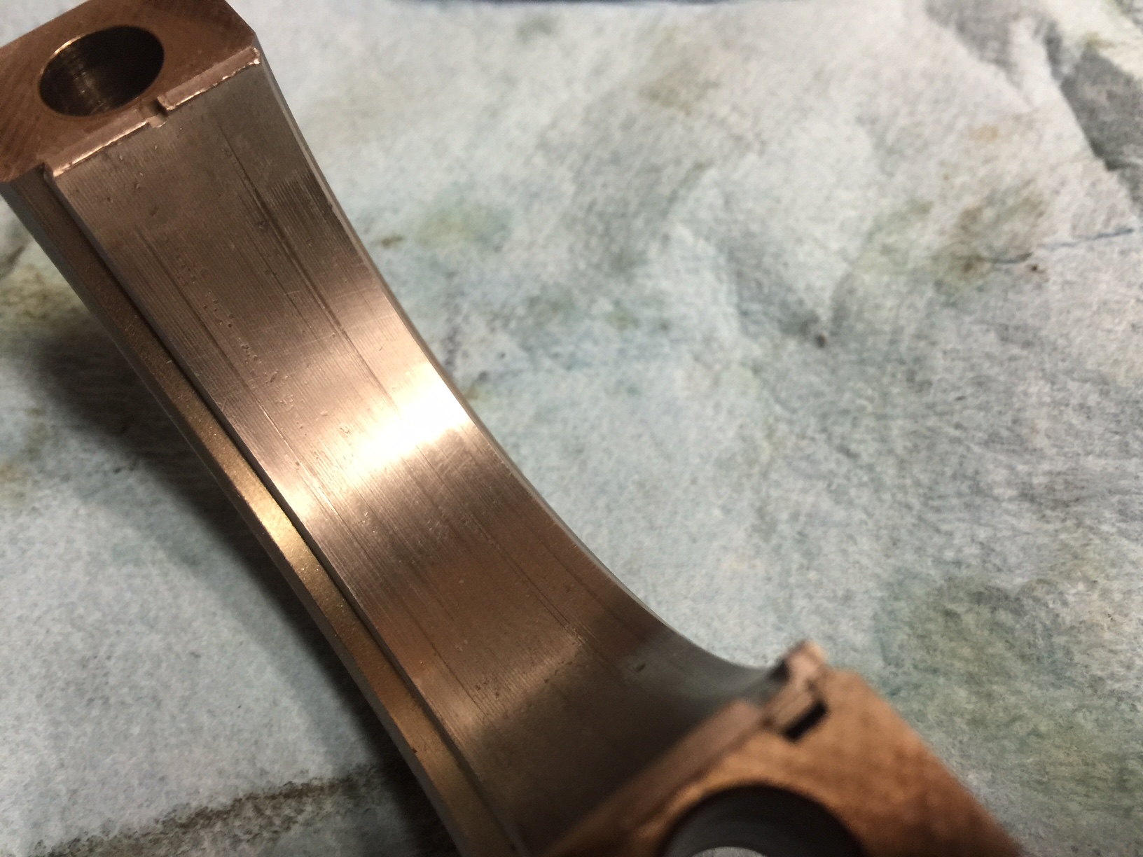

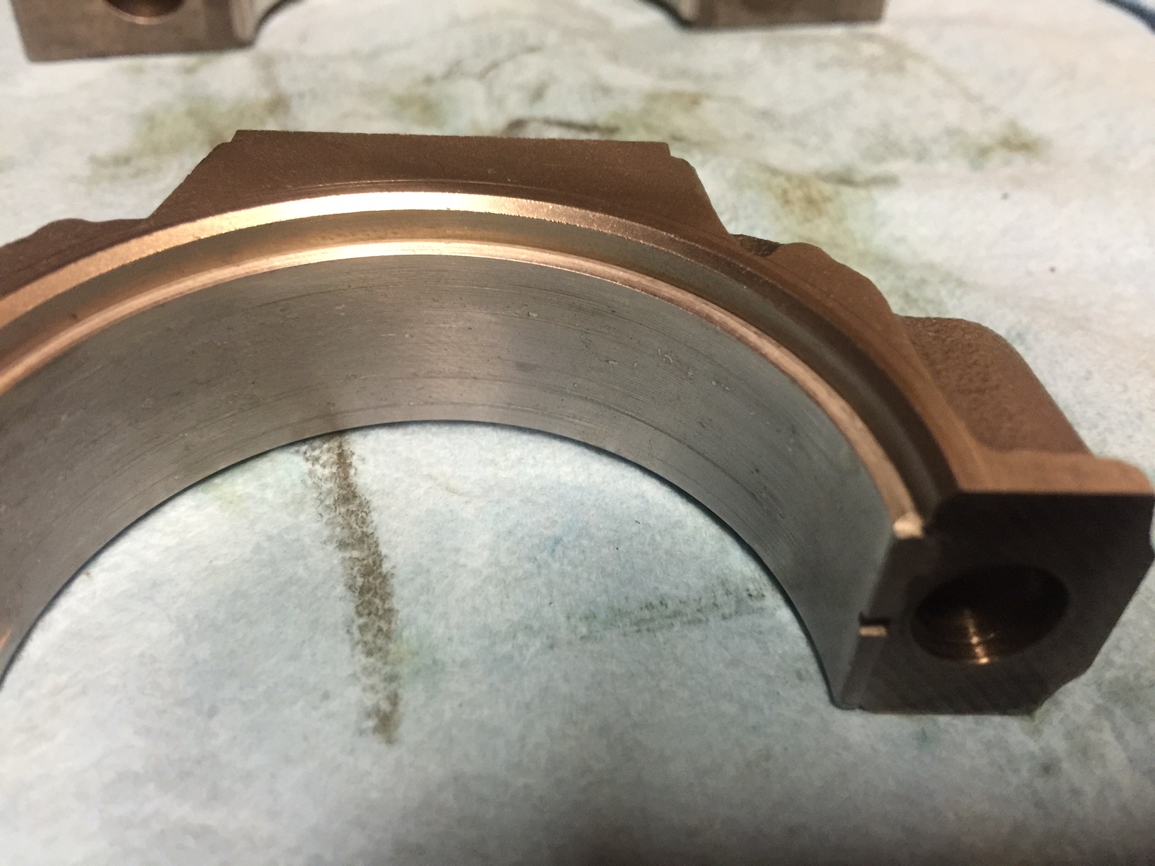

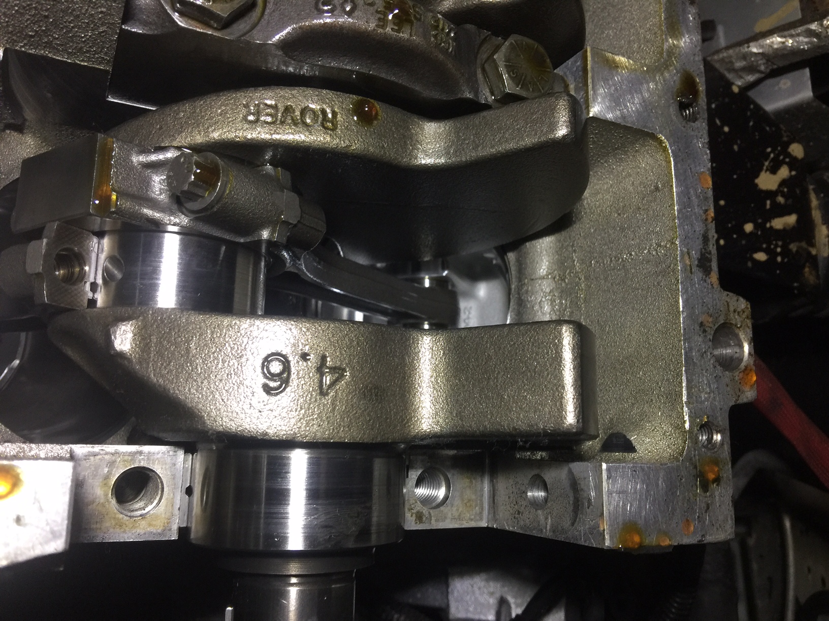

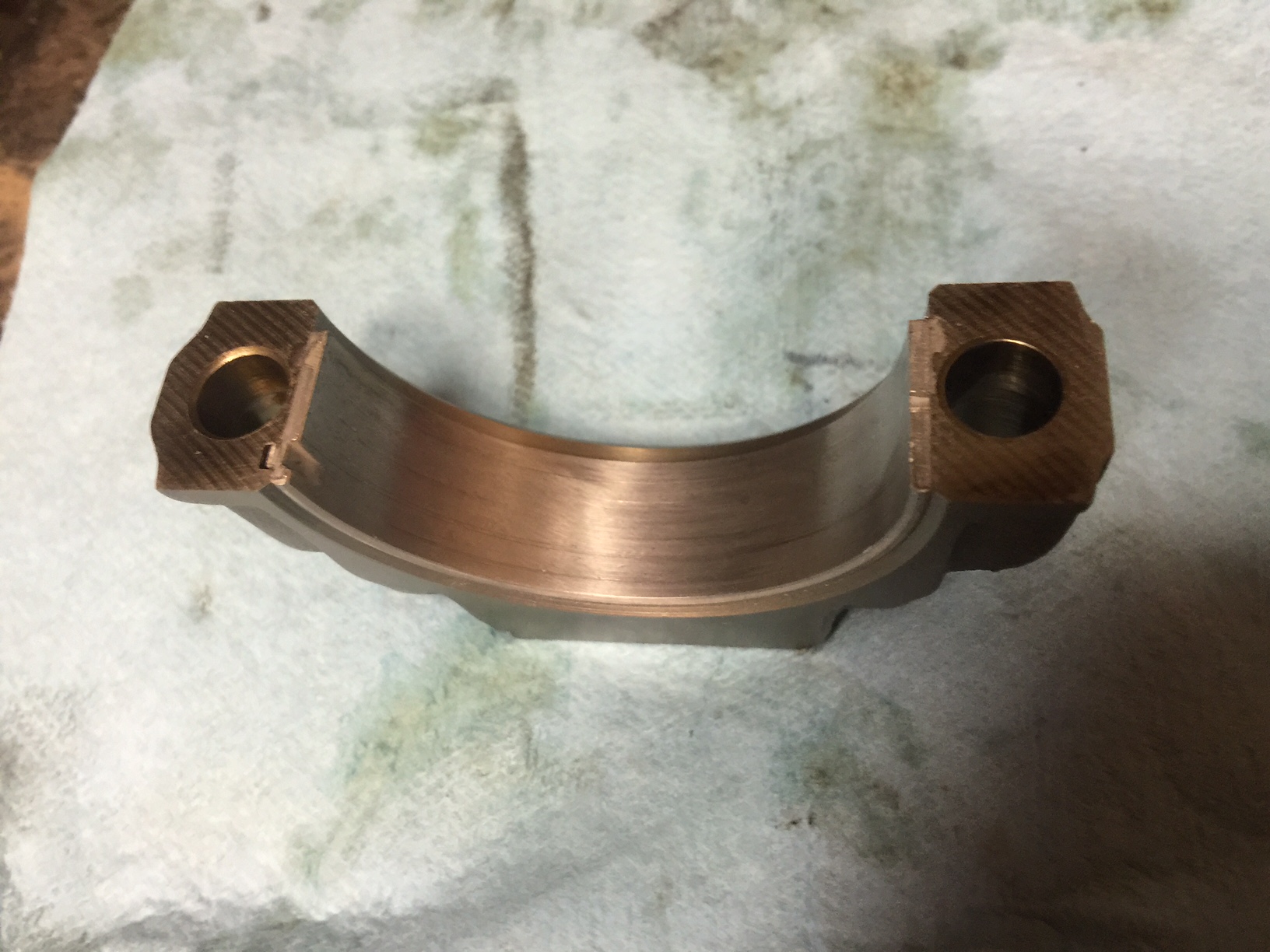

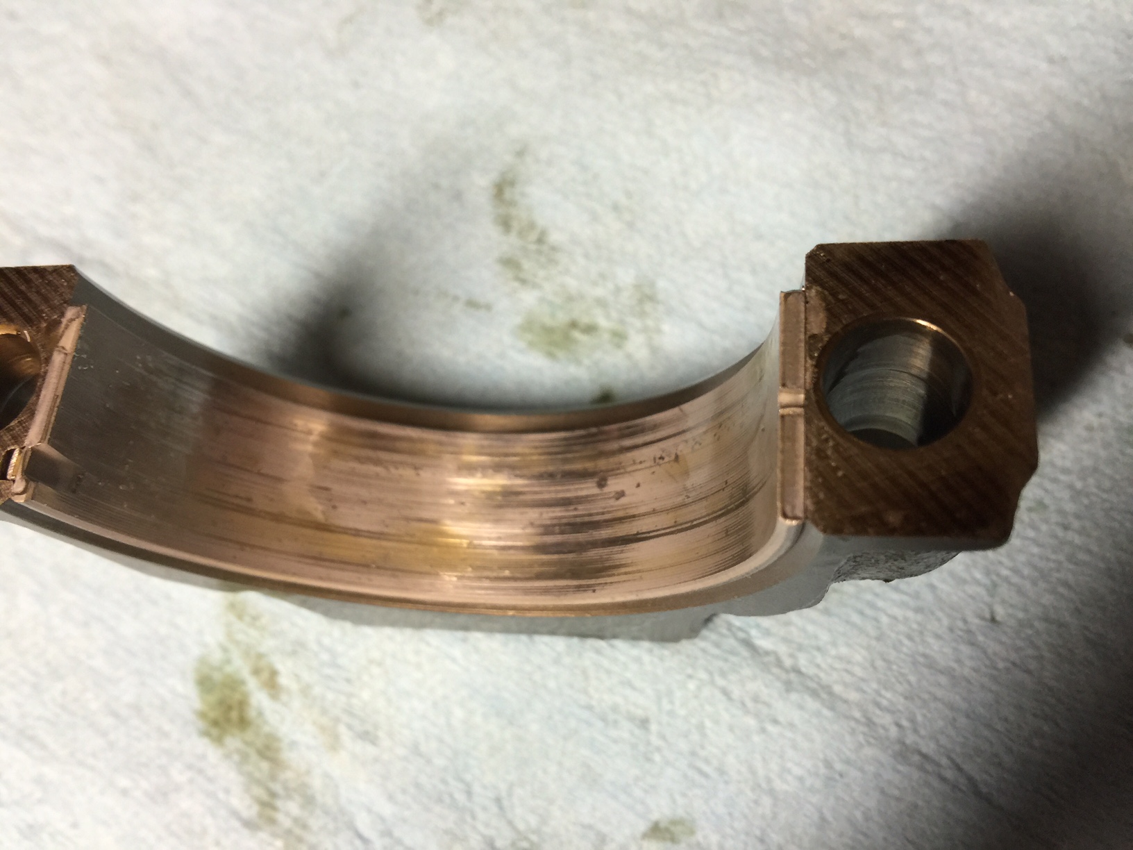

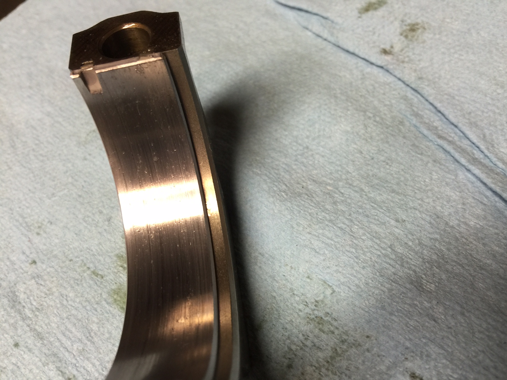

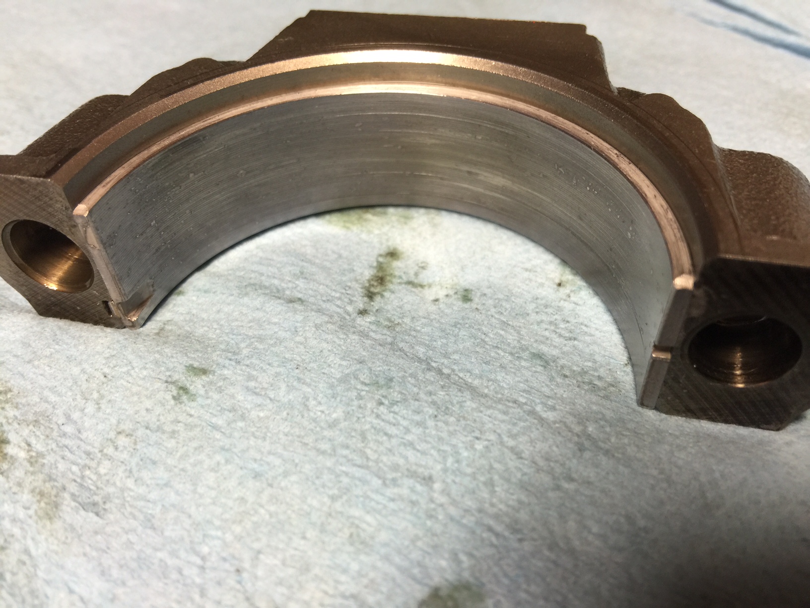

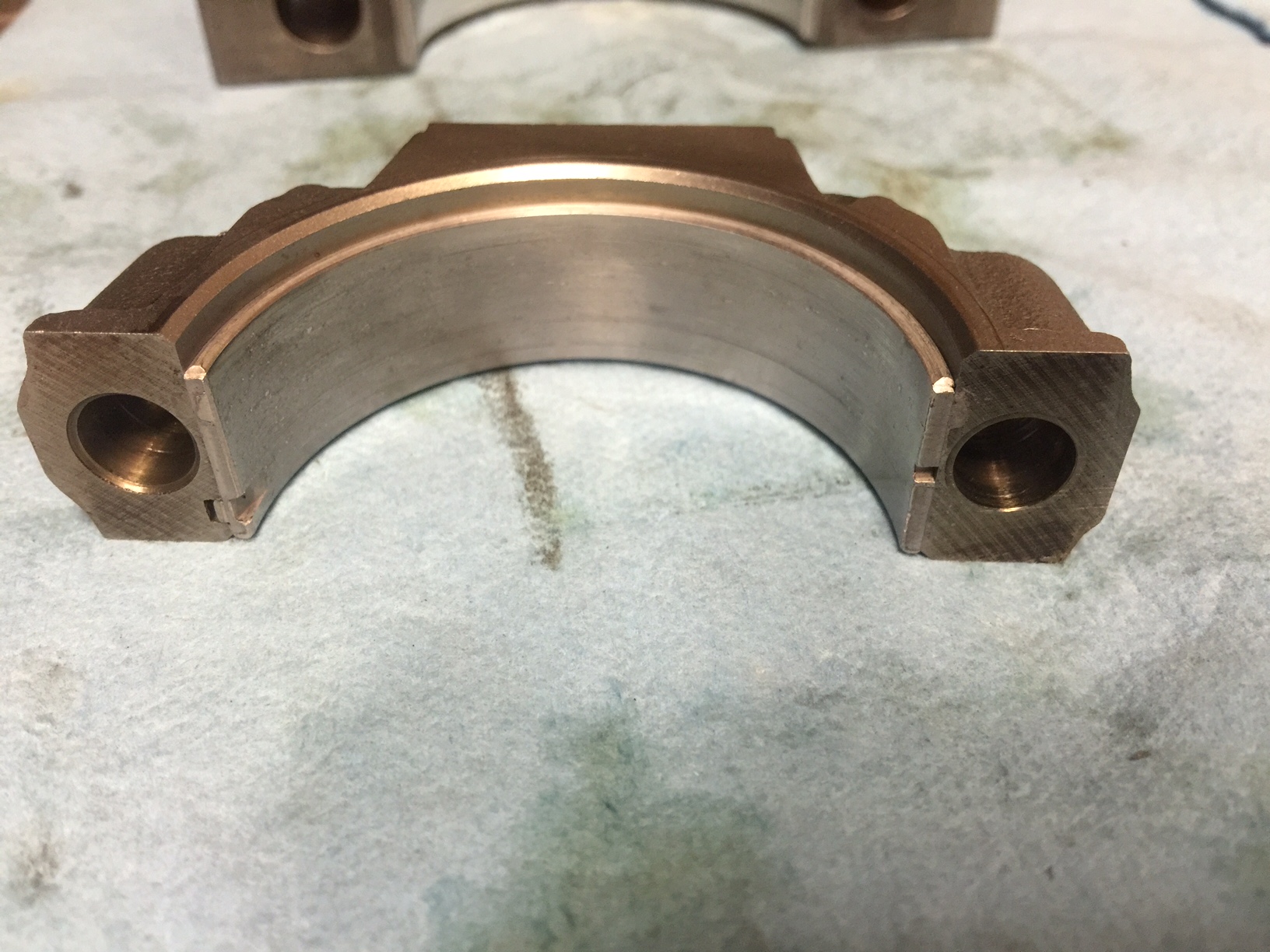

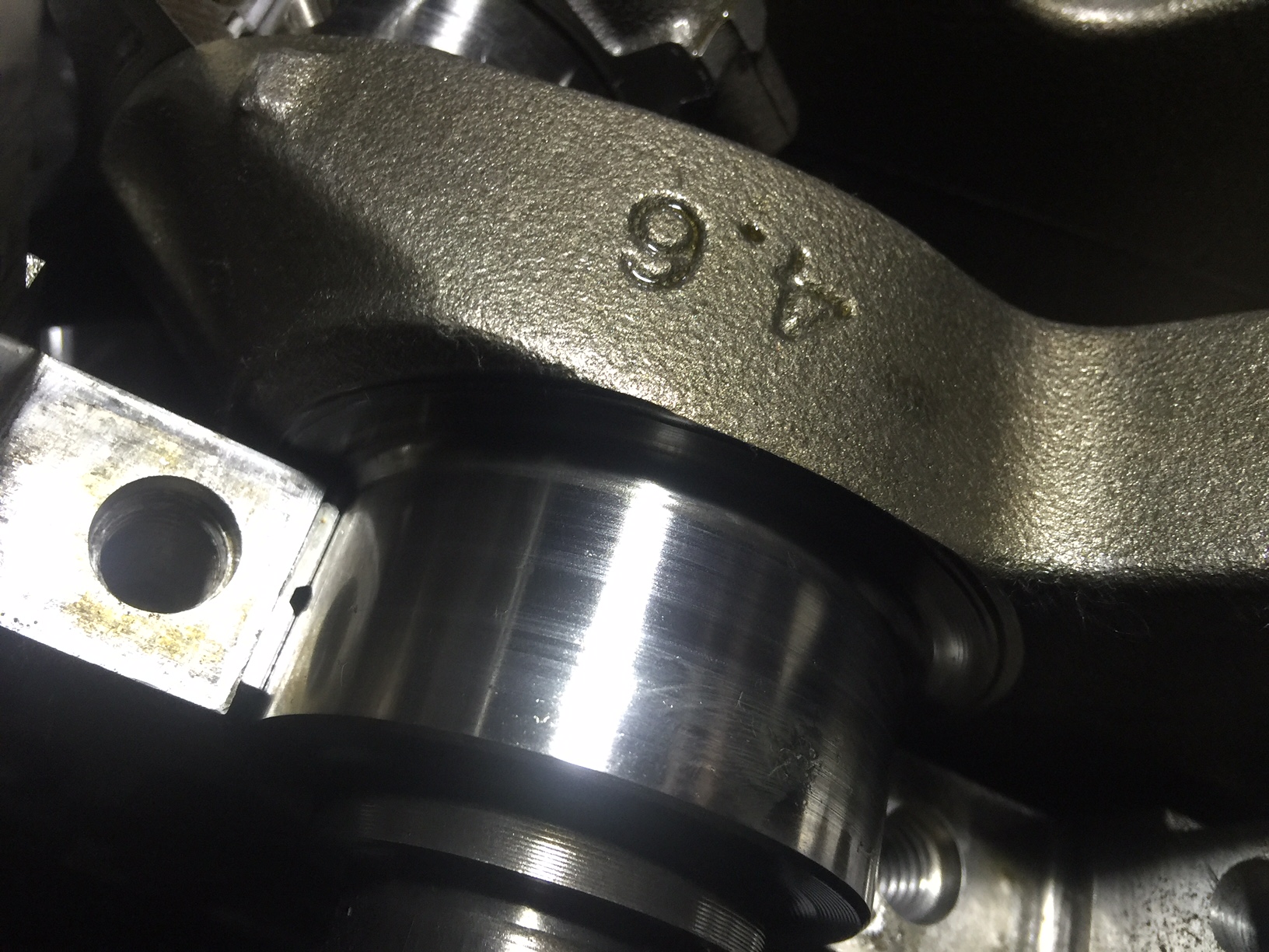

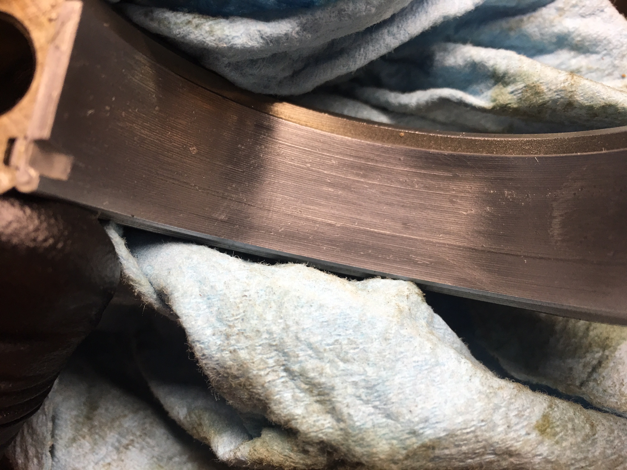

The exploration into the bottom end of the engine has uncovered some very alarming details as to the care and attention taken by CannibalV8 during their assembly & inspection process!! The attached photos show:
• Obvious wear/damage to the crank & bearings due to the crank not being machined true.
• Pitting to the bearings reflecting dirt or contamination was present and not cleaned off of the crank or bearing surfaces when the bearings were installed.
• Even though there is only just a bit more than 1000 miles on the engine since the build was complete, there’s obvious scoring damage to the crank & bearings as a result of the metal floating in the engine caused by the low oil pressure.
Steve’s initial response to the photos was, and I quote, “The Alloy Layer on the Mains, are engineered to absorb”, a promise to begin shipping parts on the 16th, followed by insults as to the ability to diagnose or identify damage to an engine towards the shop working on my Disco, and the number of Land Rover Certified specialists they solicited to offer a second opinion, and now another 7 days of silence.

OMG and then "engineered to absorb"! I've seen less main damage than that on an oil starved pilot engine that ran for 6k!
