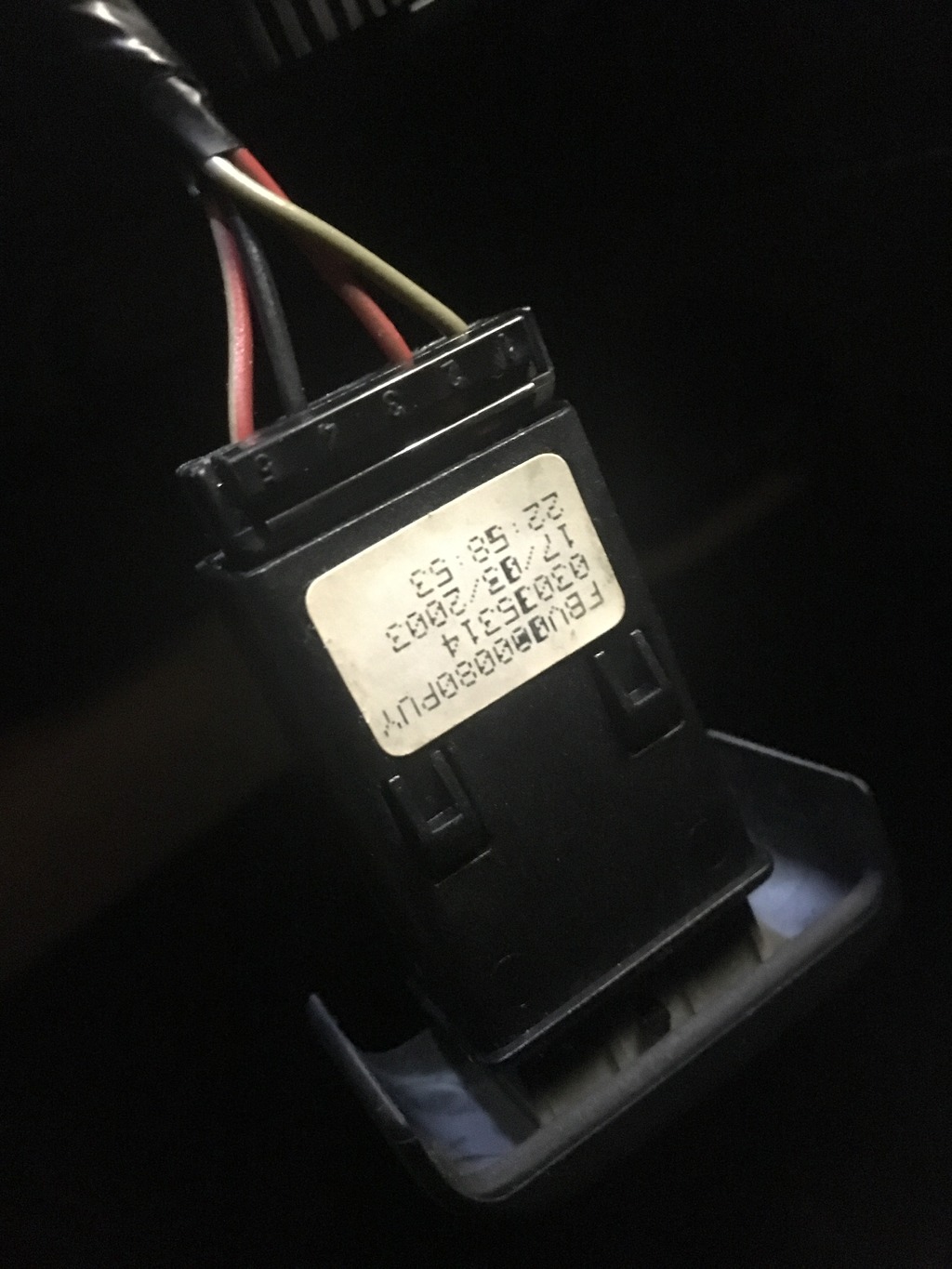

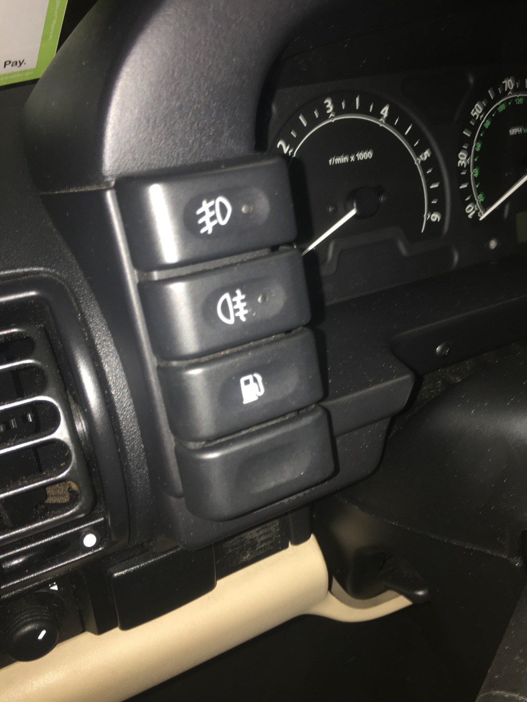

On both sides of the dash, left and right of the steering wheel, there are two switches that do not seem to do anything.
The passenger side switch is a true blank. If you pull the switch out, it is not wire to anything.

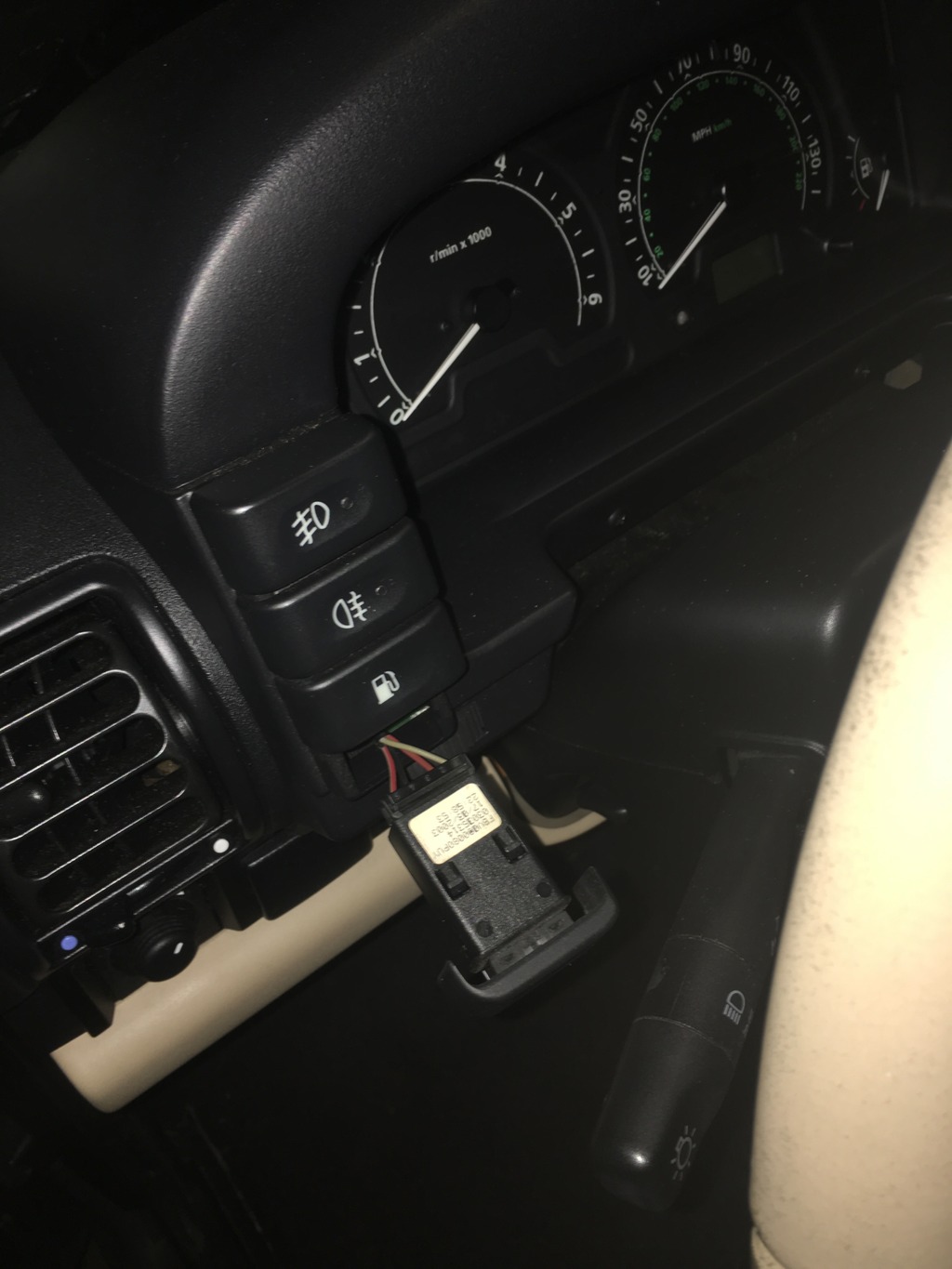

The driver side switch has nothing on the switch cover ( like the gas door, fog lamps and cruise ) and it does not push in and out like the other switches.
However, if I pull the switch, it's wired.
It has one black, two red, and one sort of yellowish wire.
What is this wired for?

there are plugs behind the dash switches, for several options. LR prewires for all options, whether installed or not. In many cases the option can be added, but before they become operational, the BCU has to be programmed for them and the correct relay has to be installed in the correct slot on the fuse box. Heated windscreen for example.

Duh....just looked in the Rover glove box manual. It is the park assist option.

I believe those switches are turned on in the BCU as they are not latching switches. So it would not be possible to use them for accessories.
