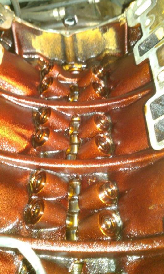

As for gunked up, kerosene, BG Products, Marvel Mystery Oil, Sea Foam, and a host of other solvents also clean out gunk, some a little faster than others. But if we run a decent oil and don't go by the hogwash of the owner manual, written by the marketting department, we'd be better off. They base it on miles. As a competitor, they want higher miles than Brand X. So 7500 miles became a standard. But 7500 miles of highway driving is a lot different than 7500 miles in stop and go Mom's Taxi Service, with extended idle at school pickup, drive thru, bank, soccer practice, ballet lessons, horse back ridding lessons, etc. Here's a pix posted by one member, at about 50,000 miles, dealer oil change intervals. Like that nice Colonel Sanders Extra Crispy I believe.
