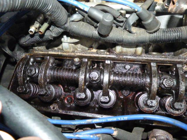

I thought the bypass valve did just that, bypass the filter media depending on pressure drop, blockage, etc. So a dirty filter won't stop oil flow, it just stops the filter process. The bypass valve also operates at WOT accelerations, racing, etc. I think a filter that is clogged AND has a stuck valve would starve the oil.
So with a Mobile1 filter run until clogged, or any other brand, continues to flow unfiltered oil. But with the price you paid for the Mobile 1 and the synthetic oil you keep driving for another 15,000 miles with no filter....
Good quality filter and oil, and change early and often like voting in Chicago. Rover says under certain arduous conditions oil may have to be changed daily. Sounds like fun to me!
Exactly how does a bypass valve work? - Bob Is The Oil Guy
Pix of arduous conditions and results of poor oil change habits combined with blocked PCV system.
Fuel for thought - does a high cleaning oil Like Rottela, in an older engine, remove so much sludge that the filter media becomes clogged early and the filter stays in bypass mode?
