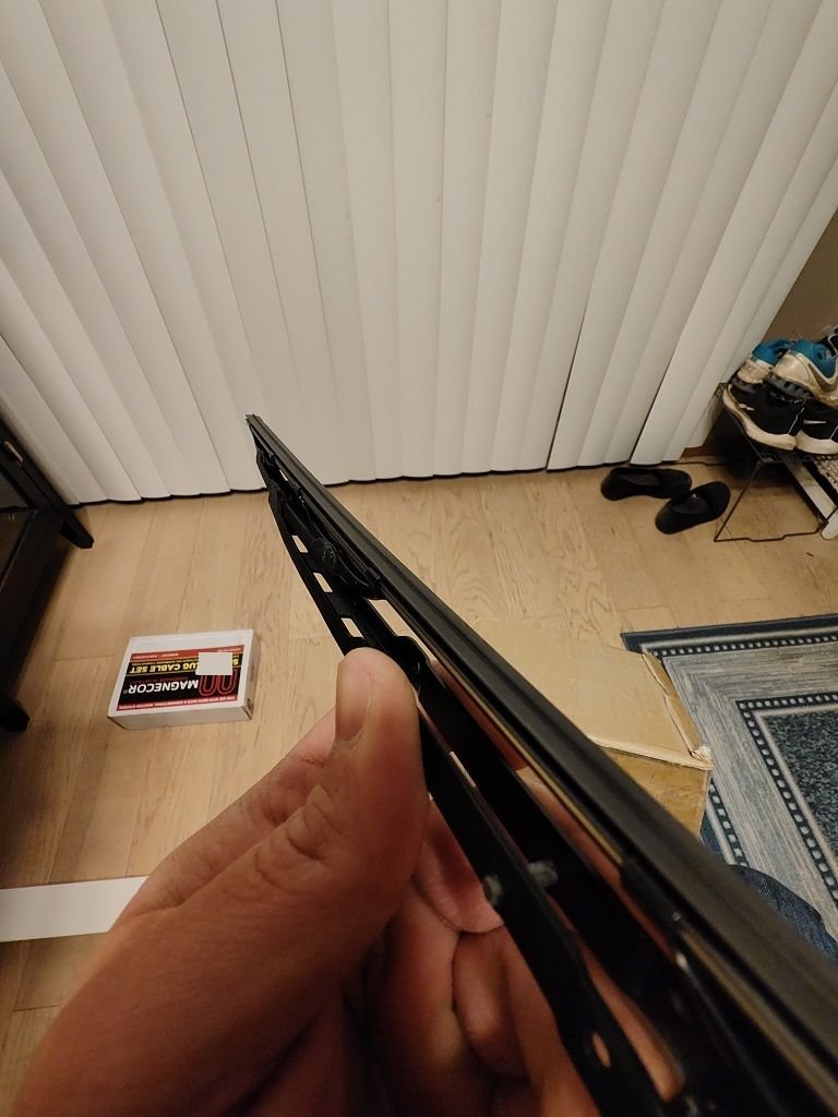

On a side note, I also ordered two new Genuine front windshield wiper blades (rear wiper is NLA). What's missing?
