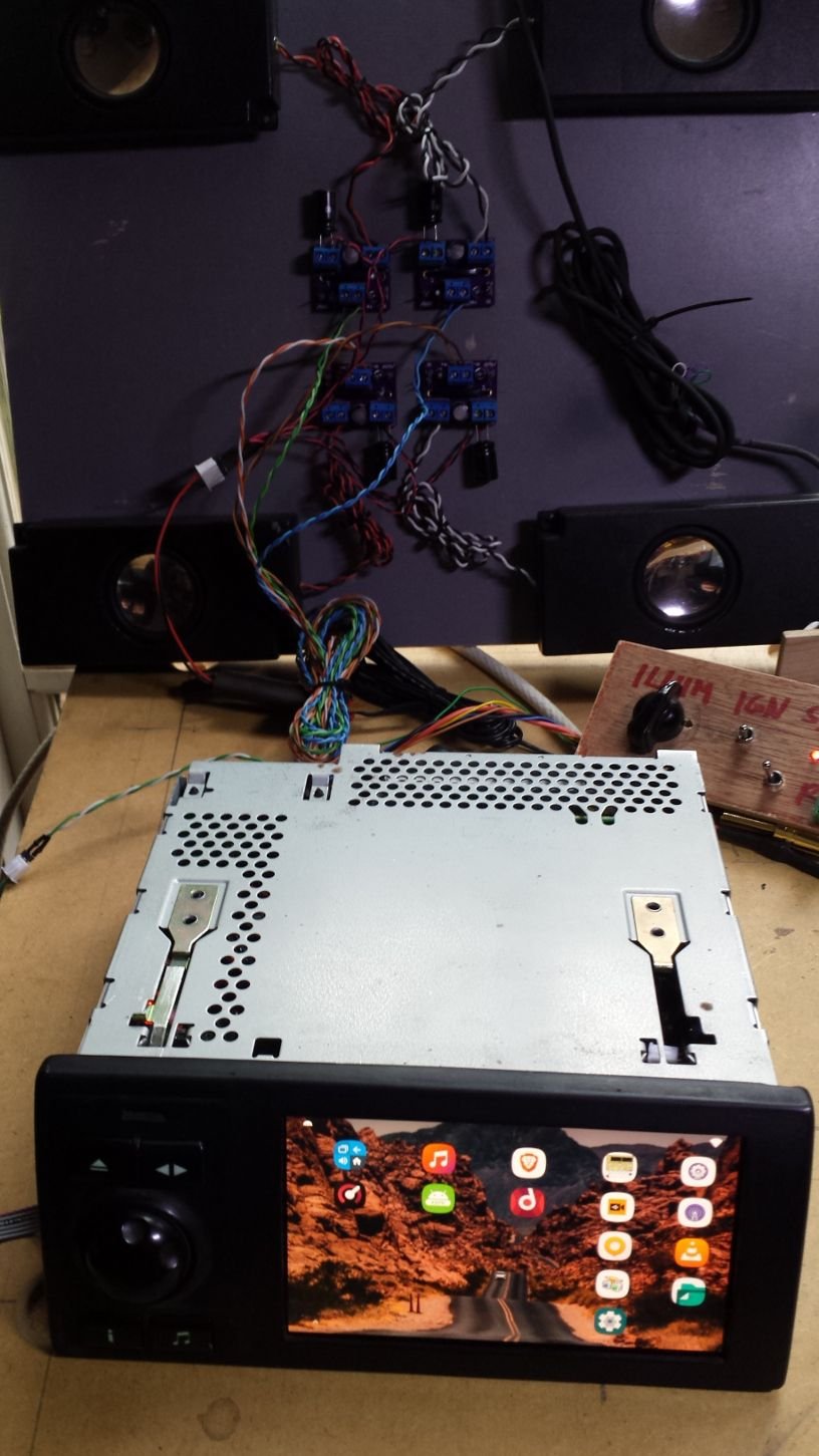

The first prototype is almost done. All the original dials are working as well as the features of course (see the pictures). I still need to program a few small things like timers. As soon I have time I will install it into the Land Rover and I will post a video.
The modified Alpine stereo sitting on my test bench to test things like speakers, ignition, reverse indication aso.

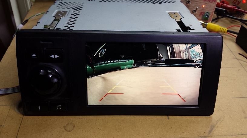

Backup camera (camera sitting on the table), turns on when Reverse is selected (the "R" switch in the background simulates it).

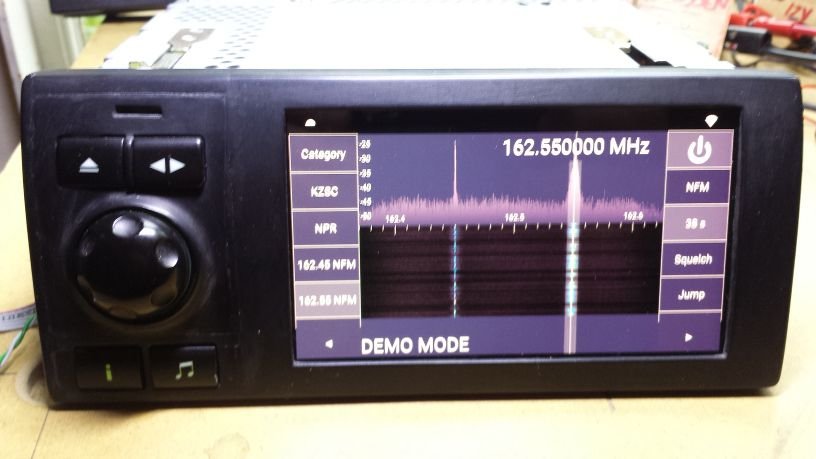

Radio receiver, listening to NOAA weather channel.
