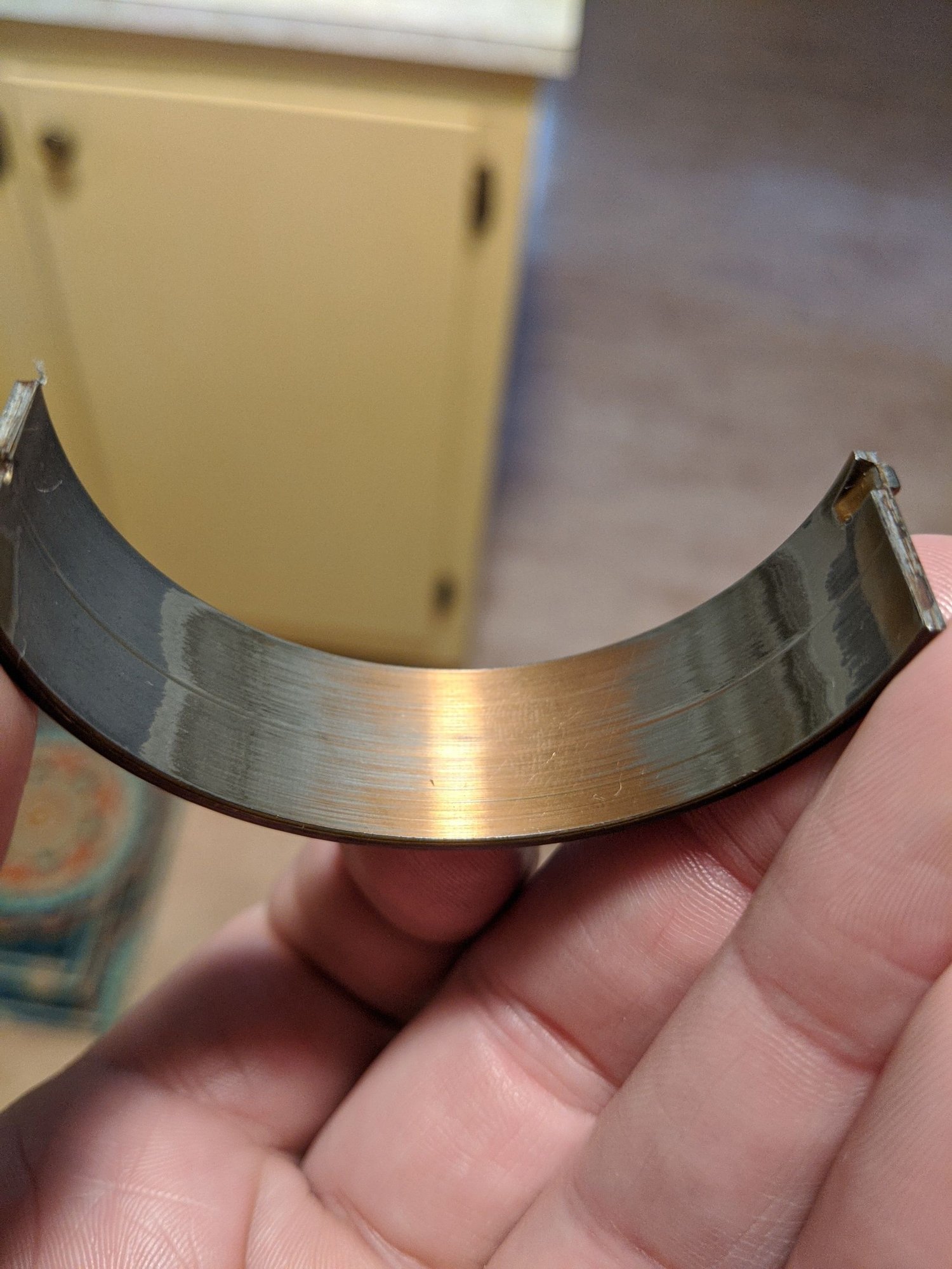

Default Low end knock at idle
Persistent knock hot or cold below 2000 rpm, changed the rod bearings, oil pump and timing kit. Knock has gone away 100%.

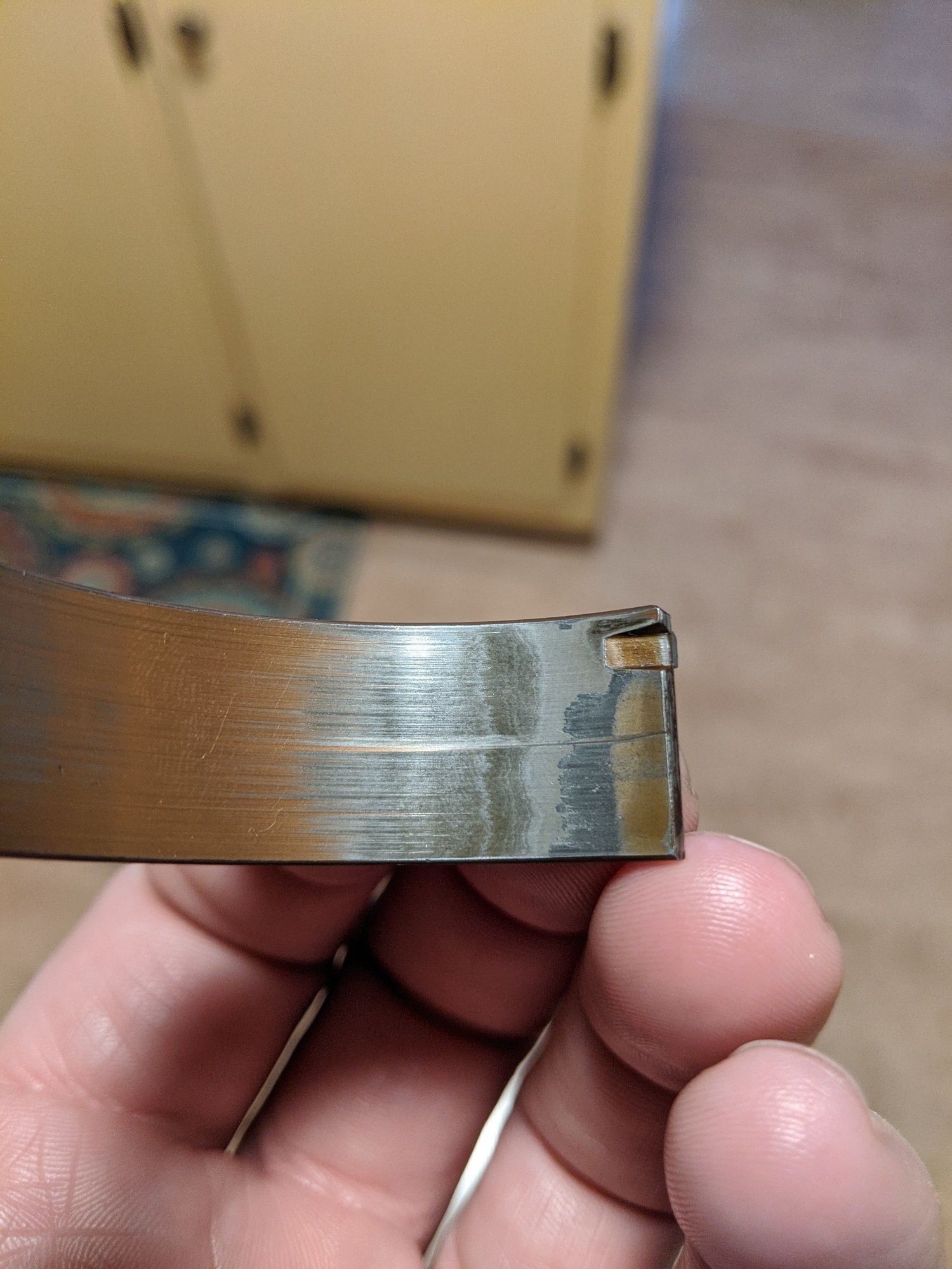

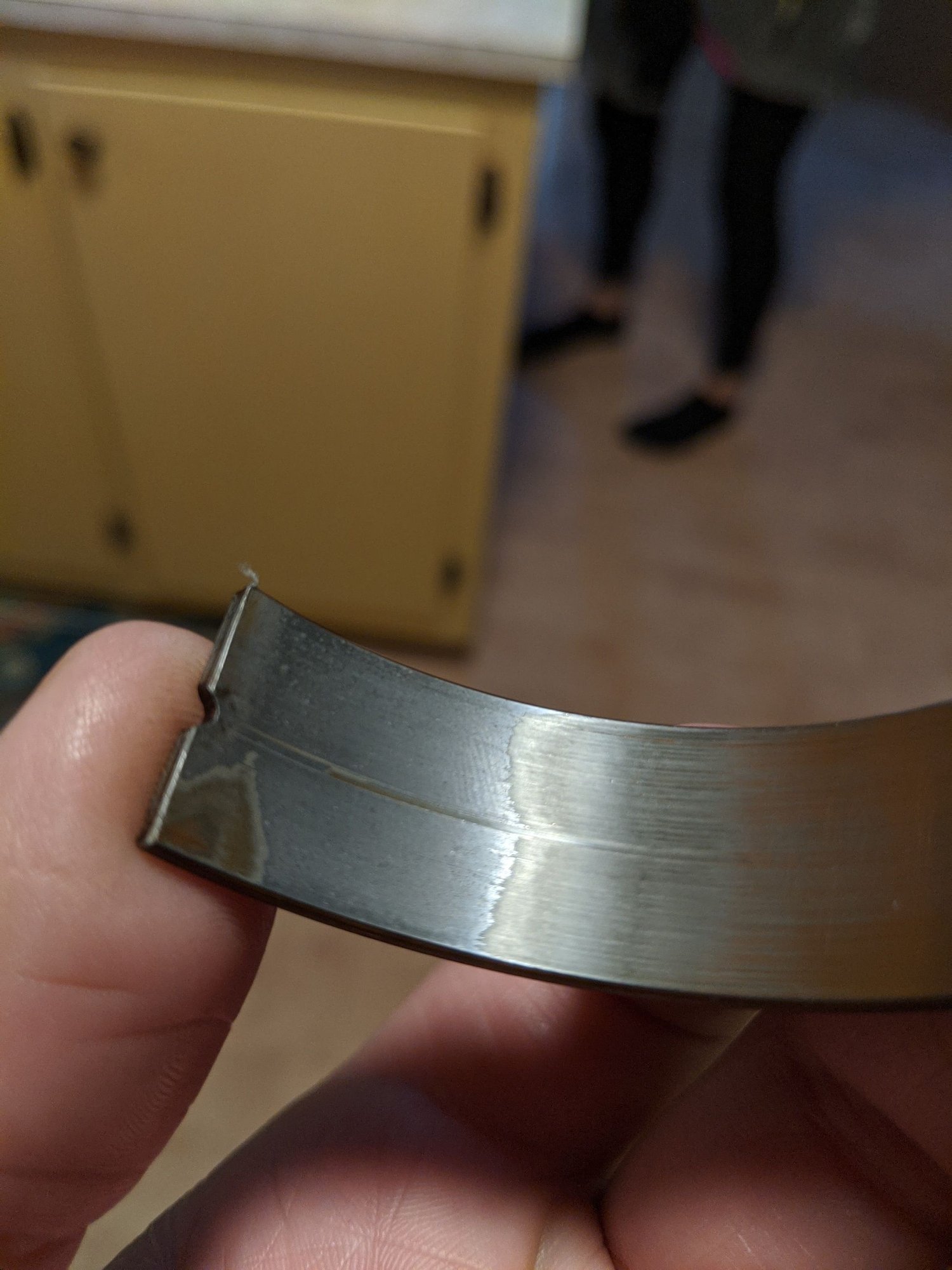

Originally Posted by redwhitekat
nice work
what was the actual problem? Bearings ?
Oh yeah, bearings were well past it. Timing chain was ridiculously slack, but the oil pump looked great. Had the new one already, so I threw that in too with lots of Permatex Ultraslick red and petrolatum. But the bearings- yes, they were knocking for sure.
No babbit, looks like copper. Saw copper- like flakes in last oil change.
You could feel the lip where the white soft metal remained.
Every bearing looked like these did. Wish I had the time to do mains while I was in there.
Rhys L.
