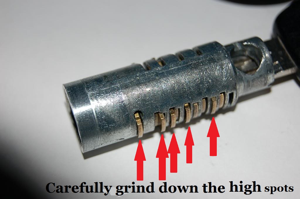

Did this start after you forced your key out or into the ignition? It sounds like your problem is in the ignition switch if the key won't turn back on it's on. That doesn't mean that your starter or flywheel haven't been damaged because of that now.
There is a great thread on here with pictures on how to fix a sticking ignition. I used this thread and haven't had any problems with my key sticking since. The ridges in our key wear down and the tumblers in the ignition are no longer perfectly level when the key is inserted. To fix this you basically pull the ignition out, stick your current key in it, then carefully take a dremel with a grinding wheel and grind down the tumblers until they are level again.
HERE THE LINK TO THE THREAD-https://landroverforums.com/forum/di...ock-fix-35422/
If you think you broke teeth on your flex plate/flywheel then there's a way you can check that. There is a small circular metal inspection cover on the bottom of the bell housing about 3in diameter that is held on by 3 small (8 or 10mm) bolts. If you remove that cover you might be able to feel inside the bottom of the bell housing for any metal chunks is something broke up in there.
