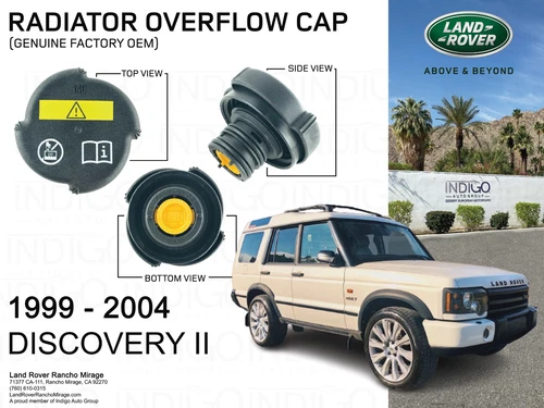

Good day all.
Scratching my head... Need your knowledge.
The 2000 cap goes deep and has 2 orings.
2000; overflow has a slit; radiator top hose has a 2mm hole in the wall of the reservoir where the cap fits..
Above, 2000; overflow has a slit for it in the innerwall; radiator top hose has a 2mm hole in the innerwall of the reservoir where the cap fits..
The 2003 It is not like this, does not have the long center with 2 orings
1999-2004 Discovery II Radiator Coolant Overflow Tank Cap PCD000070-D2 - Picture 1 of 2
This below is what I have in the 2003 :
The 2003 cap is shallow, there is no slit for the overflow in the innerwall of the reservoir.
Cannot tell if the '2003' cap is broken missing a portion or belongs to another year or two types of caps/reservoirs. Exteriors are identical.
Is there reasons other than blown head gasket for the coolant not pressurizing ? (2003 - No drips, no oil lever rise) Have an extra 2000 coolant reservoir cap for diagnosing but is different than the 2003. Interchangeable ?
Someone installed a wrong year cap ? What is the last cap image for ?
Help !

That short cap = doesn't look OEM. All D2 & P38's had the long center reservoir cap.
Old Oct 13, 2025 | 03:13 PM
evil_goat's Avatar
Posts: 278
Likes: 64
From: Virginia
Agreed. My 2004 has the same cap with the two o rings.
